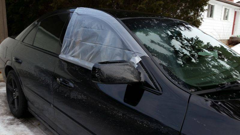

Just read this again and now I'm stuck. I got the old regulator out, removed the motor and installed it on the new regulator. I bolted the new regulator assembly to the metal door panel. Then my mind just told me to come double check here.
So after reading, I've come to find out that I was supposed to run the motor before I installed it into the new regulator?
Just so I don't play cat and mouse having a text war here, can you clarify for me what I have to do step by step from here?
Unbolt new regulator, remove motor from new regulator, run motor via the up button til it stops, then install motor to regulator, reinstall everything, then do the initializing of the smart motor?
Also, my new regulator clips are set about half way down. My window is currently duct taped to the top of the door frame. How do I get the clips to the top of the regulator so I can bolt the window clamps to the window?

Thanks Joe, jobs all done. I indeed got lucky. Still was a continued battle though. I managed to yank the plastic door lock actuator apart. Wasn't able to get the door to lock or unlock and traced it to the actuator having come apart. Got it snapped back together and all works fine. So I got everything back as it should be then did a couple more window up and down tests. Lucky me.. clunking noise when rolling down near bottom. Ended up being the new harness from the new 6x8 NVX speaker I installed catching on the regulator clip as it was in its travel path. I zip tied it out of the way, problem solved.
During my regulator installation process, I used duct tape to hold the window up while I worked. Once I was done, I removed the duct tape. Of course it left an ungodly awful residue, like the tape wouldn't even come off. The threading in the tape and everything was just completely adhered to the window and paint etc. Whilst trying to remove it using wd40 and shop towels, I got impatient and started scraping some of it off with some plastic wall outlet trim that was laying on my garage shelf. Big mistake. Tore some of the paint off the top edge of my door. Somehow I always manage to exponentially fk things up more than one could imagine, but whatever. Oh and that's not it. So I move to my drivers door to start taking it apart and install the next speaker. I found that the dealer super glued the small plastic insert flap that covers the two screws behind the door handle. So now that's exposed and looks like horse****. Sure I'm probably the only one who will notice it, but it's just another thing to piss me off.
