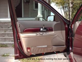

There are 7 screws holding the door panel on. There are 2 screws under a flap in the door handle.
You will need to pry off this piece, to gain access to the screw behind it.
This is the door panel off the door. There about 7 plastic tabs holding the door panel on, Use caution taking the panel off, they break easy.Un hook the blue connector, and unplug the white connector from the door module.

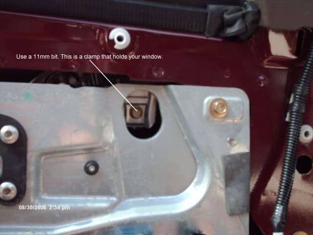

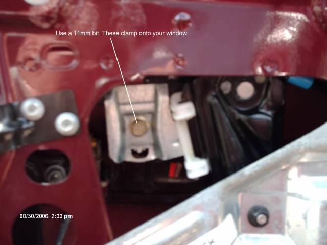

You need to unscrew the 7/16 Brass bolts . There are about 7 of these.
Loosen, but dont remove these bolts. they clamp onto your window.

In this image, you will see a black bolt. There will be another one to your left, and one below. These hold the regulator to the door.
I had to raise my window up to loosen the clamps. Make sure you use something to hold the window up, so it dont fall down.

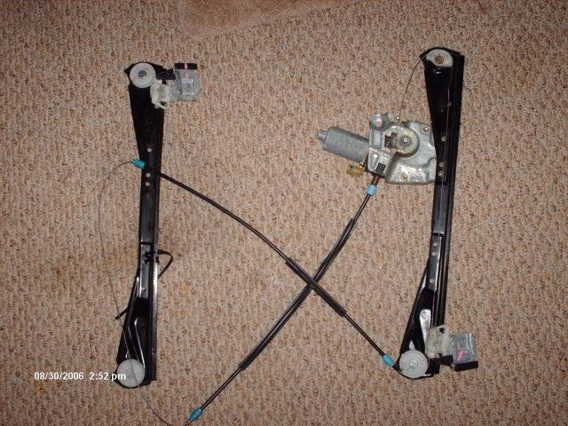

Unscrew the 3 bolts holding the regulator on, pull the old out. Put the new one in.

This is my old regulator. As you can see, the wires fell off the track.
