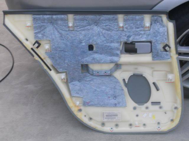

I pulled RR my door apart and here are some pics.
Mine is a gen 2 and I used a flat 12" prybar with masking tape over it to pop the 9 very tough clips loose without breaking them. No chance using the putty knife like on my beemer.
The screws are the two at the base of the door, two behind the pull handle and one on the front edge and one on the rear edge.
...and the corresponding clips on the door panel. I used a red line under the clips and a red v under the screws but when the image is compressed, they are very fine. Source photos on PB are good sized. Location in image properties.
Oblique shot shows the clips better.
Most aggressive ones I've encountered. Door panel pulls straight out, not out and up like a Beemer.
