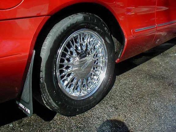

I just found a nice set of American Racing #49's in really nice shape, dirt cheap. Here is a photo, nice wheel changes the personality of the car (it had 10 spoke chromes).

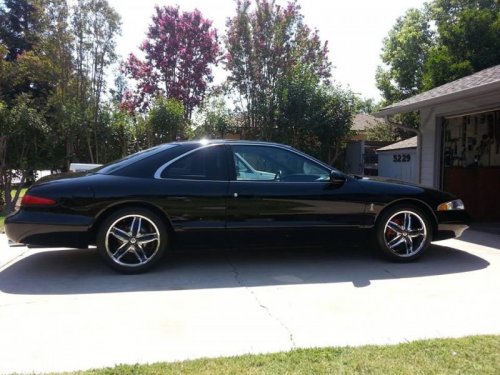

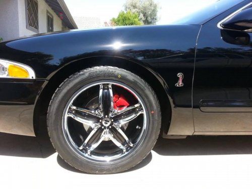

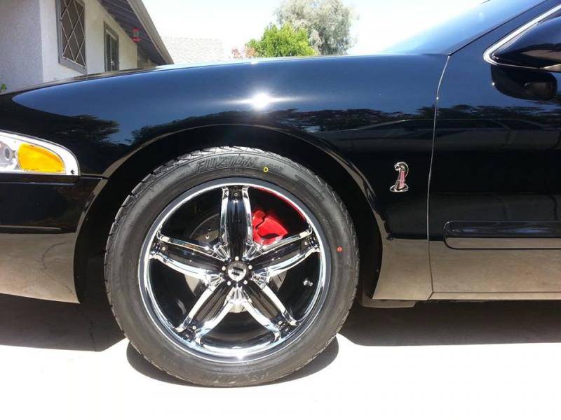

Helo HE844 18 x 8, 40mm offset, 5 x 4.25 with Bridgestone Fuzion 245/45. Sensor lowered about an inch and Cobra Bilstein shocks. Can't believe how spectacular it rides and I really like the way it looks, too! Very happy. :p My rotors and pads are new and the CobraStar is staying, so don't make those suggestions. lol

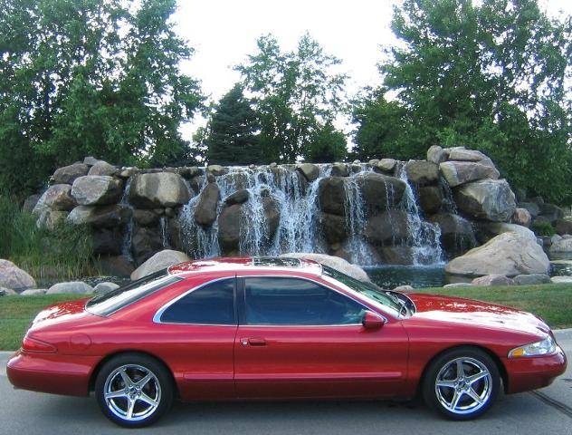

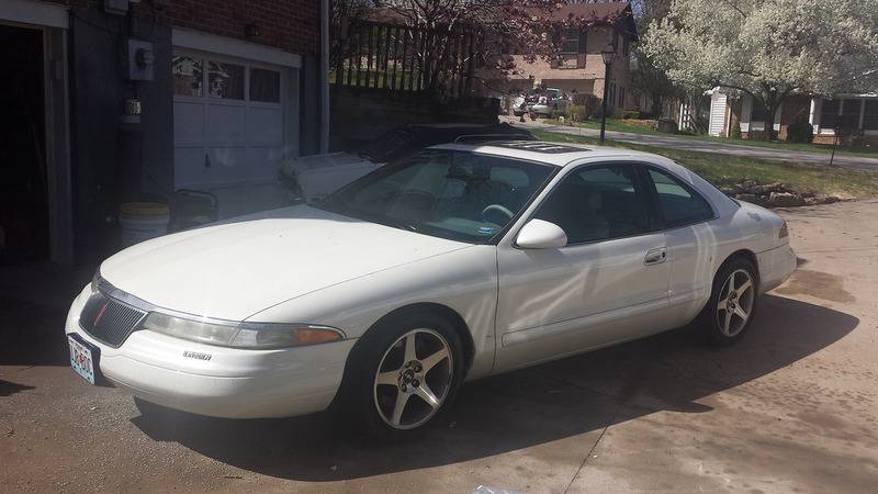

I have the 18X9 Speedstar wheels with the Mark8 bolt-pattern.
36mm offset
Sensor lowered
245-45s up front and 265-40s out back.
PERFECT fit with no rub anywhere ever.

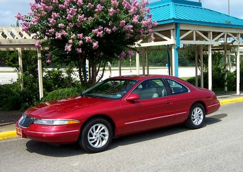

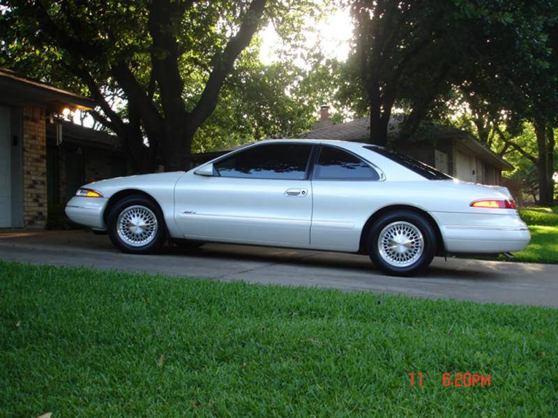

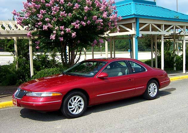

i would LOVE to have some of these on my continental,(below) if they fit.

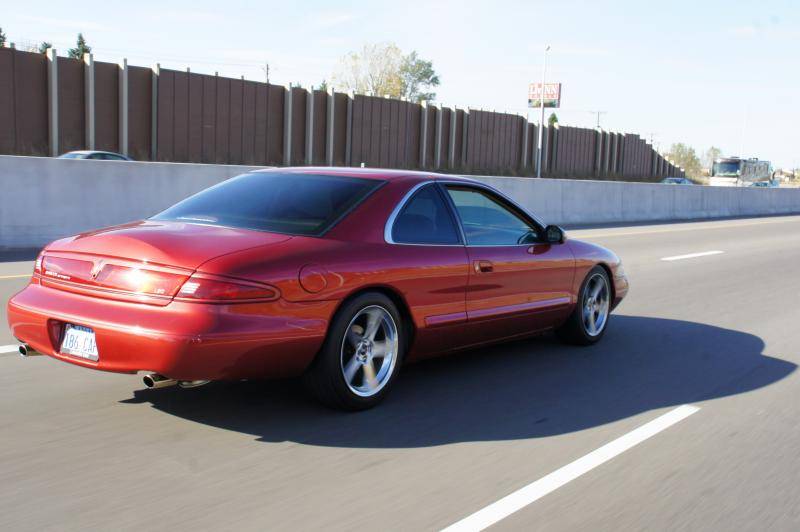

My car is a '98 LSC T red, just like Gearheads. By a freak chance, I came upon some FondMetal 17x7 with our 108 spacing, and the right offset. They're a five spoke design and I have 225x60 on the front and 225x65 out back. I needed Blizzaks for my trip into winter hell Alberta in January, and these were what I found cheap on Craigslist ($80!!) with 9/32 tread. I believe at full lock going right I rub a tad bit. I cannot say enough for these tires. I was driving on pure ice going over Lookout Pass and with careful inputs my car didn't miss a beat. Earlier, going into Glacier Park, we hit 6 inches of un-plowed fresh, and they were right on point and plowed right through. I have to admit that I shouldn't have exposed my beauty to that -35 weather, but that's why I bought it - to drive. After the car's impressive performance, I have to repair all quirks, as I cannot imagine a better all-around vehicle for an old fart like me. It also averaged 24.4 in subzero temps. A 16 year old car w 100k. I've got a '75 450SL that's going on the market - I've found my two-door cruiser.

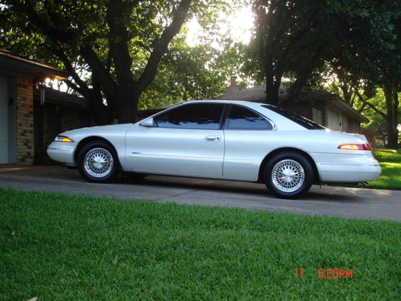

thought I'd update the thread with my current wheels.
97 Cobra wheels 17x8 with 30mm offset, 255/50/17 nitto nt555s. Still on tokico lowering springs.

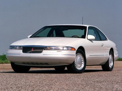

Here are the stock rim choices that came with different Mark VIII's. Any of the ones pictured below will fit on any year stock Mark VIII.
Stock wheel size is:
-16"X7" Diameter
-Positive 39 mm offset
-63.4 mm Center bore
-108x5 Bolt pattern
-225/60 ZR16 tires

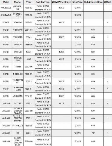

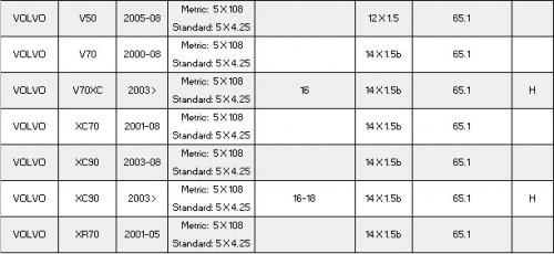

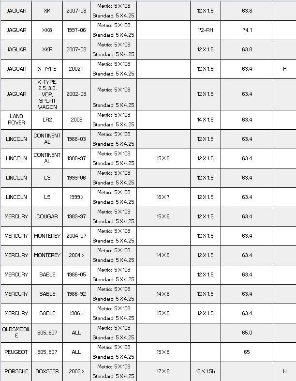

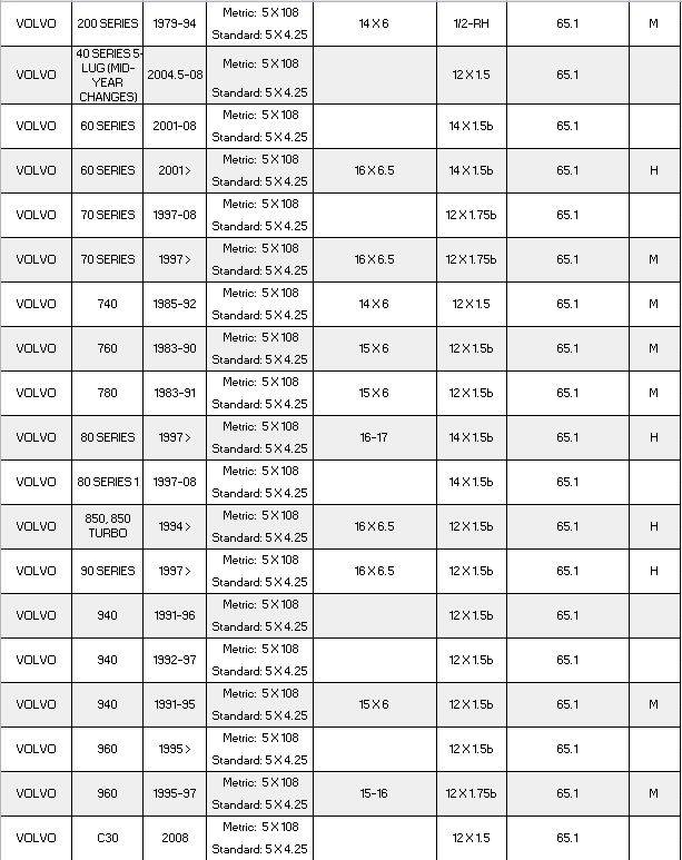

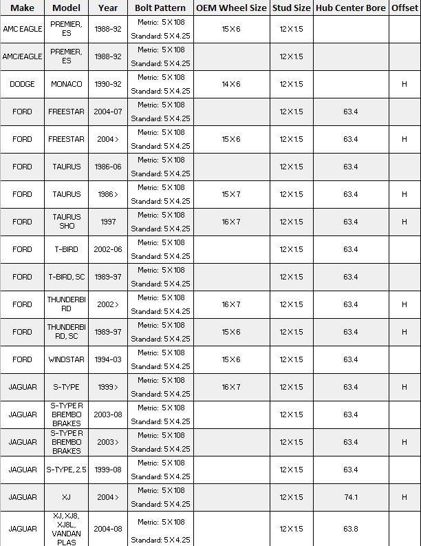

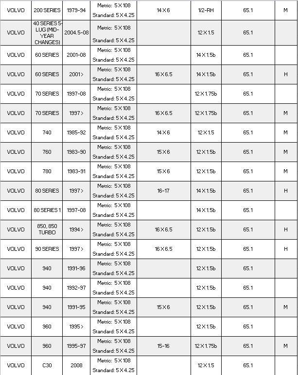

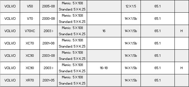

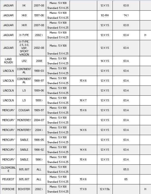

If your wondering if wheels from another car will fit you're Mark VIII here is a list.
Note: Please keep in mind that hub centric rings may be needed to use one of the following.
Note: Smallest rim that can fit on these cars is 16" on the Front and 15" on the rear, some that are listed below will not work because of this.

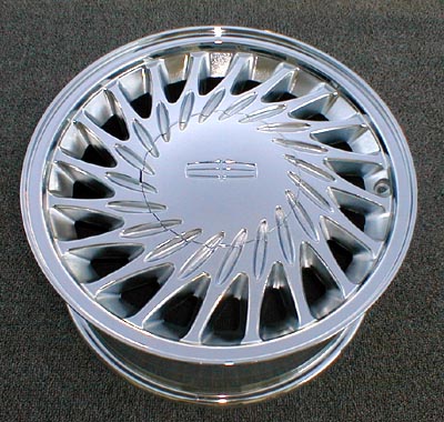

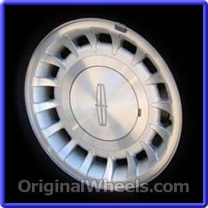

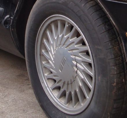

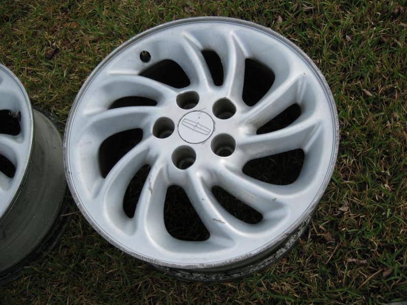

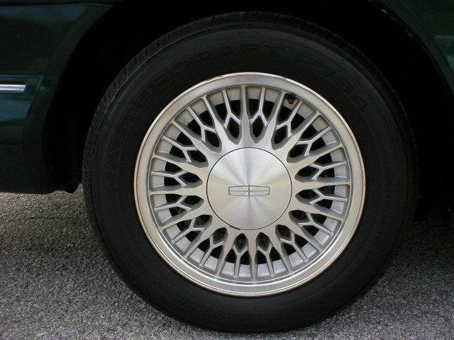

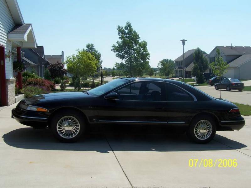

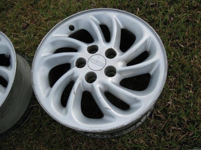

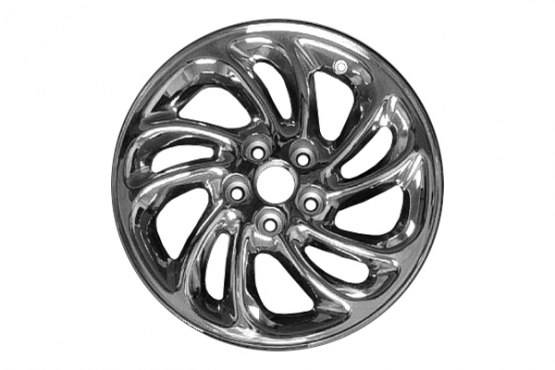

Here are the different rims that came stock on various Mark VIII's;

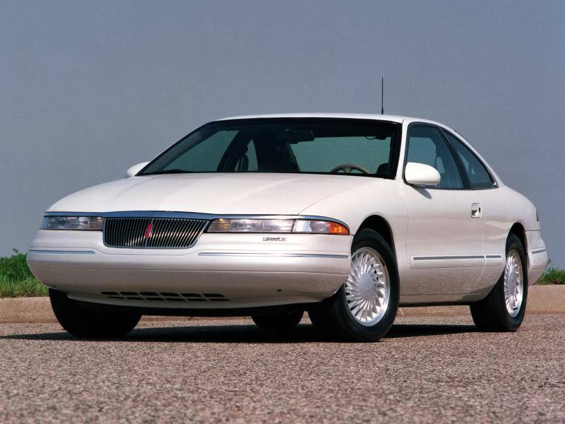

Painted Snow Flakes
Chrome Snow Flake

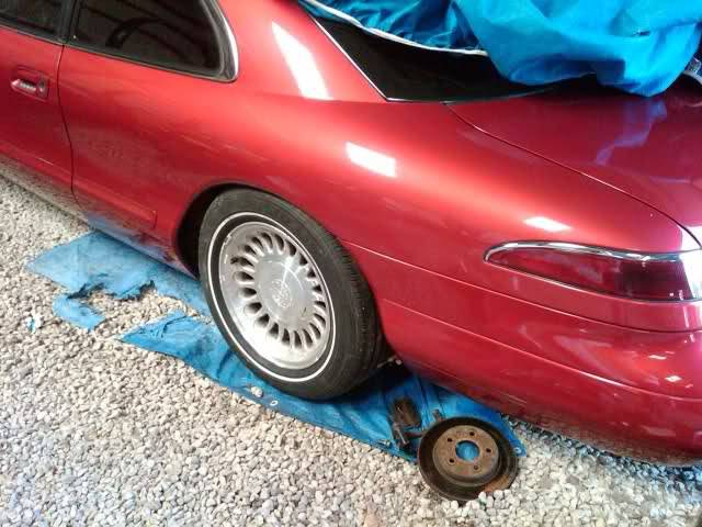

Painted Motion Spoke (10 Spoke).
Note: There is a left side and right side
Chrome Motion Spoke (10 Spoke)

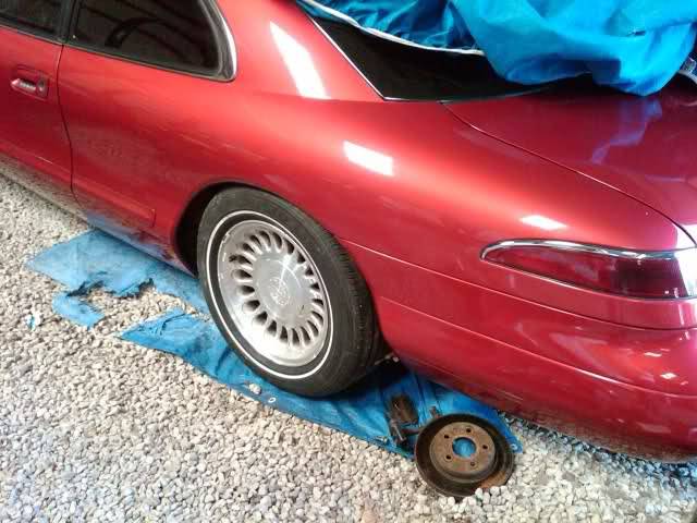

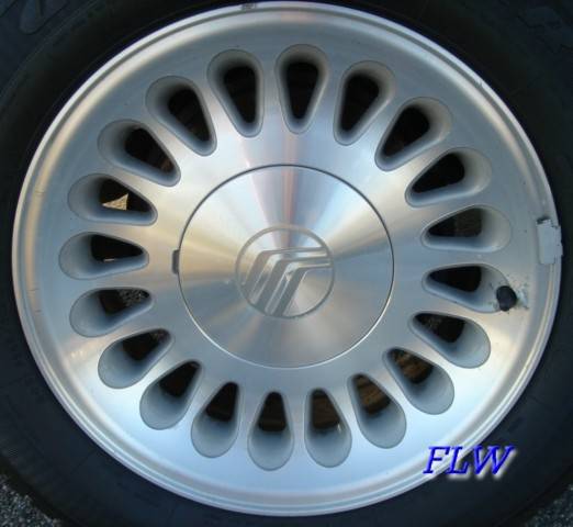

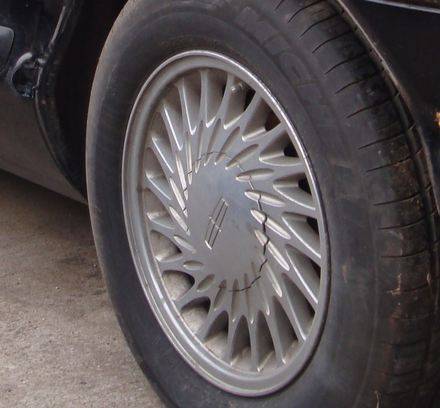

Painted 20 Spoke

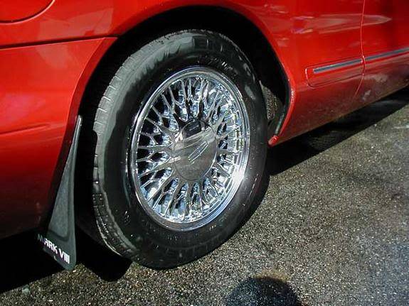

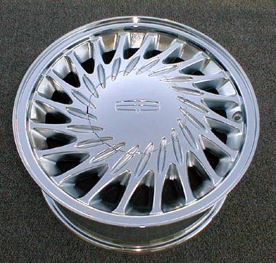

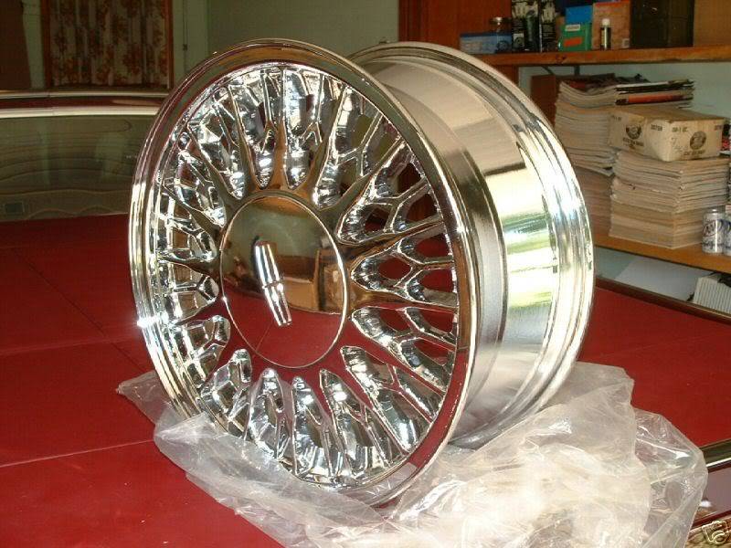

Chrome 20 Spoke

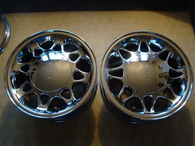

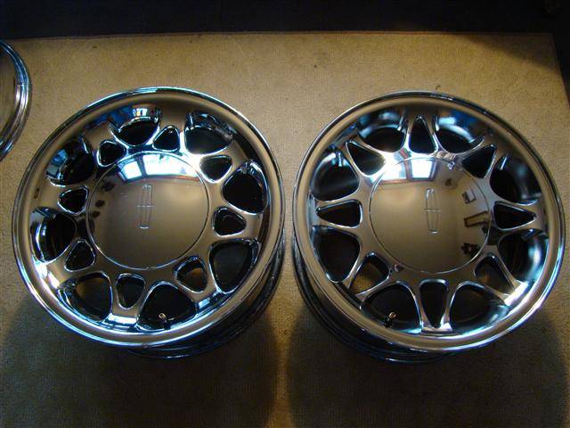

Chrome Octa-stars
Note: there are two different castings for this wheel (Some have a more polished finish then others.)
*Thank you to those who pictures I have gracefully stolen. :)

Eric, I have yet to see a chrome snowflake in person, only in pics. were there a few that were actually chrome from the factory?
I've seen pictures with a few Mark's with them but never in person as well. I'll have to look through my dealer books and see if anything useful come up, but you may be right, could be just a couple one off's out there.

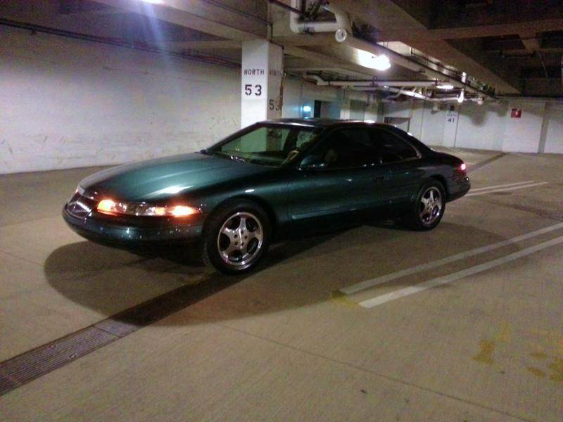

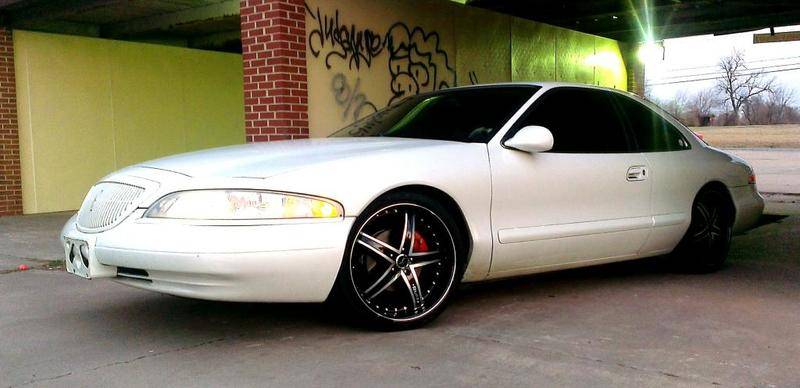

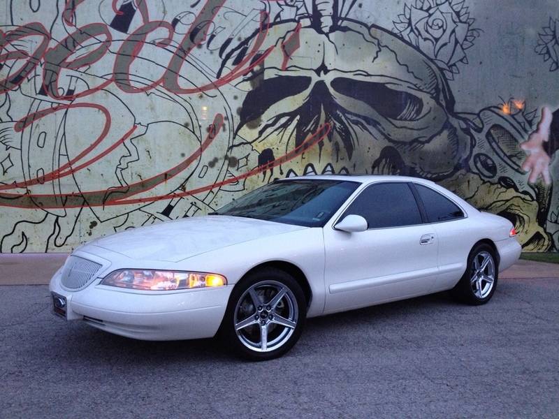

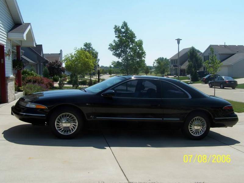

My White Gen II's......

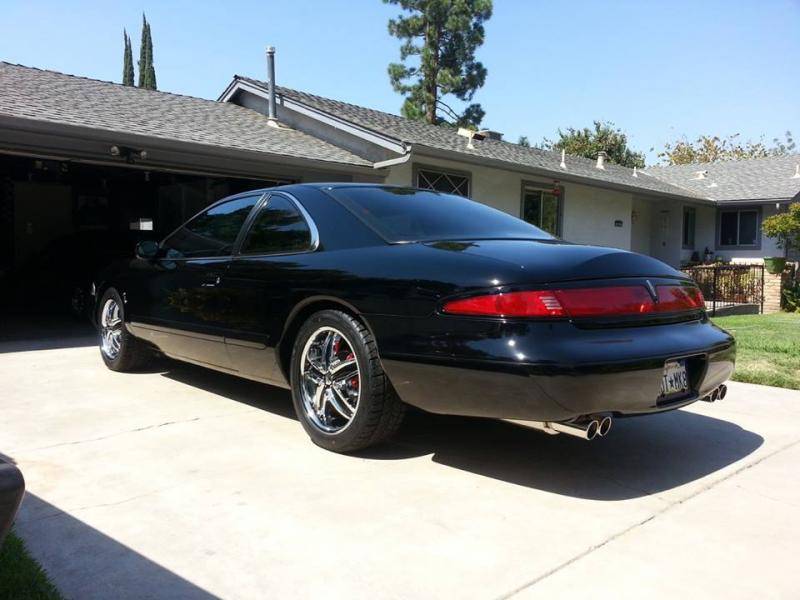

CHROME 18X9 Saleen Speedstar, 5-4.25bp, +36mm offset. Direct bolt on fit for Tbird, Cougar & MarkVIII.
Front: 245/35/18
Rear: 275/40/18

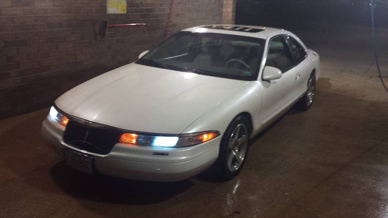

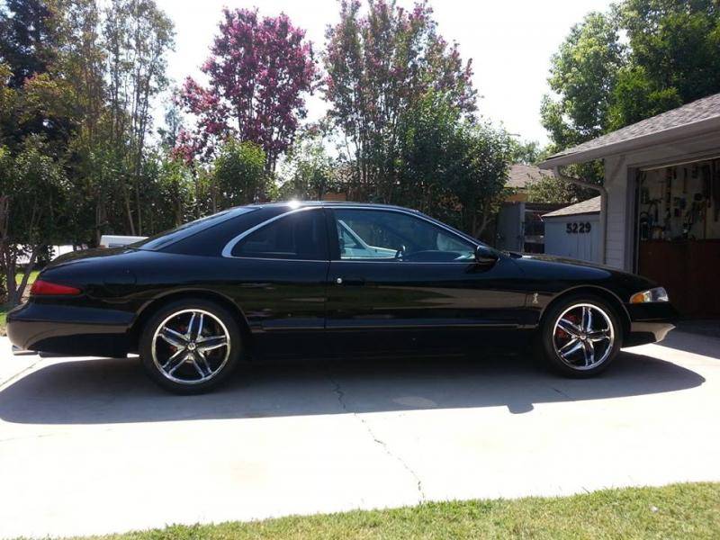

Ruff Racing R953 20x8.5 5x108 ET: 38 offset
Front: 225/35/20
Rear: 225/35/20
*Static Lowered 2", will need to roll rear fenders to fit wider tire.

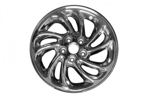

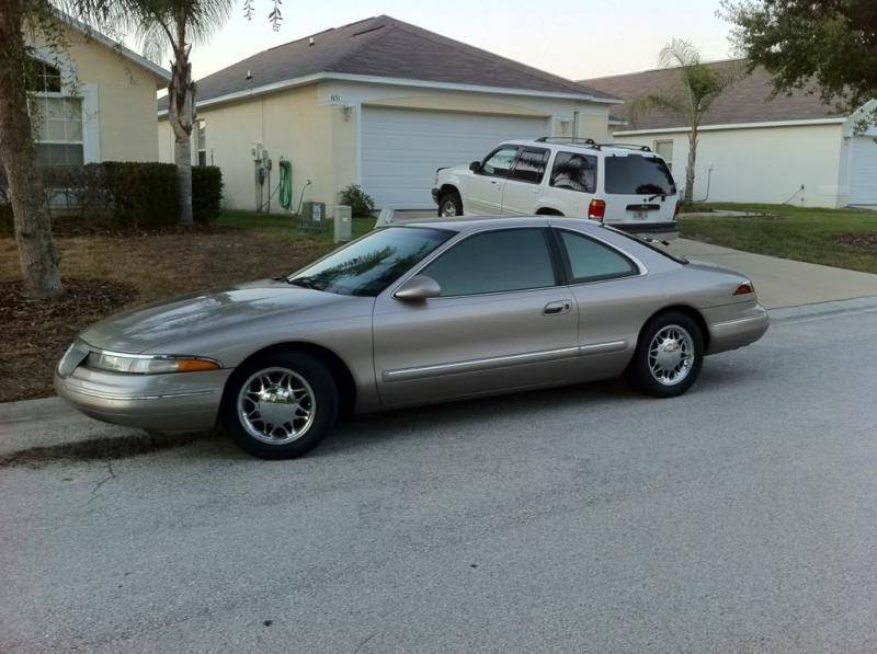

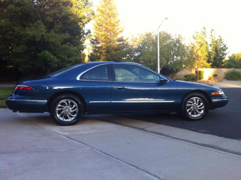

Greeting, this is my first post.
A few days ago, I bought my first Mark VIII. It's a 1995, an odd metallic gray with a hint of purple, 67k miles.
Love the car, but not in love with the wheels. "Painted Motion 10 Spoke", meh.
I think it would look great with either of the wheels linked below, but I don't see them on the list posted above.
Is either going to fit?
THANKS IN ADVANCE
