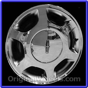

If you like the Grand Marquis 10 tear drop or the Town Car wheels better than the 10 spoke directional wheels, then you should look at what was offered in the Continental. The have less "dish" but more of a flat loo, Something like:
Correct backspacing and bolt pattern.

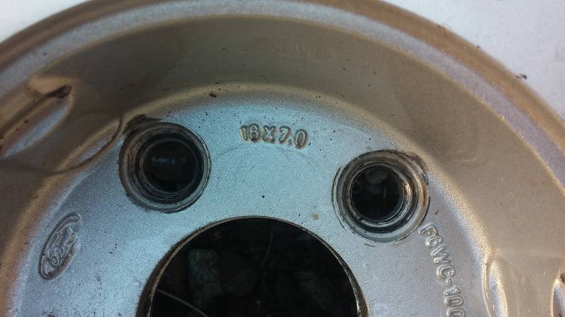

I'm trying to avoid the hub swap. Is there any option here, in a 17" Lincoln wheel?
Or, optionally, the meatiest tire for stock 16x7 rims that doesn't hurt handling? Those fender wells just look a bit empty with the 225/60s.

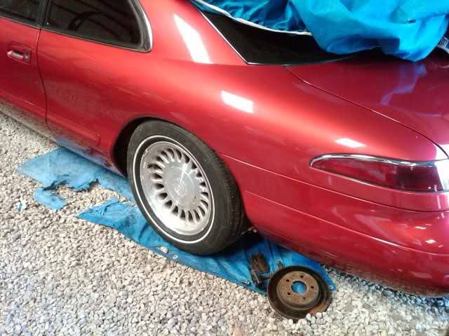

I found some 17" Aviator rims for a good price. Would these work, with 1.25" adapters?
Thanks in Advance
1.25" adapters are going to subtract about 30 mms of offset.
so i'm not sure what the aviator wheel offset is exactly, i suspect about 35-45 mm.
which if so, gives you an effective offset of about 5-15 mm. which no, that will not work.
if you are going to run an adapter, your wheel offset needs to about 60 mm or so.

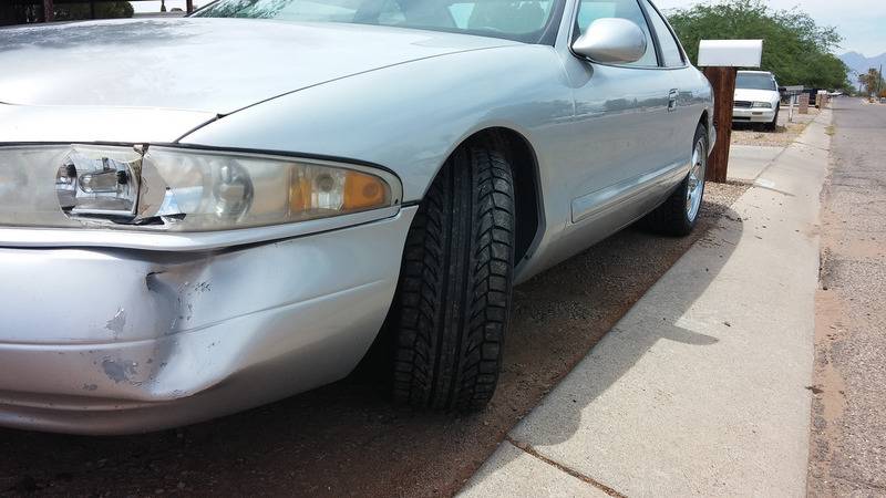

Can we get more opinions on the 'rubbing', with say, 235-60-17s? I ask, with all due respect, because there are some cars on this thread with bigger tires than I mention above, and no problems.

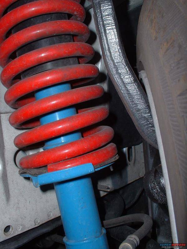

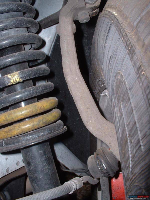

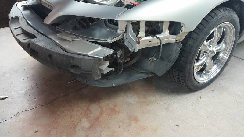

I run 255/45/17s on 9 inch wide wheels with proper offset (well, not proper, I run a 3/16 spacer in front because the wheels contact the spindle) and if I have enough weight in the back and hit a bump the fenders can touch the sidewalls in the back. I have a ton of space between the top of the tire and bottom of the wheel well, but cheapo air-ride replacement steel coils.
If these stuck out 1/4 inch more I think they would rub a lot of the time in the rear ( think these are 36mm offset so a 3.56 front spacing, 1/4 less than your 7.5 example with 1.25 adapter):
front with 3/16 spacer:
1.5 inches larger diameter will fill the wheel well better (235/60/17 versus 225/60/16), mine are actually .5 shorter than stock, I didn't want to go taller knowing I would already rub, and there wasn't a satisfactory for me combo of width and diameter for 17s on a 9 inch wide wheel.

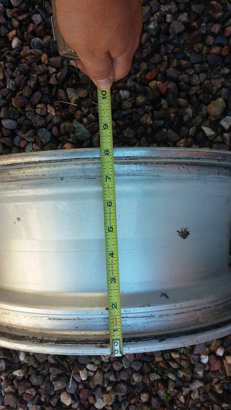

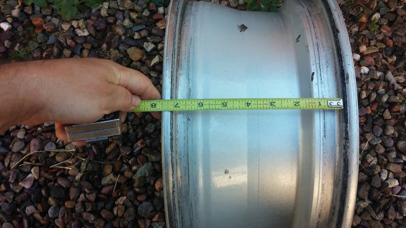

you add 1/2 an inch to front and back spacing for the lip. It should add up to 8.5 not 7.5 when you add the BS and FS.
so 7.5 with BS of 44mm is half of 7.5 (3.75) + 44mm (1.73) which is 5.48 plus another .5 inch for the lip is 5.98.
front spacing is half of 7.5 - 1.73 + .5 which is 2.52.
My 9 inch wide wheels are actually 10 inches inner lip edge to outer lip edge.

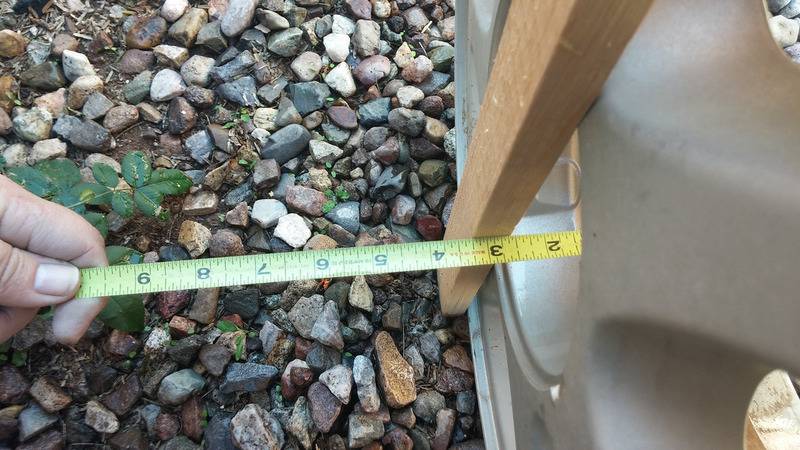

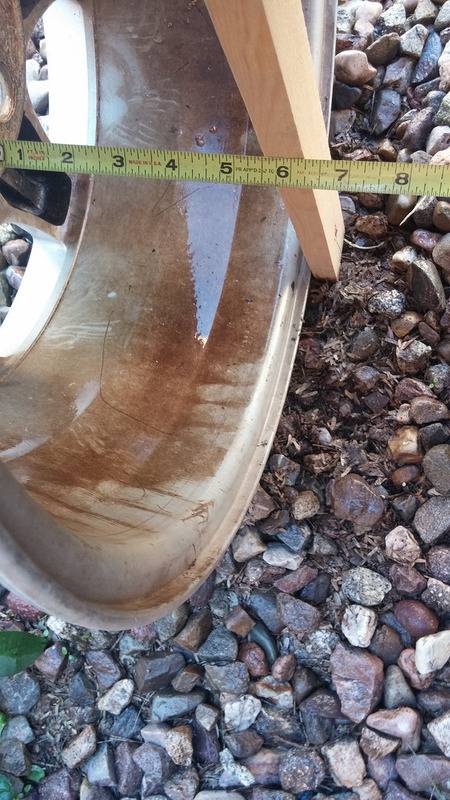

16x7 Cougar XR7 (supercharged) or late Sport wheel (dirty, dull, and my favorite OEM MN12 wheel)
inside to outside is 8 inches
inside lip to inside lip is 7 inches
5.5 backspacing (I am just rounding all of these, nothing precise about this)
2.5 inch front spacing
When your dealing with this kind of clearance (This is WITH 3/16 spacer!) with a 9 inch wide wheel, it is very important. I am picky, I think that the front wheels stick out too far, and it is a matter of a couple of mm's.
