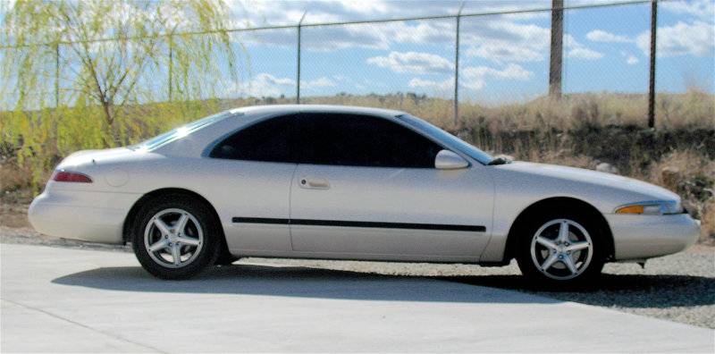

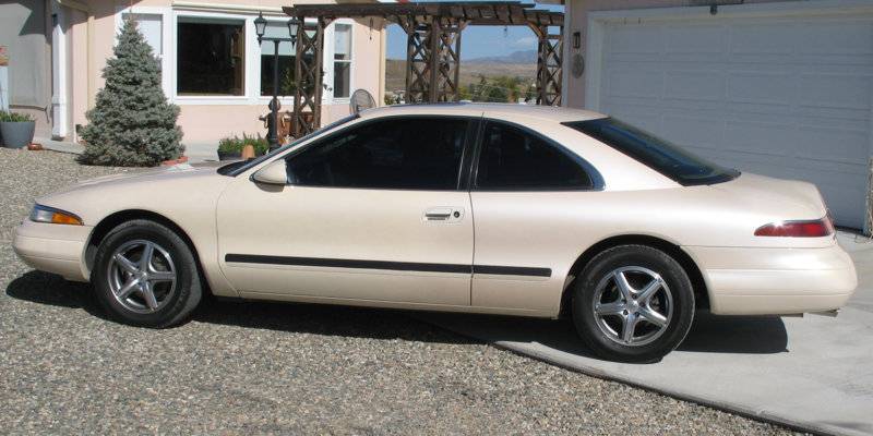

On my 95 LSC, I am running the 16"X7" 4.25" radius, American Racing Maverick AR883 Wheels, .40? setback, (they look about the same as OEM in the wheel wells). These wheels were on the car when we bought it.
For now, running Aspen Touring 225/60/16 tires on them
Ivory stripe right:cropped.jpg
Ivory stripe left:cropped.jpg
1995 Ivory Pearl LSC

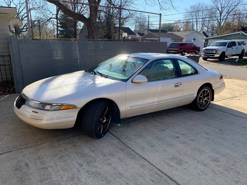

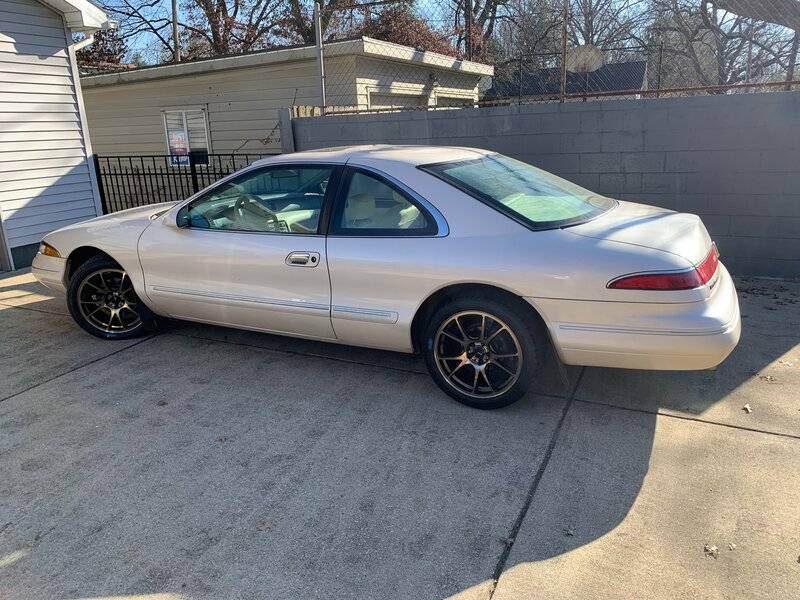

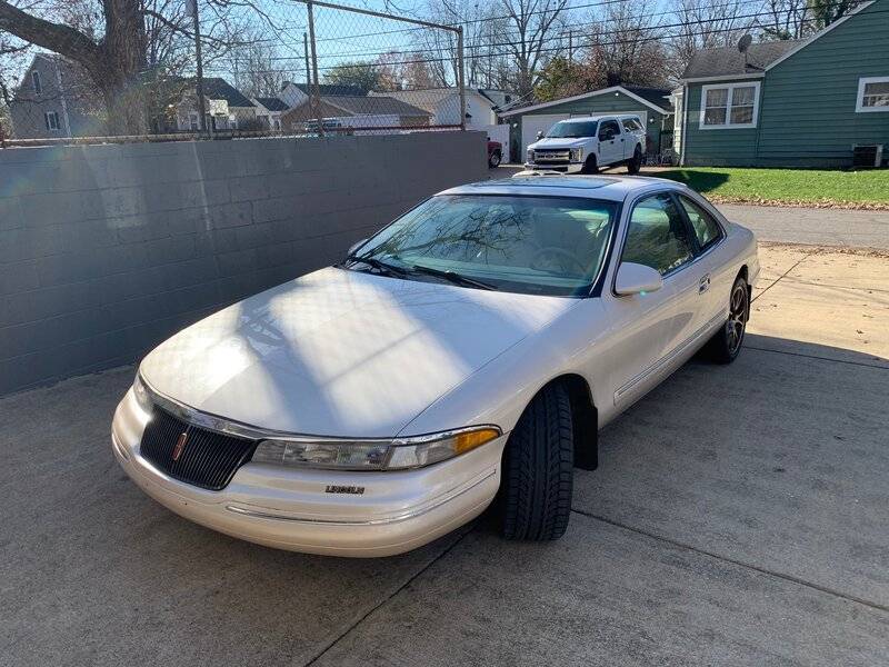

Long time lurker first time posting. I would like to share my 1996 Mark VIII with this site as thanks for all of the information in this chain! The wheels/tires are:
Wheels:
Konig Freeform Radium Bronze 18x9
Bolt Pattern - 5x108
Offset - 38mm
Hub Diameter - 73.1 (plastic hub rings used)​
Tires:
BFG G-Force Sport Comp 2
255/40R18​
I used information from this group to make my decision on the wheel/tire package. Thanks to all that posted and provided valuable information for Mark VIII Wheels and Tires.
Regards,

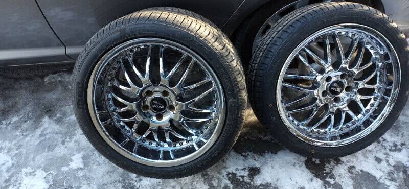

I have spent hours reading to see if a 19x10 rim (5x108) will fit on the rear with a 285/35/19, with an offset of +50. I would think not possible. I have not fender roll etc. all stock.
I haven't seen these before and the TSW Snetterton are currently too expensive for me right now.
I would test fit, however they are 5 and a half hours away from me.
a 19x10 et45 fits so a 50 shouldn't be too far off. the 285 tire isn't the problem.
would be a lot tougher up front unless its staggered set.
Thanks Chris! it is a staggered set with 245/40/19's on for the front. I would prefer to have all the same size to be able to rotate those ultra summer tires. Hey said he bought them for his Jag, but they rubbed. He said he then used 8 mm spacers and they wouldn't tighten enough.
