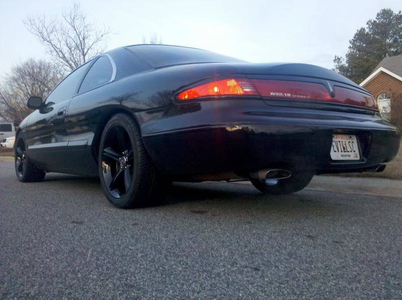

      -OEM 2010 Mustang GT Premium
      -19x8.5 50mm Offset
      -5x4.5 Bolt Pattern
      -245/45-19 Pirelli P-Zero Nero All Season
      -Hubswapped, 15mm H&R Hubcentric Spacers, Sensor Lowered ~1.5"
      -American Muscle 2010 Mustang GT Premium Replica
      -19x8.5 30mm Offset (Front) 19x10 48mm Offset (Rear)
      -5x4.5 Bolt Pattern
      -255/40-19 (Front) 285/35-19 (Rear) Kumho Ecsta SPT
      -Hubswapped, Sensor Lowered ~1.5", Rear Fenders Rolled, Stock Sway Bar(Clearance is tight on sway bar), 2003 Cobra Bilstein Rear Shocks

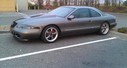

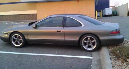

        -04 Cobra
        -17x9", 24mm offset
        -Kumho Ecsta ASX / 4X
        -275/40-17
        -hub swap, bilstein shocks, minor sensor lowering.
        -no rubbing now, but i assume it would rub lowered and without stiff shocks.
        this is more or less how she sits now a days.

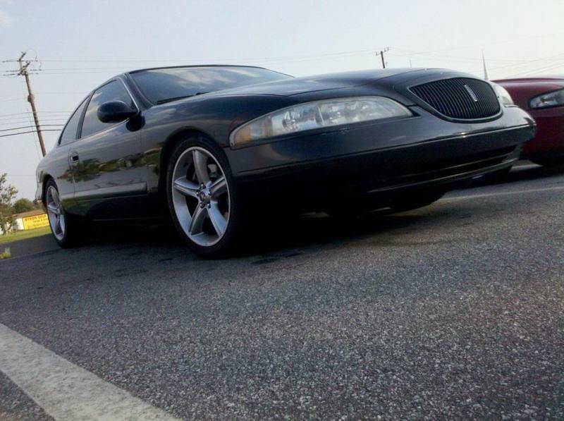

        18x9 front with 245/45zr18 nitto invo
        18x10 rear with 275/40zr18 nitto invo
        1.5 eibach drop springs and tokico illumina shocks.
        On air sensor lowered and weak shocks it rubbed slightly on large bumps. With springs and the new shocks no issues.
        Wheels came from Brad at the custom wheel shop in the mark viii bolt pattern. I'll have to check the wheel for exact offset or maybe Brad will chime in.
        18X9 +36MM
        18X10 +45MM

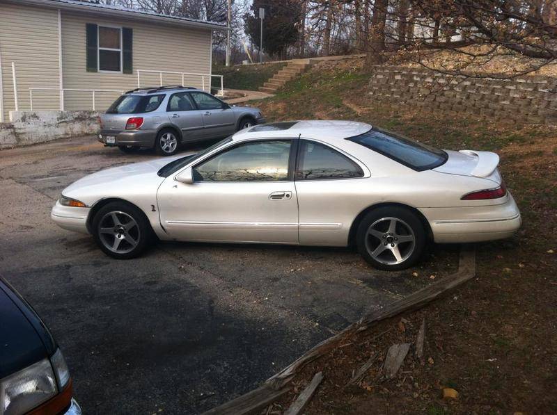

          Factory 03 mustang bullitts
          17X8
          Bolt pattern 5 on 4.5"
          30mm offset
          5.72" backspacing
          245/45/17 bf Goodrich
          Asham8 No rub
          Hub swapped

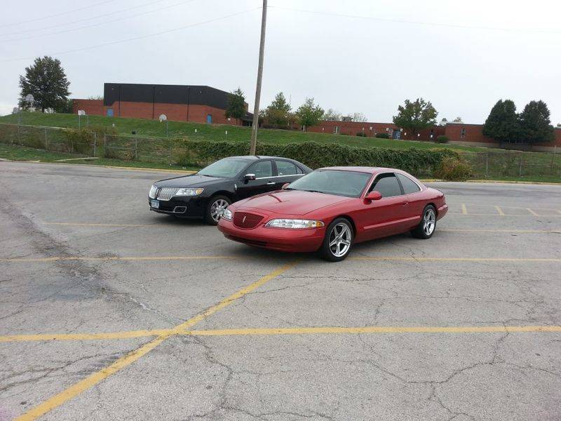

              These are the 17x9 bullitts with 24mm offset and 275/40/17. There was a slight rub and I trimmed the fender about half an inch and the rub went away. But the speedo was off. so I went to the 255/50/17's and because of the larger diameter, not only was the rub back, but now the front would rub when the wheel was locked. I'm going to try 235's and hope the rub is gone. I'm a little irritated.
              First pics are with the 275/40/17's.
              [​IMG]
              [​IMG]
              This is with the 255/50/17's on the white rims that rubbed and 215/65/17 on the gray rims 17x8 24mm, which there was no problems at all.
              [​IMG]

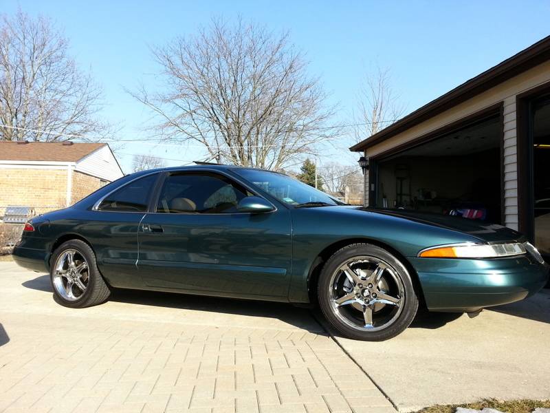

                      I have the 18X9 Speedstar wheels with the Mark8 bolt-pattern.
                      36mm offset
                      Sensor lowered
                      245-45s up front and 265-40s out back.
                      PERFECT fit with no rub anywhere ever.
