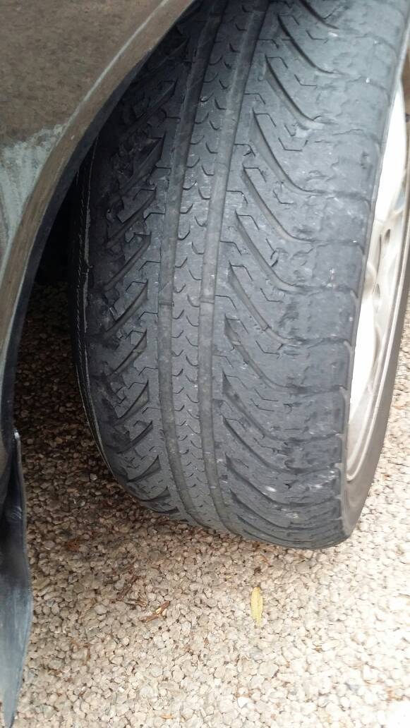

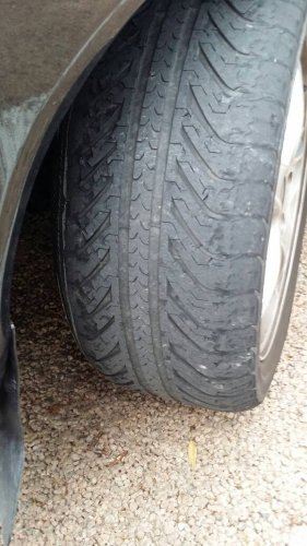

Had to take off the Sex shoes she chewed up and put some cheap used skinny uglies on until I get my new rim and fix the front end :(

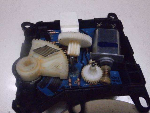

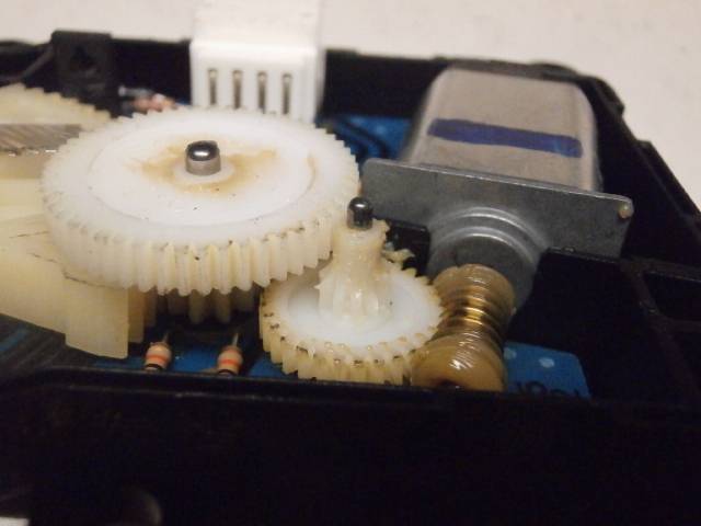

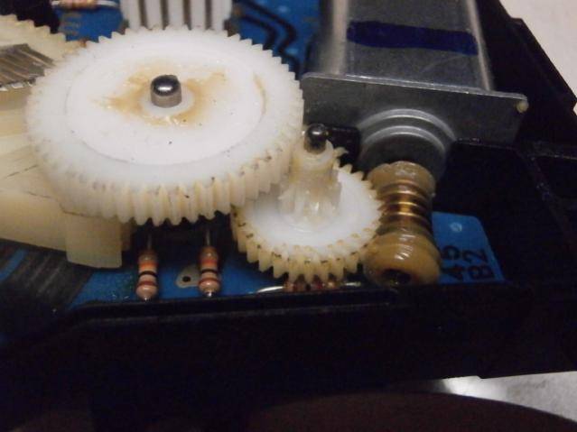

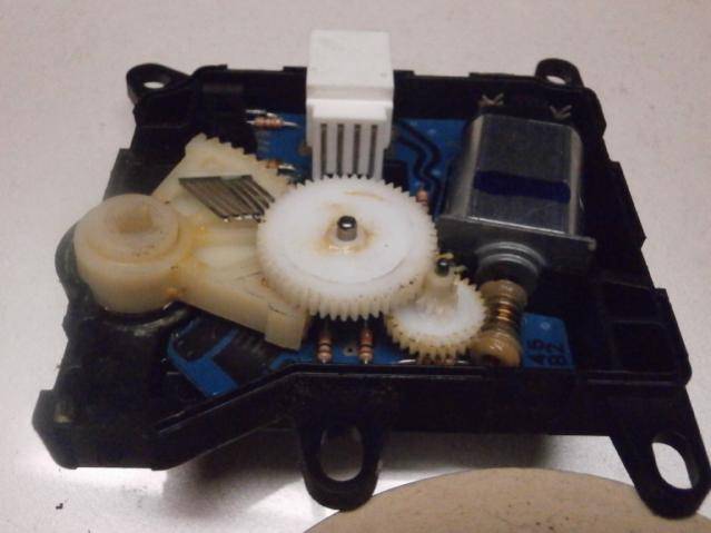

Tonight I removed 14 bolts/nuts and pulled the dash back enough to remove my gen 1 BDA; opened it up and found a stripped gear
I have two other salvaged gen 1 BDA's that have good gears inside; BUT can I/should I get a new BDA for a gen 2 mark/TC and take the new (black plastic) gears from it and put them in my gen 1 BDA?
I had a spare gen 2 blend door actuator when I pulled my 93's blend door actuator in the hopes that it was a stripped gear. I had them both opened up and I'm pretty sure that gear can be replaced with a gen 2 actuator but I left it alone because I really didn't notice a difference between the two. I know second gen gears are better but again I really couldn't see why. Maybe mine had been changed out before?
yea, I'm just gonna use the salvaged parts i already paid for; i was really dreading this job, but with these easy step-by-step instructions on LoD I was surprised at how smooth it went- but I'm only half way done, reattaching the dash could prove to be difficult. I'm converting the int from ivory to black, so alot of this I'd do anywho
That tech article is the best. I would have never attempted to do my blend door if it wasn't for the article.
