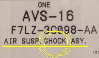

Those front struts usually go first. The rear air canister would be next.
At least Ford knows what they are :rolleyes:
