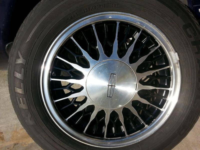

Washed it:

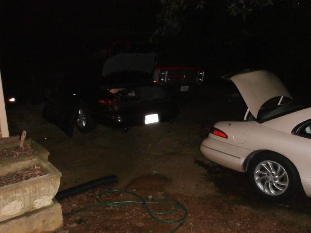

after work, swapped power amps so the white one (dd) has a working stereo now :cool:

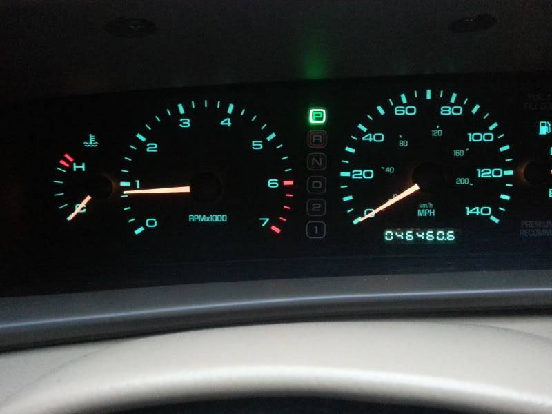

the brown one was running warm, so i burped it, fan came on, upper radi hose got hot, lower radi hose never got warm :shifty:
Upper hose receives the hot coolant from the motor, the lower will be cool as it's the return hose.
on my other car (the white one), with the new radi and MC t-stat, the lower hose went from cool to warm, indicating the tstat opened? it runs normal temps now btw
----on the brown car, the temp needle got up to the middle of the gauge pretty quickly, fan came on, lower hose stayed cool the whole time; something's wrong with it but I don't know what. I figured my tstat never opened? both heater core water hoses get warm/hot btw

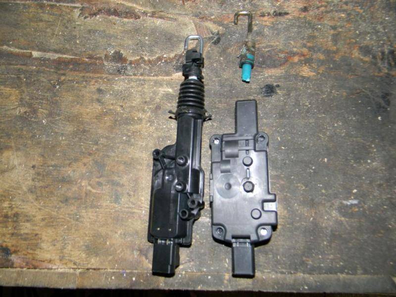

Replaced DLA and window motor today. DLA put up a good fight, after about a half hour I just broke the top off and she came right out, new one went in easy peasy. First time that lock worked by the push of a button in eight years.

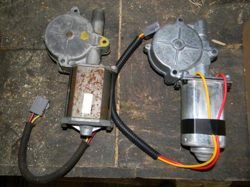

Put new window motor in, it went up/down perfect, put door panel back on and it stopped working. Pull panel off again, take motor out and test and it goes up/down perfectly, put panel back on and still works, move car to the driveway and it quits working. Now I'm thinking WTF! Pull panel for a third time, pull motor and re-box for a return.
Decided to take apart old motor and see what's up. Brushes and motor look new, pulled plastic and metal gear and noticed plastic gear turns metal gear but inside of plastic gear was stripped. This looks like an easy fix for me!. Clamped metal gear to plastic gear and drilled three holes through both and fastened together with screws and it works perfectly! That motor now should last a lifetime!
Wish I would have took pics of that fix...You would have been impressed! I'm going to do the same with the old ds window motor, I'll get some pics on that one. Once fixed like this it should never go bad again.
