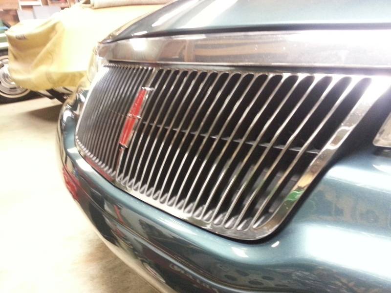

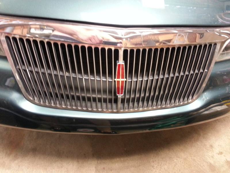

Old grille..new grille, bada bing, bada boom.. (if only it was that easy)

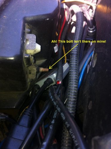

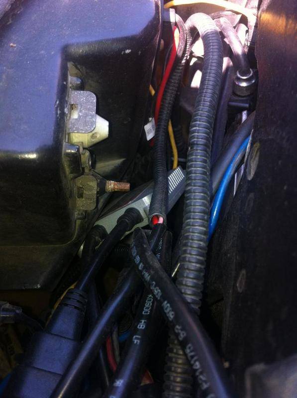

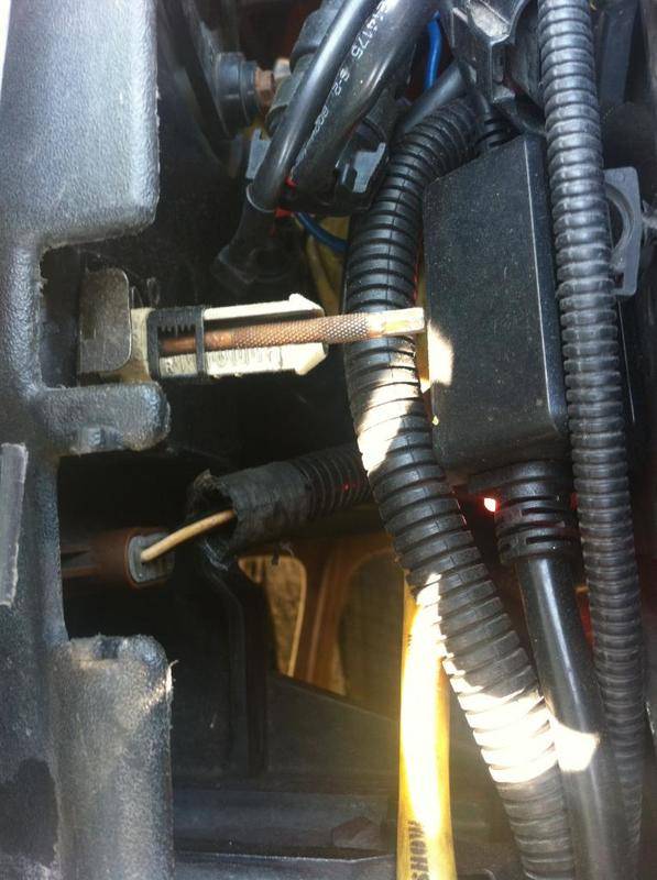

Okay, with the headlights on a Gen1, how are they mounted? The problem I'm having is that they are not solid, they are hanging down and literally "resting" on the bumper. There should be a gap between the bottom of the headlight and the bumper but on mine, the headlights are in contact with the bumper and I can lift them up about half an inch but they fall right back down. Any suggestions?
there are mounting studs on the back that go through the header panel.
where the stick out the other side, there is a clip.
these clips are easy to lose and sometimes don't get put back on and get lost.
i'm getting pics of where they go.

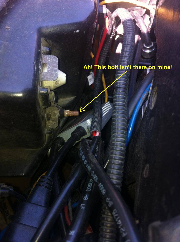

That bolt isn't there on my headlights :confused: That must be the bottom adjuster. That's apparently why they're hanging like that. Thanks!!! Now...what do I do about it? :lol:
Take the headlight housing out and see if the adjustment screw is missing or broken..I know on my lsc headlights all of that mounting hardware is bolted onto the back of the housing..I can't remember what the base housings look like on the back..I think its slightly different, the adjustment screw bracket might be molded into the plastic so if its broken you either need a new headlight housing or have to reglue it somehow.
That's what I was afraid of. Well, I guess that'll be another project for the weekend. I can probably rig something up. :)
They used to be properly mounted when I installed the HIDs about 2 years ago. I guess the "mechanics" at Pep Boys couldn't figure out how to remove them when the reinstalled the halogens. Gman has a nice housing for sale.
I kinda figured something like that. No biggie. It's possible I may be able to do something aobut the headlights. I'm like McGuyver with stuff like that :D I'll have all day next Saturday to mess with it. :)
the clips are available through NAPA... I think I have extra adjusting screws if you need em...although those may be an integral part of the housing? idk

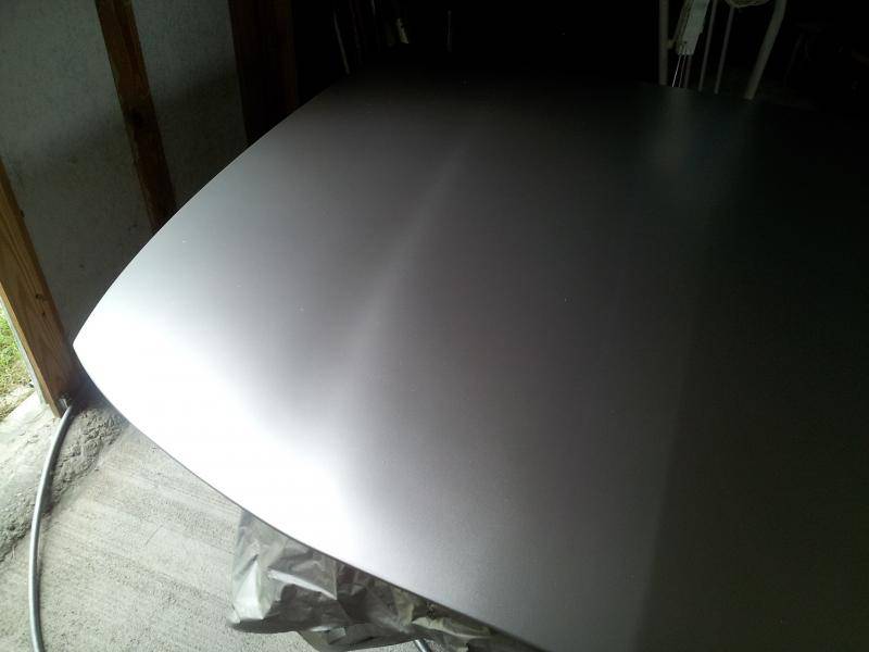

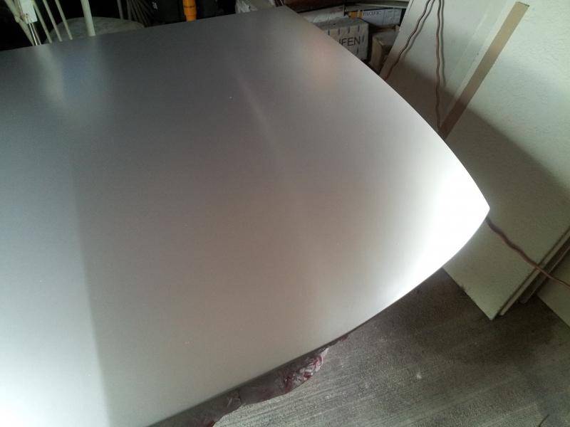

Been doing a lot but this is what i got done today. Just the base coat. Will be doing clear in couple of days. Working on a long long project with my 93.
Thay it'll work fine. Just cap off the back 2 o2 ports. Are the sensors good? If so you might can sell em. Or.just use them to plug the holes
