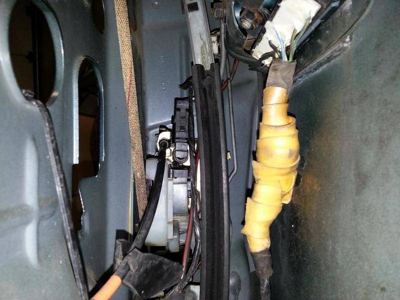

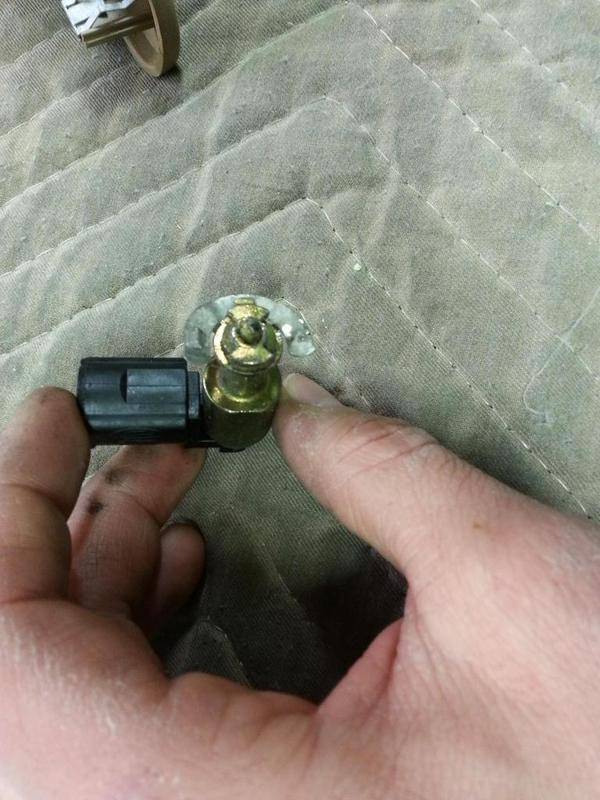

Does anyone know where the door ajar sensors are on a gen 2? When the car thinks the door is open it f.. s up a number of things. ( Gen one button in jam not so on my 97)
Finally completed my first extended nightmare suspension fix. Bailed and went to springs after replacing fronts/back air bags/ compressor twice ( one used /one new) relay shot and new compressor had a leak in dryer.Arnott much better ride and correct height compared to Strutmaster done on y 96 in the past. Little squeeky on the front spring bushing but otherwis ok. Did UCArms,sway links while at it. Fell better now.
Its inside the door near the lock mechanism. If you remove door panel and look inside you should be able to see it, unplug and turn a 1/4 turn to release it and pull it out. Spray with some lubricant and push the little button in and out a bunch of times, my guess is it is probably just gummed up.
nice write up kevin but thats the very detailed way to do it, the easy way is to spray a bunch of pb blaster into the latch and slam it 10 times or so, either way you do it, thats your problem
Yeah I tried the pb blaster with door slams for a while which helped with the door ajar light but then my door key pad intermittently wouldn't work and interior lights would stay on after closing the doors so I pulled that little switch out when I was replacing my door panels..wasn't too tough so long as you don't have fat arms lol.
