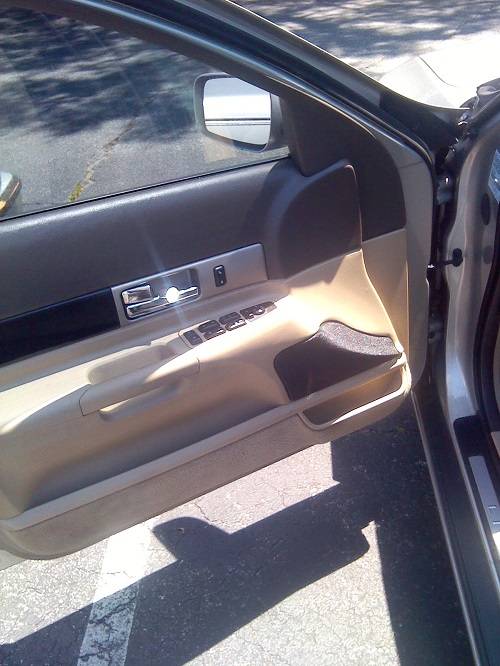

Well the interior and exterior got a huge cleaning, and I re-checked my a/c. all pressures still holding firm. But the speaker grills got painted.

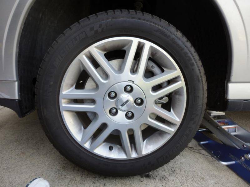

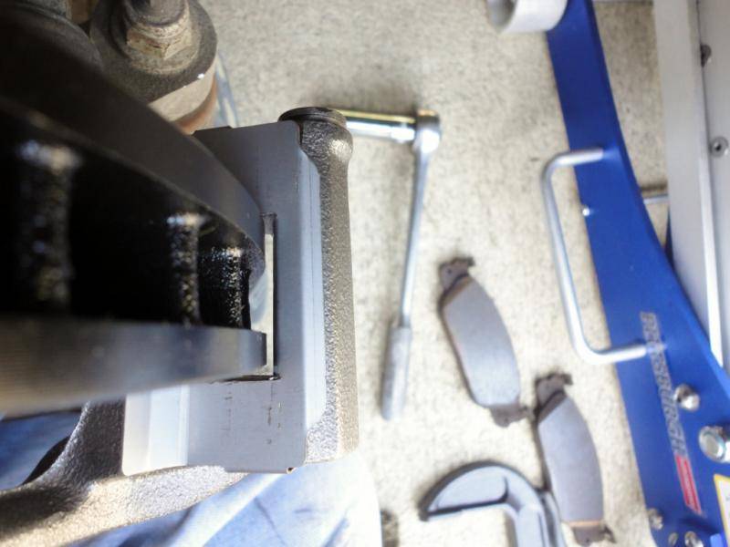

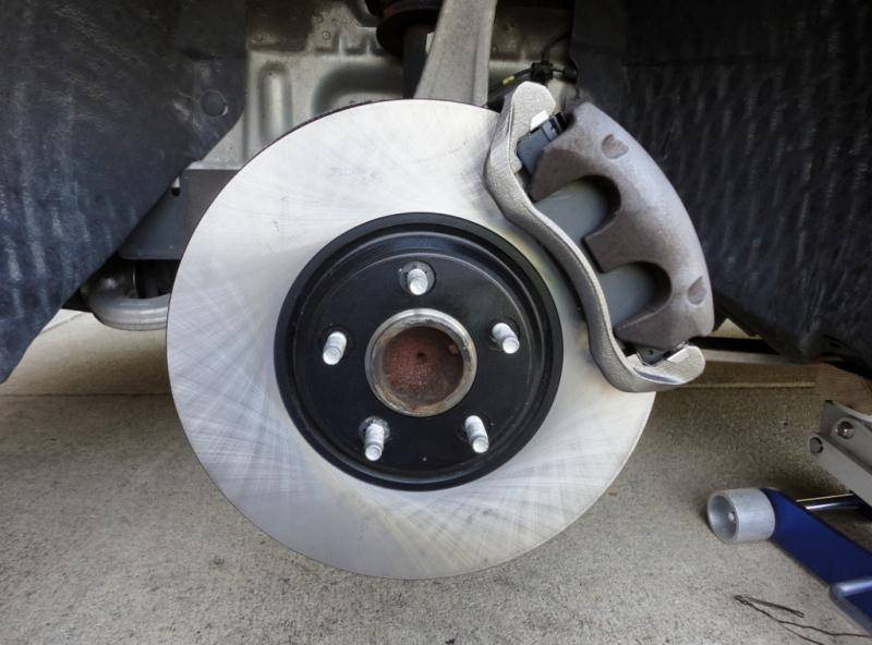

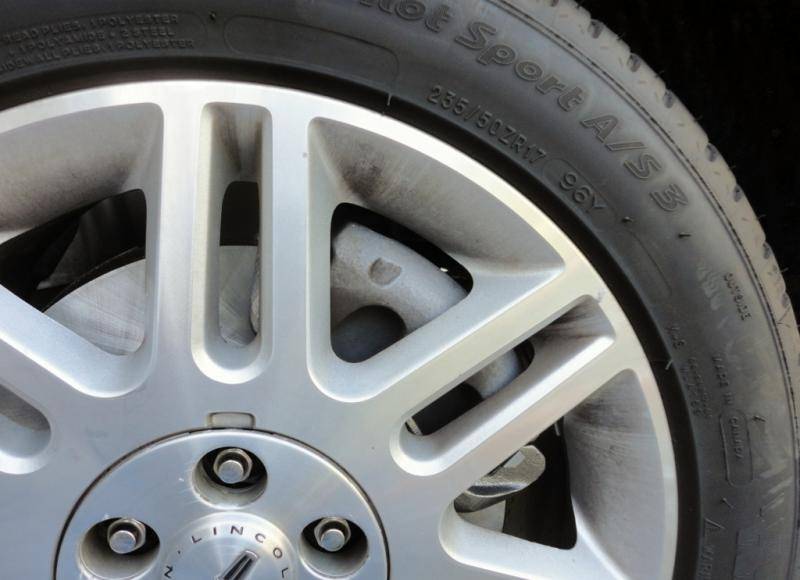

After checking the front rotor and pad thicknesses, I knew I needed to address the front brakes soon. I was somewhat unimpressed with the performance of the stock brakes, even with the semi-metallic factory pads that are part of the Sport package. Plus I needed something that would fit behind the both sets of the 17" rims, both of which have been fitted with new Michelin tires in the last six months. Because of the bolt-on nature and the fairly low cost of the Jaguar 12.6" front brake, I ordered the following;
Centric #125.61077 rotors (high carbon alloy, plain finished, non cryogenically treated)
Porterfield R4-S pads; front #AP933 and rear #AP806
re-manufactured caliper mounting brackets from Cardon #14-1650 & #14-1651
and modified the caliper hardware kit from AutoZone #H5942.
I finally got around to installing the parts this past weekend. I had to dress the outer edges of the front brake pads backing plates to fit properly in the Jaguar caliper mounting brackets with the reworked Ford hardware kit. I did not have the time to install the rear pads nor the Centric/Stoptech SS braided lines #950.61503 and #950.61006 that I also ordered. Hopefully I will get those parts installed soon. The PO had the brake fluid flushed recently at the dealership and the calipers are in very good condition - so it was not critical to address those components at this time.
I am fairly impressed with the improved pedal feel and stopping performance with just the parts installed so far. Sorry for the photos with the dirty wheels.

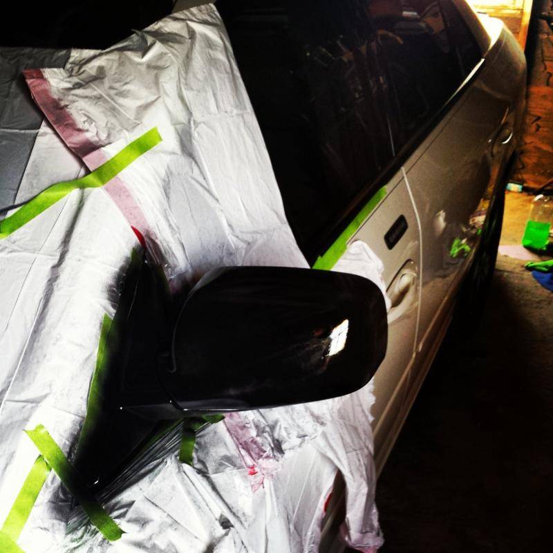

I didn't post a pic in my previous post. When I had it installed the first time, the filter fell off the outlet end and I had dirt mess up the sensor. This time, before I took off the stickers and painted it, I took a center punch and dimpled the filter mounting ring about every 3/4" around it, then masked off those surfaces. So far it's staying in place.
G Rell you gonna hate me but im dipping mine flat white like yours with a gloss black roof
thats awesome!!!
Actually Pauly G11 beat us both... he wrapped his though (he had Niche's too)
yea and he slammed lol , im stuck between camo green and flat white , camo green cost more and i ll have to do the door jams trunk etc
its a little to light for me , i will be attempting this with cans too , see how that goes lol , 30 cans for a total cost of 150 bucks for the flat white
Cans?! No dude. Don't do it. Waste of time, money, and finger functionality.
I bought a set of camo green gallons. I am not sure if I will be using it on the LS, though. I can't picture it looking right.
