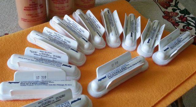

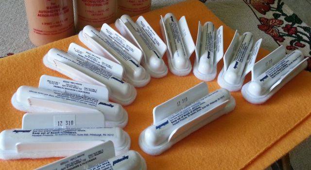

right on, haven't seen that before, I'm sold on the AquaPel application which seems to last forever.

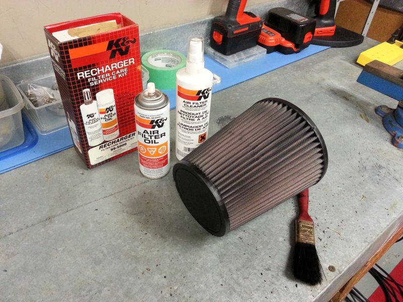

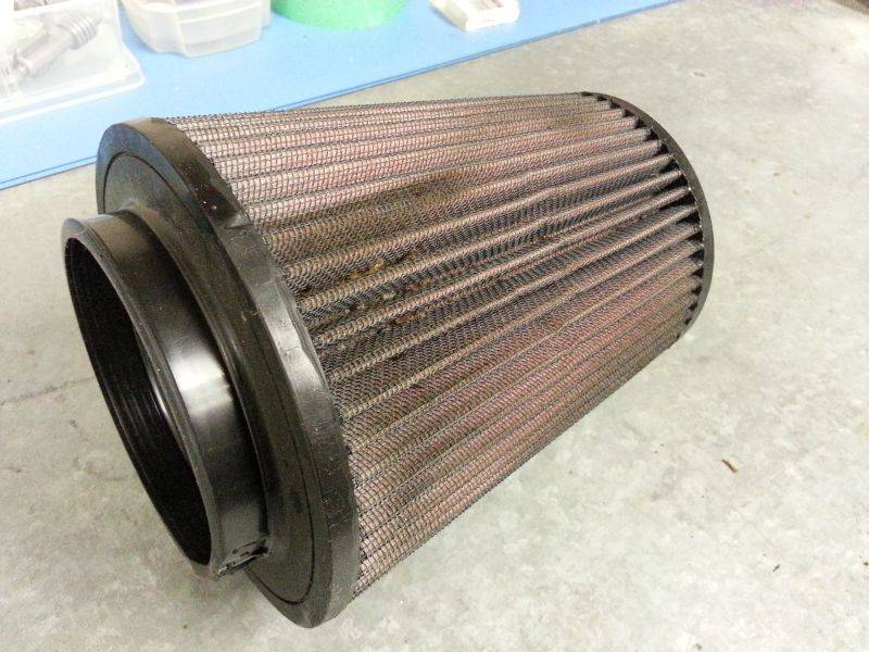

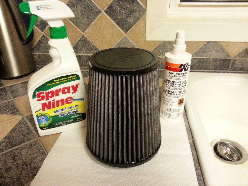

RECHARGE TIME ... K&N filter cleaning.
Bugs growing in it, yuck!
the K&N Air filter Cleaner, it don't work worth a crap.
Back to the old faithful and trusted SPRAY NINE tough on grease, making the job a breeze.
Drying ...

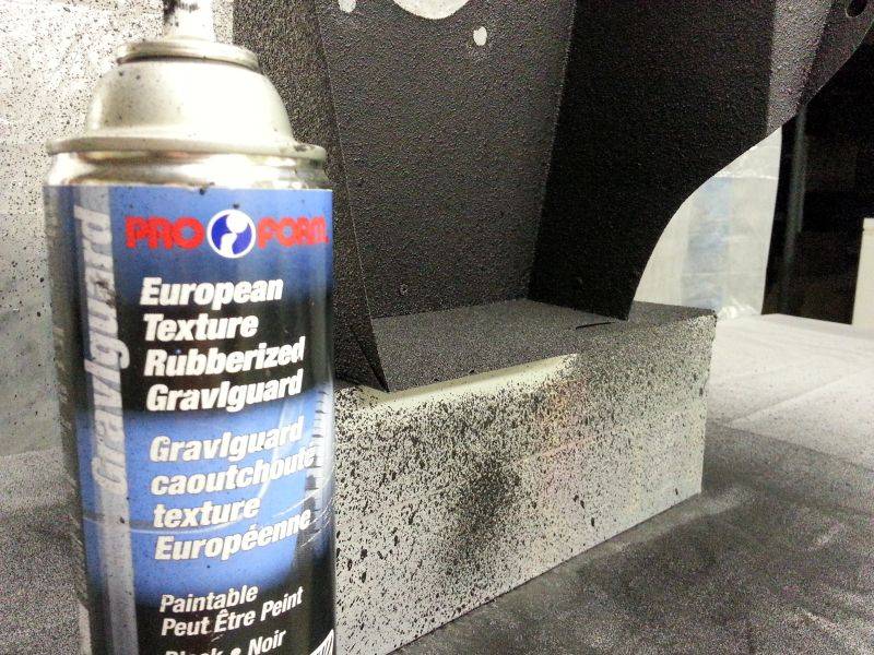

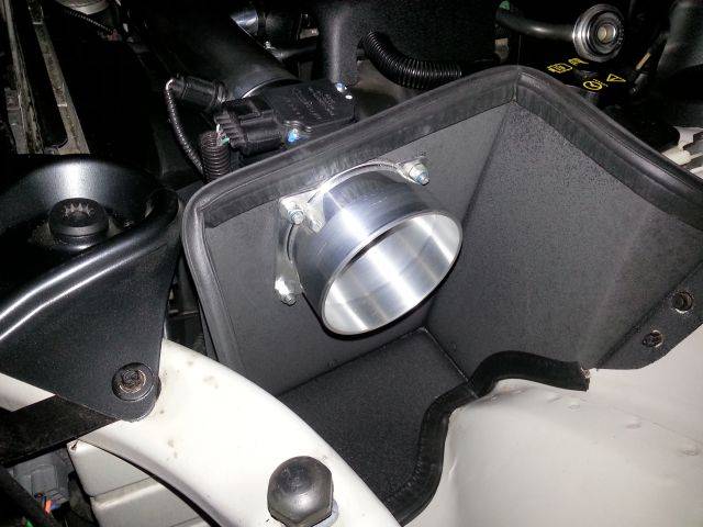

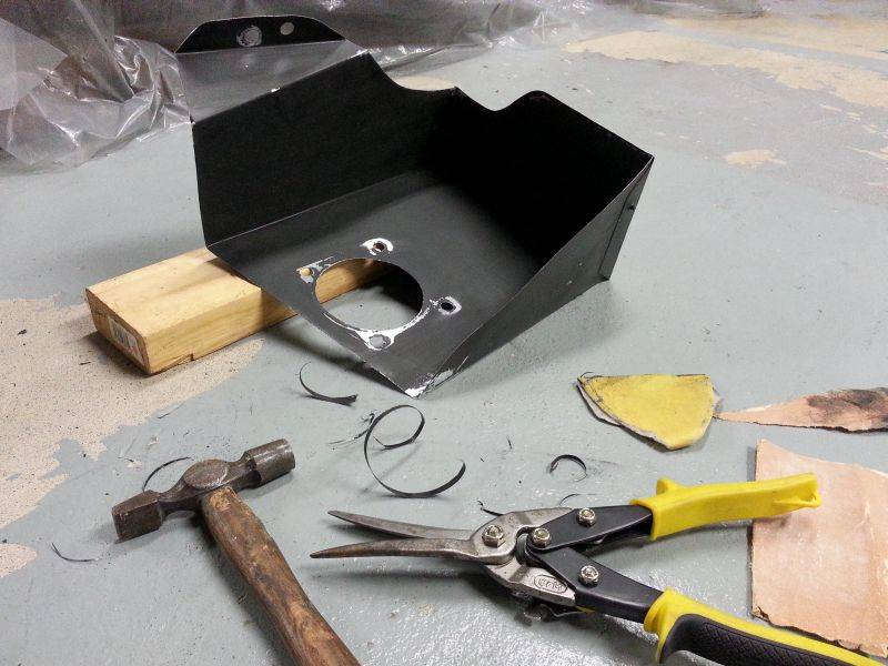

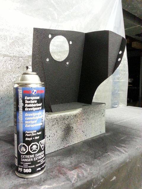

Re&Re ~ HITE Performance CAI heat shield
Bang, Bang Bang... snip, snip snip... Bang ~ needed to take just a little more off the top (again) to get it to sit just right.

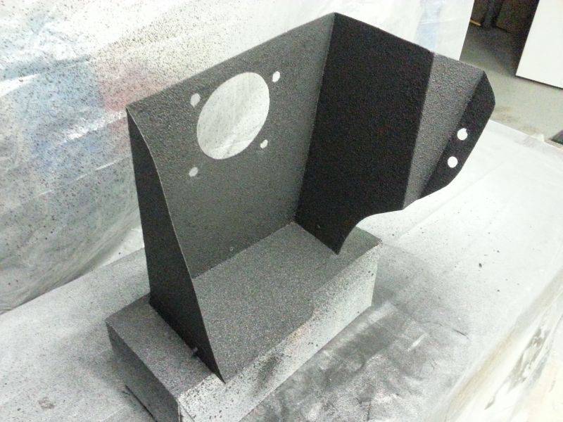

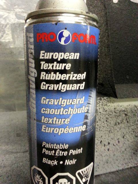

Bought two cans of this stuff from my neighbors hot rod shop after seeing how hard this stuff sets up, he had done the entire underside of a hood and frame rails on a custom rod, when I questioned why the hell he was using that rubber stuff. Oh but this is nothing but the best, it totally hardens and lasts forever, can be painted over, is flexible and withstands heat. Uses it on all sandblasted frames and such on his work. inside wheel wells also.
European Texture Rubberized Gravlguard PF 560 ~ http://www.proformproducts.com/en/products/info/?product=17&category=4
SOLD !!!, I'll take two cans please and thank you.
Should have done up the HITE shield like this since day one.

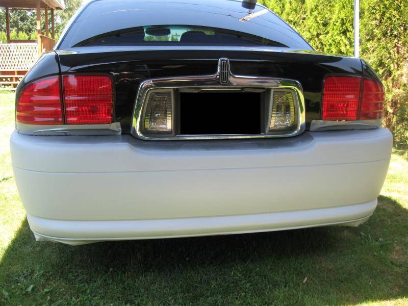

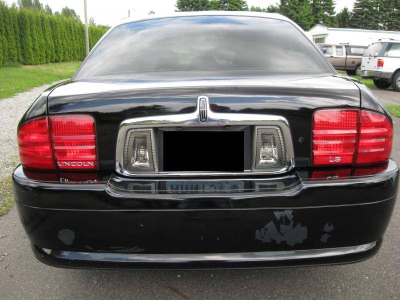

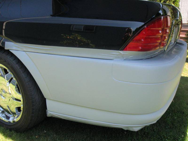

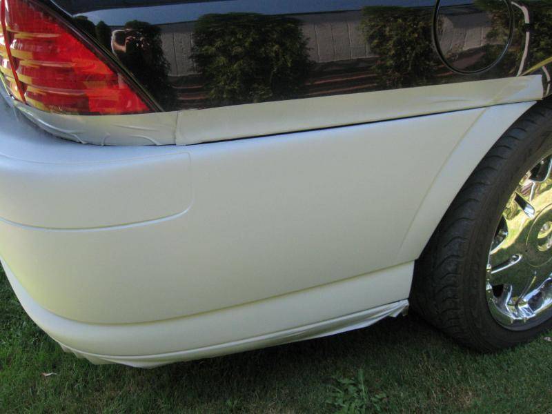

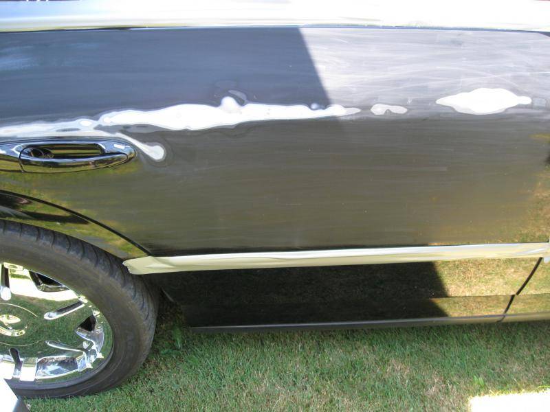

Are you preparing it for a shop to paint it or are you doing this yourself as well ?
looks good btw.
looks good btw.
I'll be doing all the work myself, in another life i was a body/paint man and there is a reason it was another life, this stuff is to much like work and I cant be having none of that:D. BTW Thanks!
^ kudos on doing your own paint work.

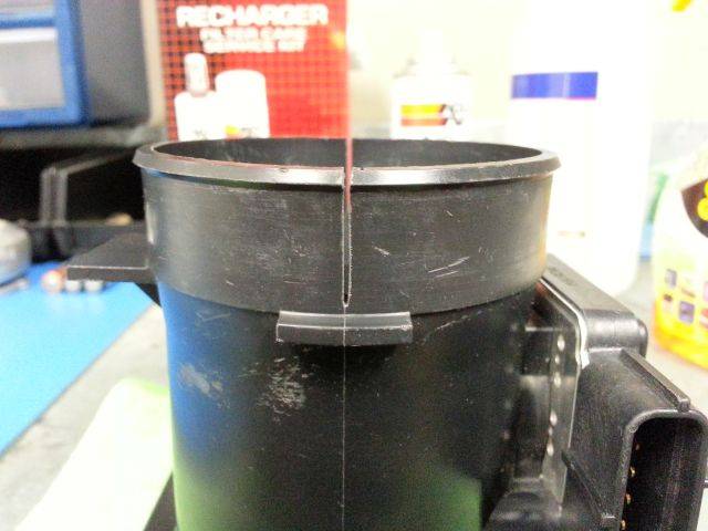

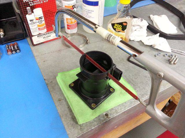

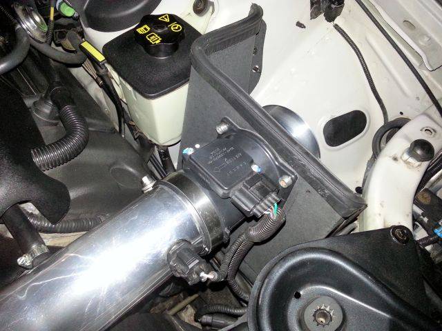

meanwhile back at the farm ... I've always had troubles with the MAF housing not clamping down fully on the ANSI intake tube, the diameter of the housing is pretty close to the same size as the intake and it's hard plastic so it doesn't allow for any clamping force to sit tight. I've had tape wrapped around the tube in hopes of getting better clamping force with the MAF housing but the tape just gets warm and moves around.
So ... as I have the whole thing apart this weekend for cleaning of the K&N filter and redoing of the HITE heatshield, I opted to put a cut straight down the middle on both sides of the MAF housing, thereby giving it a gap and allowing it to close tighter when locked down.
The idea seems to work perfectly.
K&N filter is still in the lab awaiting oiling this evening ... in the lab, hahaha!
