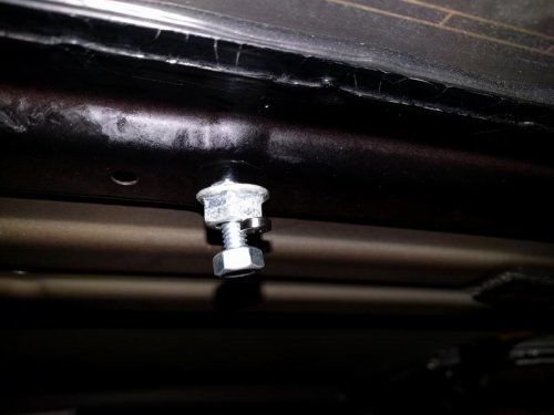

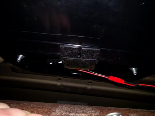

I've spent way too much time making some "perfect" mounting system for this. I have no idea how Gen 2s actually mount the high brake light, but in Gen 1s, while the holes are all there, there's nothing to bolt into besides sheetmetal that's the wrong size to simply thread into. 8mm and 5/16" bolts go through, 10mm and 3/8" are too big. So I spent a couple hours making a square peg fit in a round hole. Probably could have just dremeled a slot for a U-nut or threaded the hole for a 3/8/10mm, but this was more satisfying with no metal dust.
Good thing none of the velcro strips are attached to the headliner, otherwise I'd have to worry about the light not actually fitting

Some careful wiggling will get the 1/4"-20 x 1" bolts vertical enough to fall through
I used a 3/8" nut to act as a standoff so that as I tightened the regular nut down, the square base of the carriage bolt had room to rip through the round hole in the sheetmetal. The magnet helps defy gravity and keep the large nut (and later washers) on the downward-facing bolt

Installed. I love these JST connectors for RC car batteries. I put that **** on everything, especially LED projects in the car. I've also used carriage bolts for a lot of things, including "fixing" the bolt behind my license plate surround.

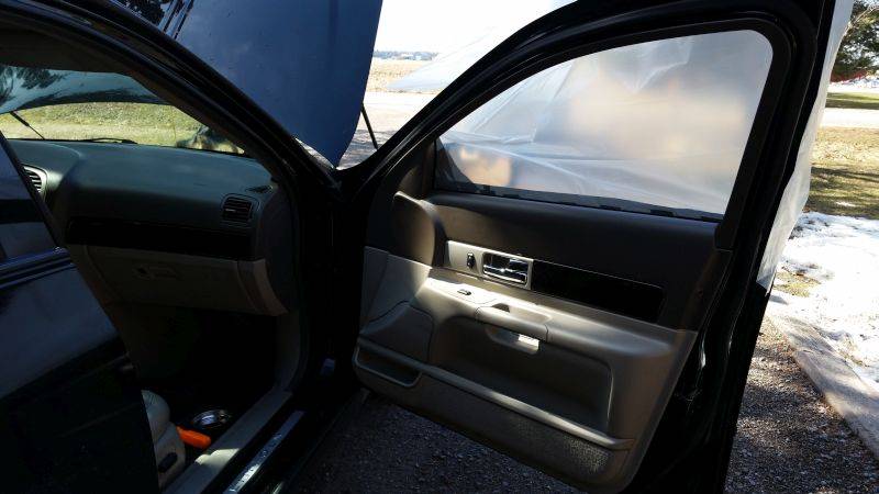

After much cussing and redoing it a couple of times (would not go down all the way) I finally managed to get the passenger side front window regulator replaced and operating as it should on my 04 LSE yesterday late in the day.
^ about to repair pic.
I did NOT enjoy this repair as much as I had hoped I would, however next time around on any other door I now know what's going on behind that door panel and probably would feel more comfortable and knowledgeable with such repair. Just need to clean a little blood of the inside glass and replace the band-aid on my thumb today.

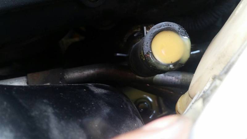

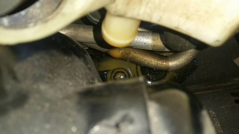

So... I ran into these issues today ... removing the actuator on my car...
1. This liquid. I was told it's a mix of oil and coolant. I don't have smoke or milky oil.
2. It smells and has a bit of hydraulic fluid in it.
3. Upon spinning the fan, the fluid came back out of the pump itself.

The raplacement actuator Head connector is from a v6. So now I know that the actuators are the same. I now have 3 of them, 2 from v8s and 1 v6. They all had the correct fluid coming out of the pump, reservoir, and actuator. So I assume those worked fine.

Well,yer makin progress,KidL. I doubt that fluid is anything but oil in the hydraulic fan,but I'll look it up. don-ohio (:^)
In the hydraulic fan,looks like JoeGr said to use Mercon V and another fellow said use Mercon,not Mercon V. I would use Mobil 1 ATF,myself. don-ohio (:^)
I used Mercon 5
And bought these in replacement of the other set I had
I'm sure Mercon V will be okay. But there is a stipulation not to put it in your power steering,so.............. don-ohio (:^)
Wait what.
Look at your owner's manual. Mercon V is exactly what you are supposed to put in the power steering. You are not supposed to use power steering fluid.
(Gen I manual says Mercon, but a later TSB says to use Mercon V now, even on gen I LS, and even in the hydraulic fan system.)
In my Ford manual for 04 LS POWER STEERING says on section 211-00- page 40, use MERCON or ATF, so I would say Mobil I synthetic ATF would be top-notch. Might be different for the Gen I ? don-ohio (:^)

That's fine,Loud................I suppose you didn't see that MERCON ATF was not unapproved in any way, the TSB was just covering the fact that Ford discontinued it?
So you don't HAVE to use Mercon V,but you MAY use Mercon V. If you have old Mercon on the shelf it's just fine.
So really,Mobil I ATF would be just fine,since it covers Mercon specs. AND they still make it. don-ohio (:^)
well as talked about a few (hundred) times before...
ford no longer makes Mercon and thus released a TSB about it only about 8 years ago.
TSB 07-1-7
http://www.revbase.com/BBBMotor/TSb/DownloadPdf?id=136391
