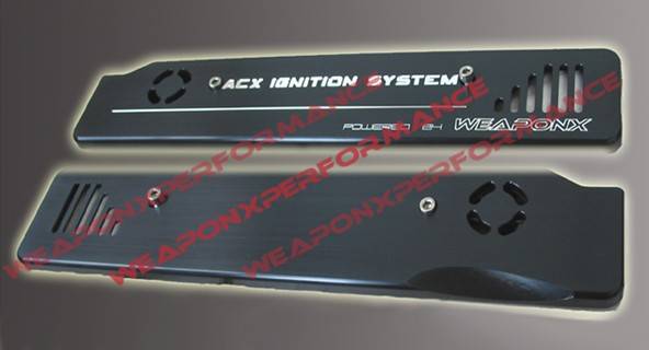

^^ while those are a "neat in theory" item.
They wont help.
It might remove some heat from the area, but I can assure you there is far more heat available to replace the removed heat.
Do you really want to turn your coils into radiators?
While I agree that a steady bake isn't a good thing
I dont think transfering heat thru the area is a "FIX".

My understanding is that the failures are almost always caused by oil or water getting in the wells. I haven't heard that heat is an issue. Therefore I would think that opening up the covers in any way would only cause more failures.
Aluminum and Copper are good metals to use for heat sink applications. I imagine it would be very costly to manufacture such a thing for such a small market that actually did a decent job of transferring heat. It would almost have to be extruded with fins. Possibly you could do a non-extruded cover and then affix extruded fins to the cover with some nice thermal paste in between.
All of the coil failures that I have had did not involve any oil or water. I am in a hot climate. I don't know if it's heat related or just manufacturing defects, but in my case (and I think most other gen II) it isn't oil.
I have had 2 coils fail, while mine is a gen 1 both coil were dry with no oil or water issues.
I'm in Saint Louis, not what I'd call a "hot" climate, but it does get hot here...
My coil failed after a race to 140. No oil or water in the plug wells. just replaced them all. Can they fail due to lack of fuel? The car cut fuel at a 140 right?
mine failed as well without oil or water in the well so i'm guessing it was heat.
you could probably mount the coil externally and run a short plug wire down to the plug. you would need a straight boot that can keep the water out of the well. i think there are plug wire kits you can build that would work.
the coils will still be hot though since there is so much radiant heat. i can burn my hand on my strut tower brace. that heat would probably just load any kind of heat sink you mount a coil to and deliver more energy into the coil than by just mounting the coil out in the open. its probably still better than being enclosed right over the cylinder. perhaps a shield could deflect some of that heat away as long as there's not a good conduction path to the coil. wrap them with fiberglass? i see it getting messy quick.
better yet, bring them inside the car with the AC running and run really long wires:p
If you find oil in the plug wells, the chances are very high that they're not long for this world, but plenty of coils have failed with no traces of oil in the wells. Nobody really knows if it's heat, design defects, a combination of the two, or something else entirely.
All of my failures, which total 18 coils havent been due to water or oil. Its been theorized that the covers enhance the heat build up and lead to there failure but from what i have been told is its just a design flaw in the construction of the coil itself. Also the rubber boots tend to get pinsize holes in them that allow for the coil to short out against the head itself. The entire engineering is horribly flawed and i really dont think there is a definate fix for this problem. Its basically drive them as long as you can until the next misfire which is inevitable.
Ok froggy dont hate on me for this, but if it is heat that kills them could you possibly add a suction and a push fan to each cover such as a small computer fan, we usedto do this to amps so we could bridge them way down and not melt the boards.:cool:and dwell would have to do with setting a point style ignition system. wheres my 10$'s kk
When you really get down to the whole venting thoery you gotta take into effect that the underhood temps are extremely high. Venting covers could possibly just allow more of the excessive underhood heat to make its way thru the vents to the coils. I think a different approach could be to somehow vent the actual hood itself to allow the engine compartment heat build-up to exit and thus keep the underhood temps down and provide airflow. There are multiple cars that use hood loovers to do just that....remove excessive underhood temperatures, some are just cosmetic but some are actually functional. If the underhood temps can be lowered then the heat surrounding the coils/covers would also be lowered. All in all i think its just a losing battle all the way around.
that actually might be a good idea, because heat rises, so if the heat has a place to go, it wouldn't get as hot in the engine area, especially considering everything important in there is made from plastic and was designed to break so people would have to pay big money to fix it
hood louvers would be a great thing to do, thats next haha
