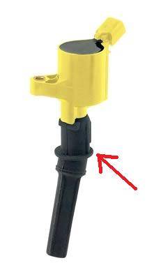

if the car does not have coil covers - the boots usually have a flange that 'seals' the spark plug well from letting water get down in there. THe LS V8 boots do not have this - so you would open to that issue.
you can see the flange that seals against the well on this pic.

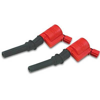

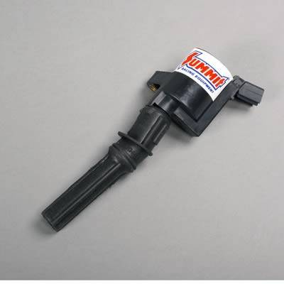

I hate the Accel stuff personally, I plan on going with the Summit brand coils. which are most likely the MSD ones re-branded, Summit is known for this quite well but mainly uses Mallory for their ignition components but since they dont make 4.6 COP's they rebadged the MSD ones. Heres pics of the two, you can decide.
Thats funny..............the top one looks EXACTLY like the units in my V10 F250. Well except mine have ford decals on top of them.
Alot of stuff that you spend your money on these days goes to the company or "Your paying for the name"
And which is even better, the Summit brand/name is backed quite well, Ive never had any complaints or problems with their products or customer service.
