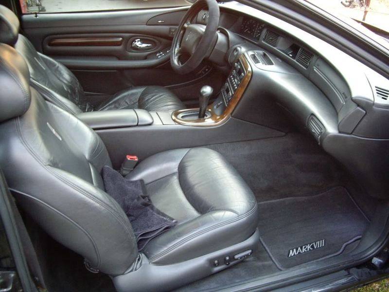

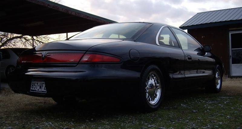

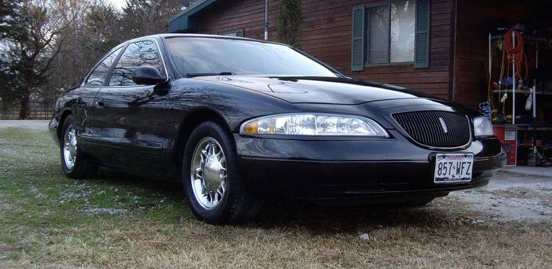

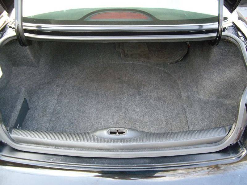

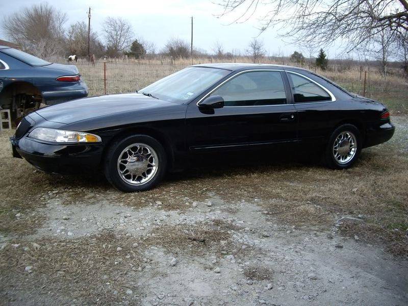

Was able to get some good pics today after a minor clean. Still need to clay, cut, seal and wax it but thats for another day.

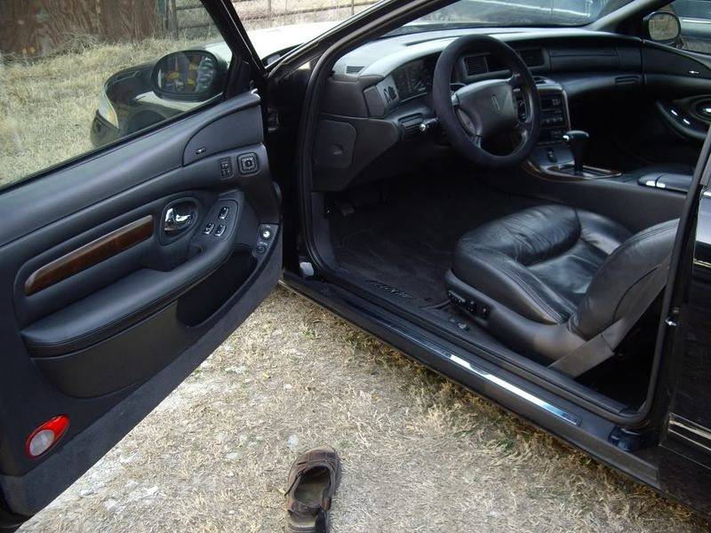

Today just removed all the extra BS wires in the car and figured out why the blend door is broken. Can move the door by hand and the motor kinda moves it so the shaft is cracked. Makes it fixable though.
Car runs so freakin nice though. The motor is dusty but not grimey. No oil marks or built up grunge. Gonna degrease it and hose it off another day.
Looks to be in the same condition as mine body and interior wise. Mine has a lot of little dings like that. They aren't immediately obvious because they don't come to a point, they are soft and don't have scratches. They piss me off! I like the octastars sometimes, in this case I do, but I wouldn't want them on mine it's odd...
what is up with the driverside exhaust tip it looks like something smashed it forward 2 inches?
It looks like someone backed into a curb. It will have to do for now. May get fixed when the x pipe is installed.

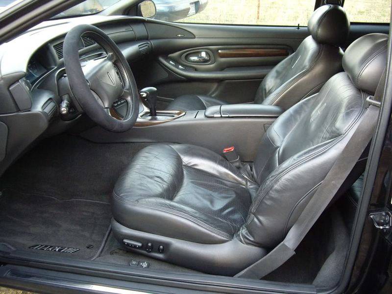

It took alot of scrubbing and wiping, and more scrubbing and wiping. It is deffinatly the "little old lady" car...one that had a little ankle bitter co-pilot, I managed to get all of the hair out of it, conditioned the leather and started on the carpets

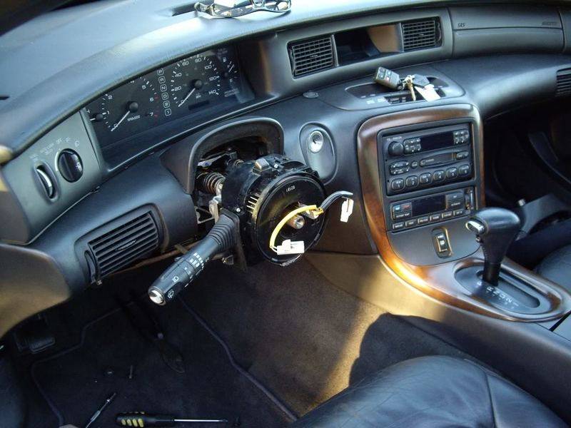

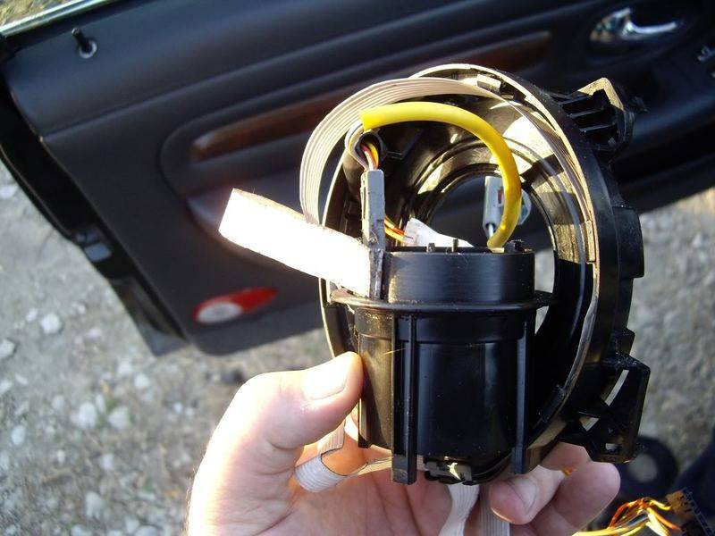

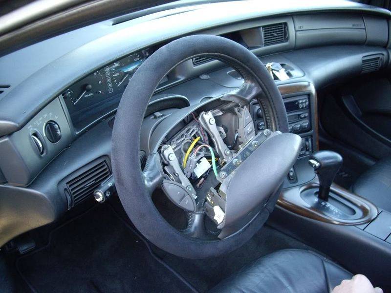

Once I get a clock-spring i can finish making her legal

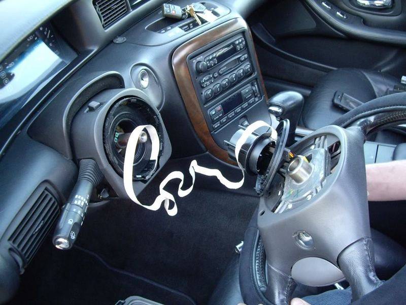

Sappers new clock spring showed up today. Thanks Jamie. So we installed it. Not a hard job and took about 25 minutes to do.
Junk old switch:
Found the break:
And slapped in teh new one. :)
yeah if some dumbass turns the steering wheel while the tie rods are undone, or if a new rack is put in, or if you change out the column. usually they dont go bad if nothing has ever been touched. i broke a few in the past not paying attention lol!
Junk old switch:
Found the break:
