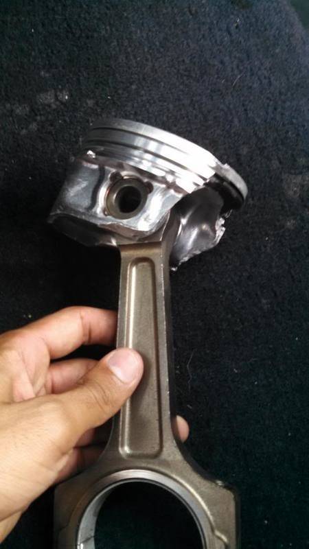

Some progress...... I guess I was enjoying that turbo too much. Went and picked this trophy up from the shop.
HOLY F.M.R. man!
That truly sux.
I haven't pulled the motor apart, and I'm too lazy to dig through the thread, are those the stock rods? Those things are beefy. Any idea on what lead up to the departure of 1/8 of your piston?
Yeah that's a stock piston and rod. Well the Turbo added more stress to the engine but I wouldn't really beat on it either way. Besides full throttle during the dyno, I had only floored it a handful of times and besides that mostly 3/4 throttle when I was having fun in her with the turbo. Getting forged internals, the pistons will be custom and the rods are off the shelf rods that were found to be very close to the ls rods. The rods will need minimal machining to fit. The rods would've also been custom if no close match were found but a similar rod was found saving me money. I will be running 10-12 psi and the piston/rod combo should be good for 25+ psi so that won't be an issue after they go in. Need to get a new tune after this and will enjoy it until the next thing breaks, then I will upgrade that too, trans probably? An LSD will also be installed when the new motor goes in, I've had the parts for about a year, just needed to be installed.

It seems my post from earlier today did not go through. It said something along the lines of, I think the piston failure in my case had another culprit since QuickLs hit about 350whp on a supercharger, 5 psi was suppose to be on the safe side
I just saw the dyno plot on page 18. The engine was going stupid lean and it probably detonated itself to death. Look at the afr plot on the bottom of the picture. Toward 6000 rpm it's way above 12:1. It looks that they (the tuner) lifted the throttle before the engine reached 6000 rpm. You ran out of fuel - injector or pump or both. I can't seem to recall if you posted the injector or pump flow rates. The intercooler also seems too small. Some of the older turbo cars would run with 10:1 afr from factory, and lose power doing it, in order to keep the combustion cooler. It appears to me that it was a combination of factors - high compression, poor intercooling, high AFRs that lead to the demise. I would advise that a dual wide band AFR gauge be installed as well. I know that eclipses came with 450cc (~42lb)injectors (about 200hp per 4 cylinders) and evos with 560cc injectors (officially 276 hp per 4 cylinders) from the factory. It's not unusuall to see a street driven turbo car with 1600cc or even 2000cc injectors if runnig e85 (awsome fuel for high power turbo cars). Good luck.

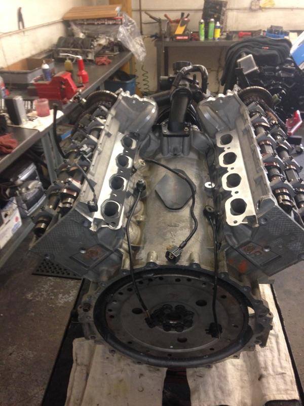

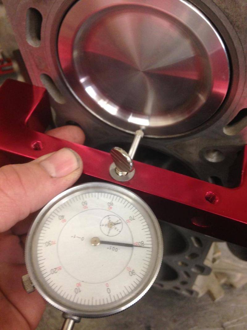

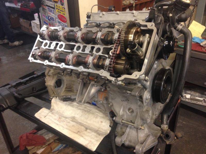

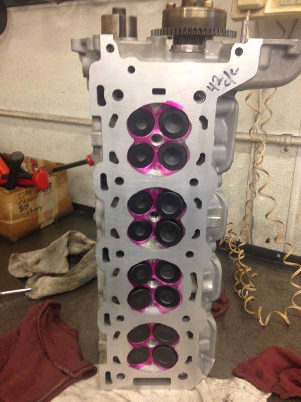

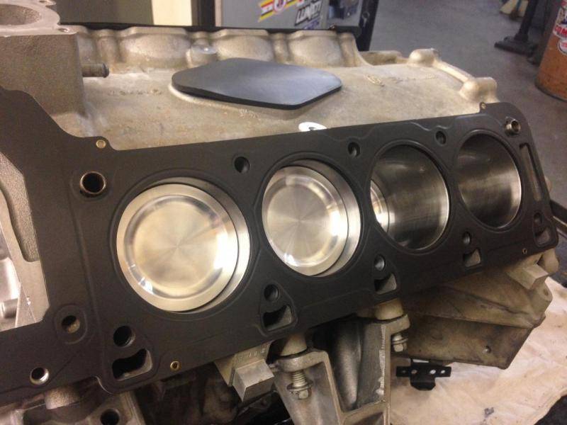

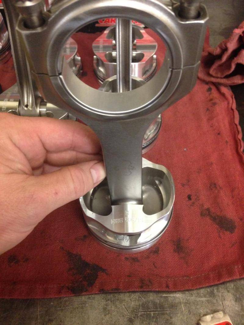

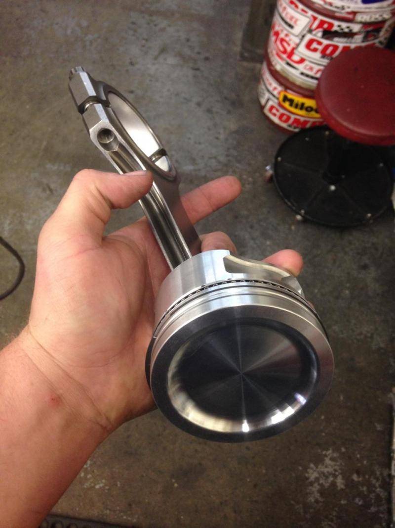

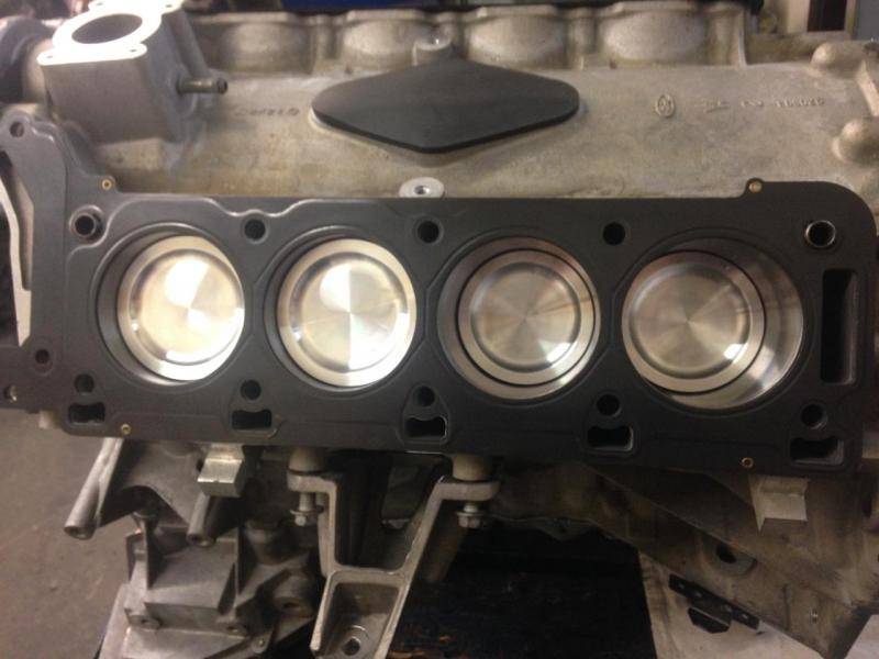

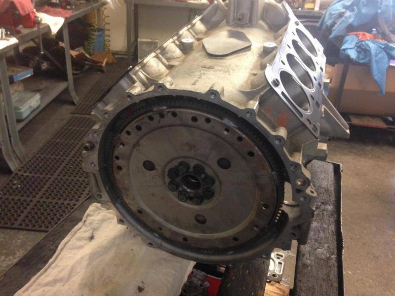

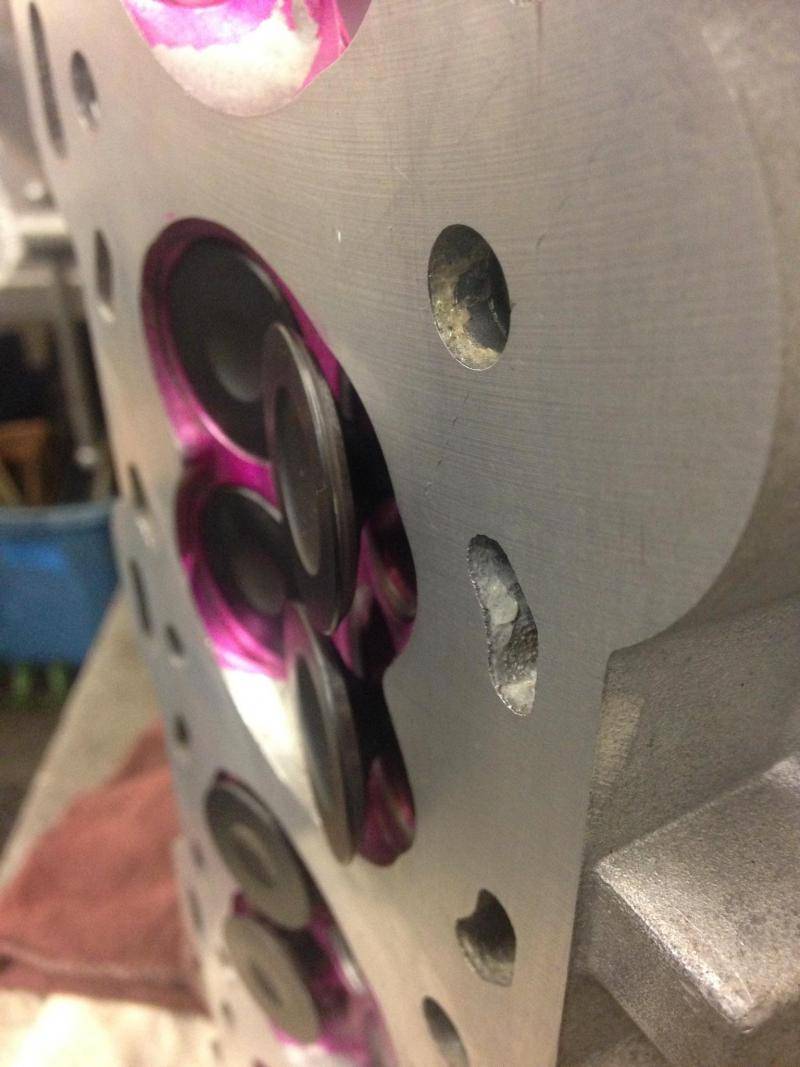

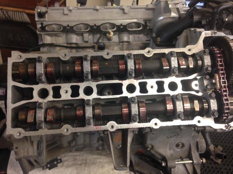

Some pictures from the engine shop from a few weeks ago
