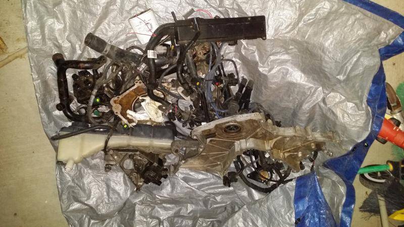

Here are some pictures
Thanks everyone. now I need to get everything cleaned up. I will be trying to buy that oil pump for $250 and hopefully I can afford some aviator c heads and new springs next paycheck.

I could not find any 2004 heads in your area. Shoot I think I posted wrong link to that 250 dollar pump its a post from 2012!!
you bastard! im super jealous of your score.;)congrats dude selling it must have recently got hook on drugs or something cus $150 for all that is def crackhead prices

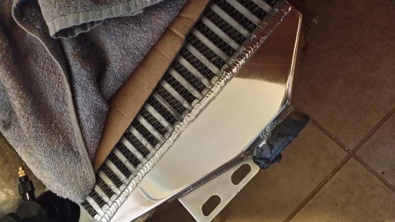

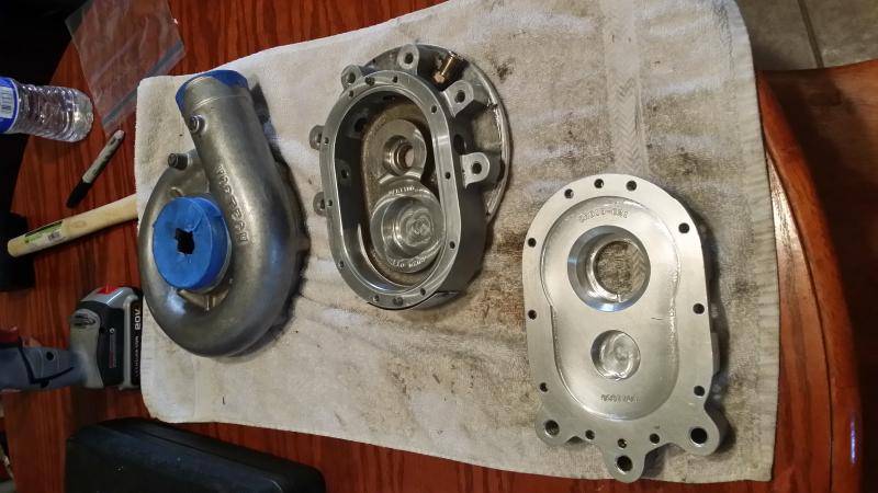

I finished polishing my intercooler and now I just broke down my supercharger so I can polish it next.
