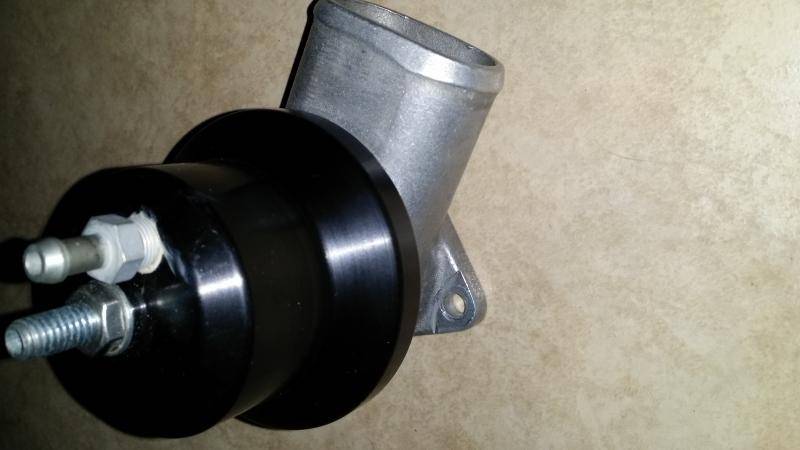

Thanks for the comments. I just picked up a vortech by pass valve. I will post some pics soon. Any advice would help also.

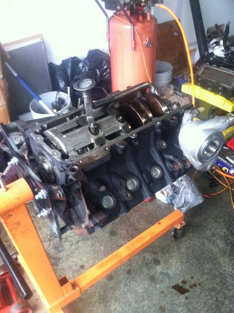

Here are pics of the block I picked up. 2003 cobra shortblock. bored .020 over. Clevite rod and main bearings. JE pistons with valve reliefs,8.6:1 compression *if used with 52cc chamber heads.floating wrispins. Manley/SVT H-beam Robs with ARP rod bolts. 2003 balanced cobra forged crank.

Need a '97-98 Mark VIII oil pan and pickup tube to work with the HO oil pump and your stock K-member?
Honestly I don't know. I'm just stacking up for parts before I take it to the shop for the build. Hopefully someone will chime in and educate me.
You'll need either a MN12 or FN10 oil pan to fit with the stock K-member. The best option of the bunch is the '97-98 Mark VIII pan, as it offers an extra quart of capacity over the MN12 pans and it also has a reinforced gasket flange (an improvement that was added around '96, IIRC).
In order to use the HO Cobra oil pump with a MN12 or FN10 oil pan, you'll need a pickup tube from a '97-98 Mark VIII.
I figured I'd bring it up since I saw the Cobra pickup tube and windage tray in place (those won't work with a MN12 or FN10 pan). If you need the correct pan and pickup tube, I have a extra set here. Just shoot me a PM with your zip code.
Okay cool thanks a lot
