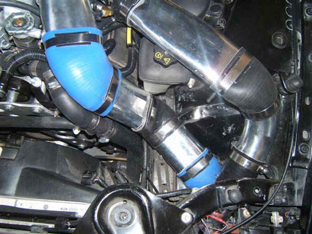

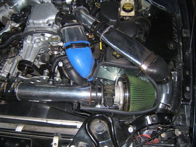

Here are pics of the engine bay....
- the output form the SC goes down and under the intake filter
- the 'cooled' return come into the engine bay and then around the end of the filter then over top of the shock tower then into the output plenum
BTW: don't worry - the blue elbow will be replace with a black one once they have them in stock....

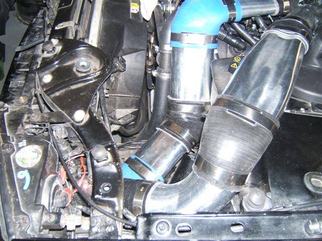

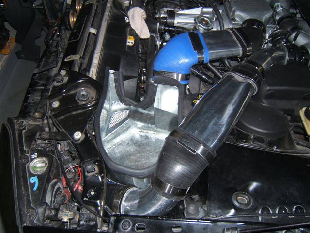

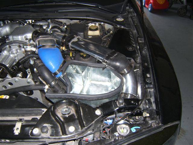

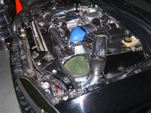

update - you can tell from the pics in my previous post - I had to rebuild my airbox. It is a must-have since my hood scoop will let water in unless I re-direct it.
The first two pics are of the space I had to work with.
The next two are with the new box installed. There is a a hose coming out the bottom to drain the water downand away
The last two are with the intake installed
I am almost finished with the lid and I'll post pics of it.....
