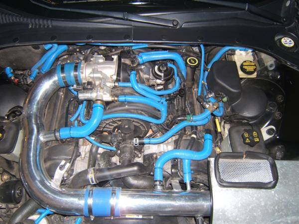

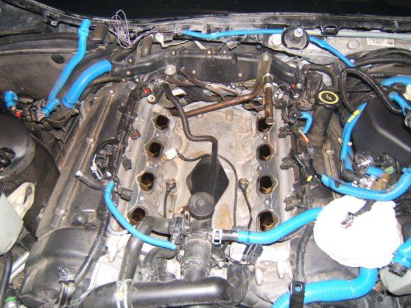

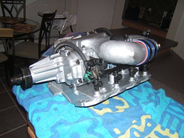

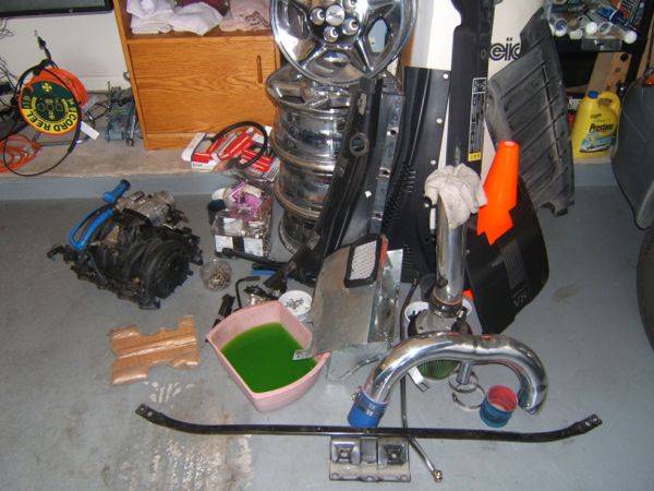

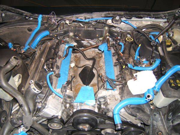

so here is the progress in 2 1/2 hours....
stopping for a beer...
ok - finished beer
- removed the cooling tower
- now to work on the new intake

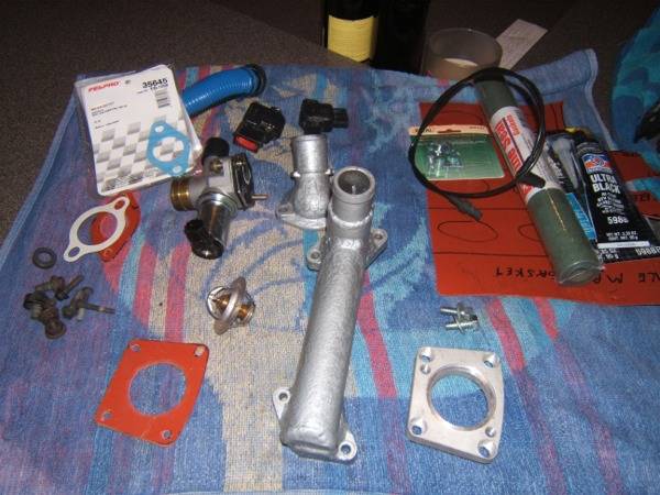

ok - here's where I am leaving off for the night.....
- injectors, fuel rail and mounting moved over to the new manifold
- test fitted all the cooling re-routing, bought gaskets
- transfered the LS iac valve onto the new set-up, built block plate

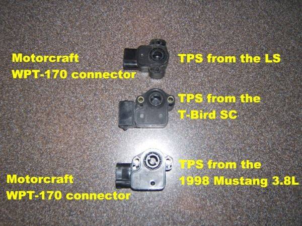

- worked on the TPS..... gonna need some work... the LS uses a typical late model Ford TPS with a WPT-170 connector - but is mounted vertically.... I need one mounted horizontally..... the search is on...
Fixed the TPS issue - the 1998 3.8L Mustang uses the same TPS as the T-bird SC but has the WPT-170 connector that the LS uses....
