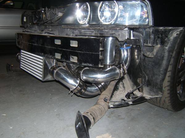

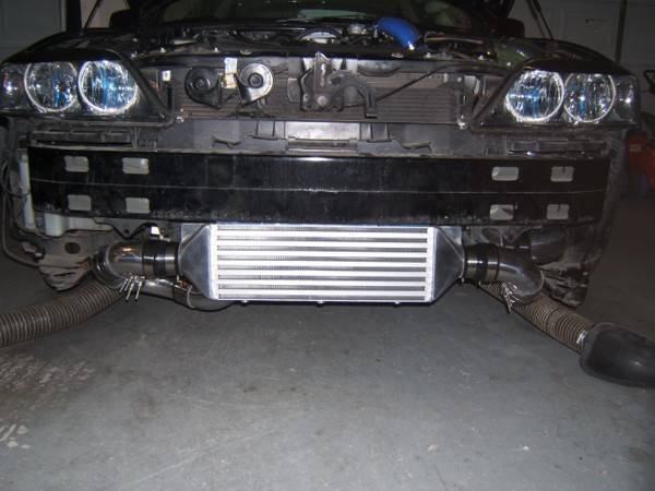

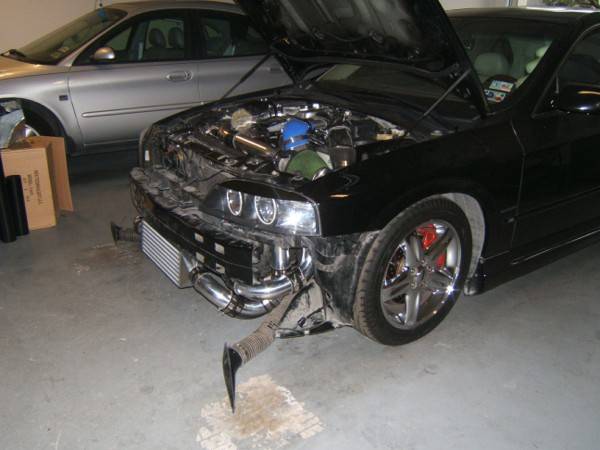

Here's pics of the intercooler install.
left to do:
- reinstall the front bumper - minor fit and trimming
- rebuild my cold air box to match up with my hood scoop
- start it up...

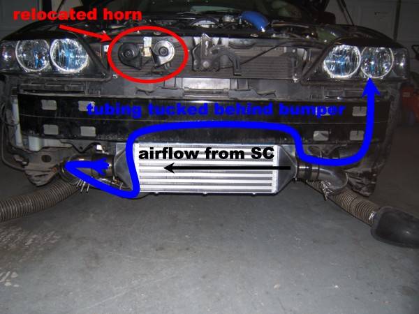

Here's pics of the front of the car.
- the short side is from the SC, leaving the return side, longer travel through the tubing, to help add more cooling.
- the tubing runs behind the bumper as to not block any more airflow to the rad
- relocated the horn from behind the bumper to behind the grill

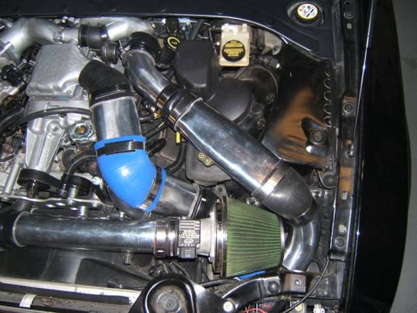

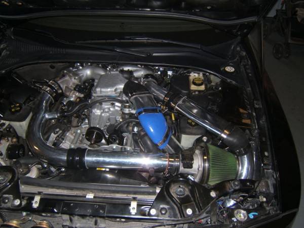

Here are pics of the engine bay....
- the output form the SC goes down and under the intake filter
- the 'cooled' return come into the engine bay and then around the end of the filter then over top of the shock tower then into the output plenum
BTW: don't worry - the blue elbow will be replace with a black one once they have them in stock....
