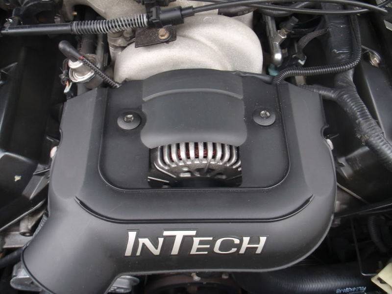

Great advice thanks guys. Does anyone know where or what type of fitting is needed to get that top bolt out of the cover that goes over the coolant tubes. It looks gigantic and square. Is that a Ford specialty tool, or can I get that basically anywhere?
Oh, and KK I'm definitely not trying to pull an abelincoln. Every time you guys have said something was wrong I followed your advice. Half the time It ended up being something else, but it's hard to diagnose things over the internet so no biggie. My point is I've followed advice nearly every time on here. I just try to delve deeper into the problem now to ensure I don't end up with any more extras lying around ;)
either im not awake yet...or i simply cannot figure out what your talking about.
oh..your talking about the 97 only alternator cover?
would a 3/8s ratchet take it off or is it 1/4 inch like the crossover tube plug?
can you snap a pic?
can you snap a pic?

The beauty cover takes a 1/4" extension to remove.

DLF I posted the pic before I refreshed the page so I didn't see your response. Sorry about that, I'll go get a 1/4" extension.
