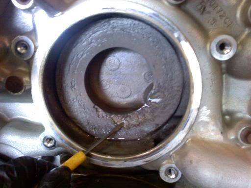

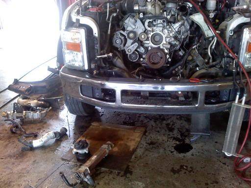

This was sitting in my main bay... 6.4L Powerstroke that filled the crank case full of coolant.
There was cavitation from the water pump and it made a small hole where the screwdriver is right into an oil passage.
I drained 9.5 gallons of oil/coolant from the oil pan, the oil in the engine looks like a black milkshake. The engine is only supposed to hold about 3-4 gallons of oil.
