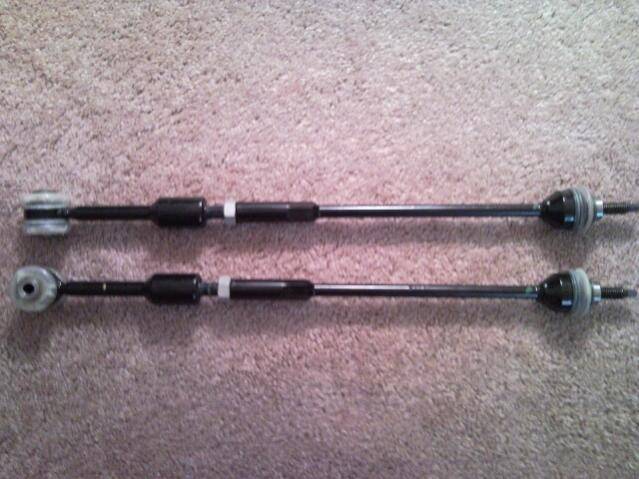

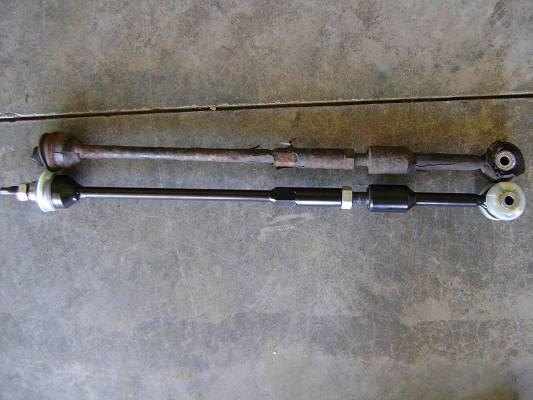

I received mine from Max today. Here they are:

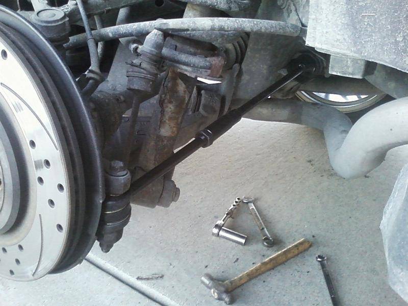

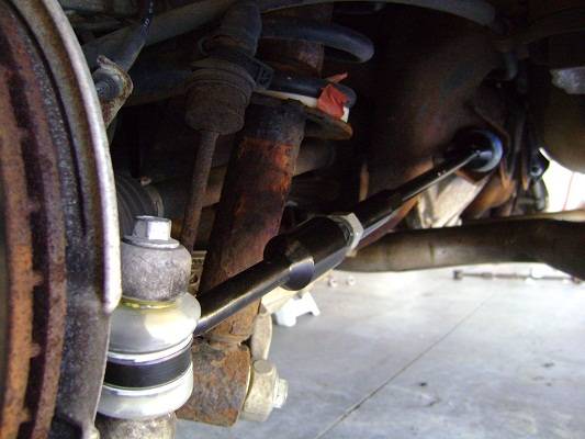

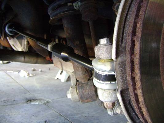

Installed mine new toe links last weekend. Had my tires balanced, rotated and had the car aligned. It handles and rides like new again!

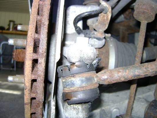

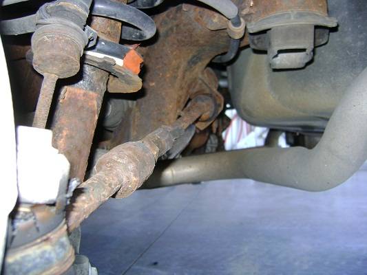

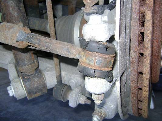

4th picture from the top, boot is ripped on your sway bar end link. I'd probably add it to the list of things to replace. As rusty as they look, I can't imagine they are in good shape if the boots are ripped.
I so bad need to do this and the rear end links also. Did you do it yourself?
I replaced them myself. My advice is to have an electric body saw to cut the old one out and buy some new nuts for the new toe link. The bolts close to the rotor were easy to remove but the other nut was a pain. Easiest to cut it off.
Thanks for looking at that. I was debating whether or not to change those as well but decided I would wait on them. They are on the list to replace.
Putting new parts in there makes you want to replace everything just based on the contrast from rust to new. :p

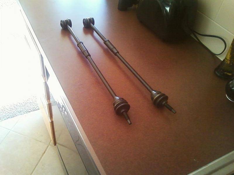

Welp, mine showed up today, albeit the non-steering variety.
Hopefully get these suckers installed this coming weekend.

Just out of curiousity, are those greasable? Or non-greasable like the OE ones? I'm guessing they aren't greasable, as people would probably blow the boots out.

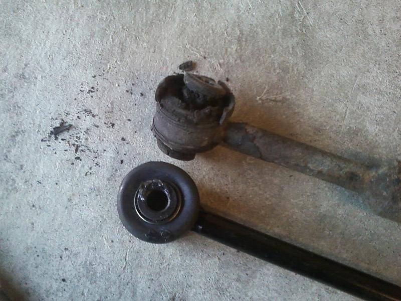

Installed the bars today. I would say that it eliminated about 90% of all the vibration I was having. There is still an ever so slight vibration in the steering wheel but not at all like it was. The drivers side bushing that connects to the knuckle had about an 1/4 of movement it was so shot.
