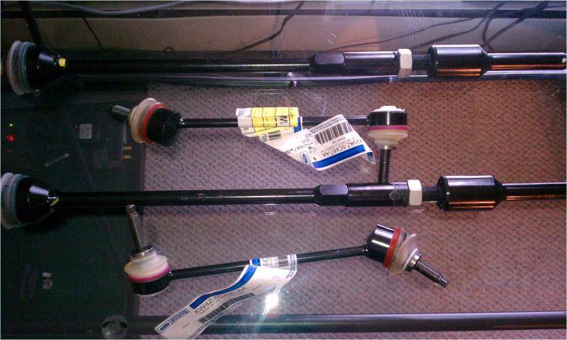

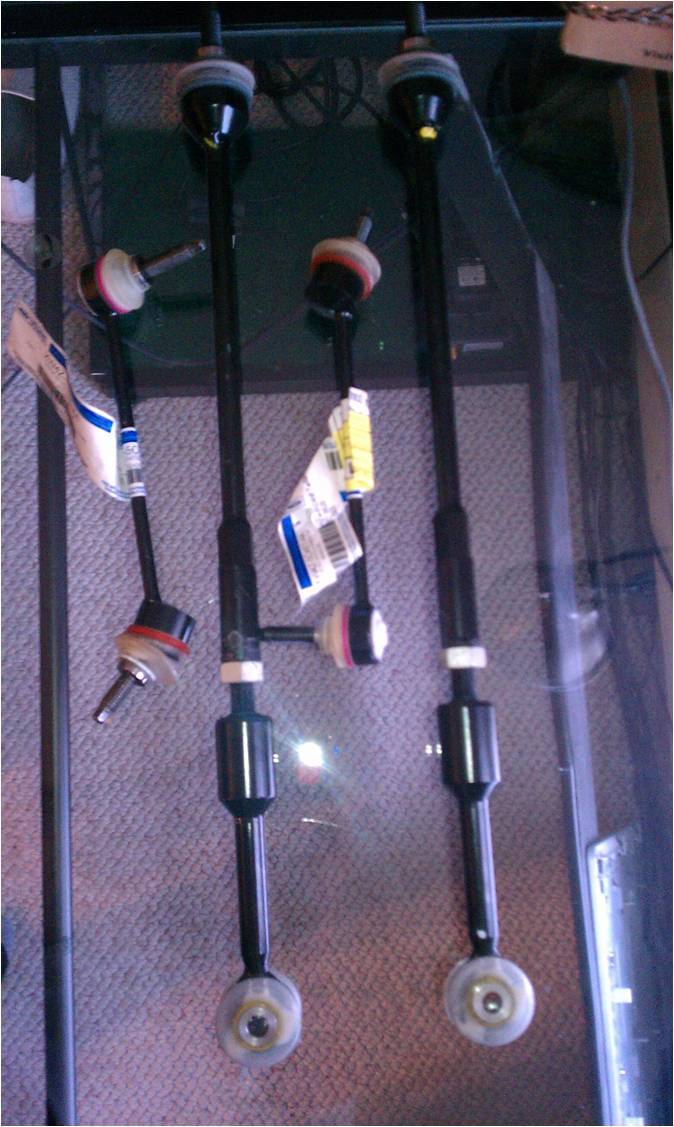

I took the plunge on the toe links and sway links. I have a bad vibration at 60 to 80 and is considerably more noticeable when running my 19's vs. my 16's with snow tires. I really hope this takes care of the issue.
UPS came today and dropped off my Tasca parts. Not sure if I'd order from them again or just stick to Max...
Oh, and I got my Eibach Camber Kit too

I believe for everything shipped to my door it was like $270.
I kinda wish I woulda seen how much Max sells the stuff for because Tasca shipping/service is tough to deal with IMO. They also put the wrong address on the box (yes, I gave the correct information - I checked my order confirmation) which delayed shipping further.
