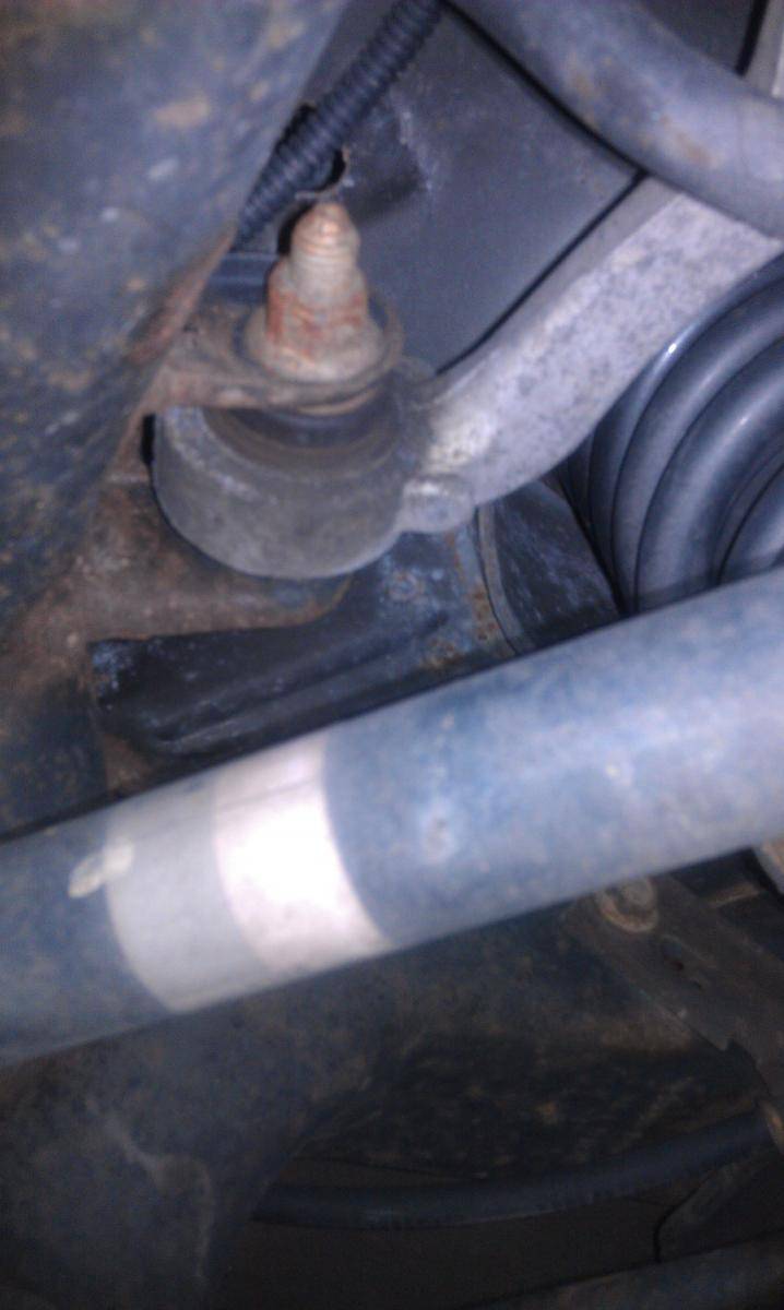

I just had a chance to get my car on a lift and snap a picture. I think Bull asked me the other day, sorry took so long. Anyway, when the guy at my job did my alignment he removed the rear upper control arm bolts from the frome side and elongated the holes in order to be able to adjust camber in spec. I did not even ask him to do it, he is just a alignment nut and wanted it correct. I have eibachs on my car and alignment specs were perfect. As you can see by the picture there is a mark where nut was originally tightened and there would not be room to go any more, at the point if you needed more I would say fabricating longer tabs might work.
It took my guy like 3 hours to do it, so if you have to pay someone it would be costly. If you can do it yourself much better option.

from when I looked... the rears have more room to be elongated without running into issues, but the fronts are stuck as is. I am working with a few companies now who I've dealt with in the past with similar products to get a tubular upper arm built.
