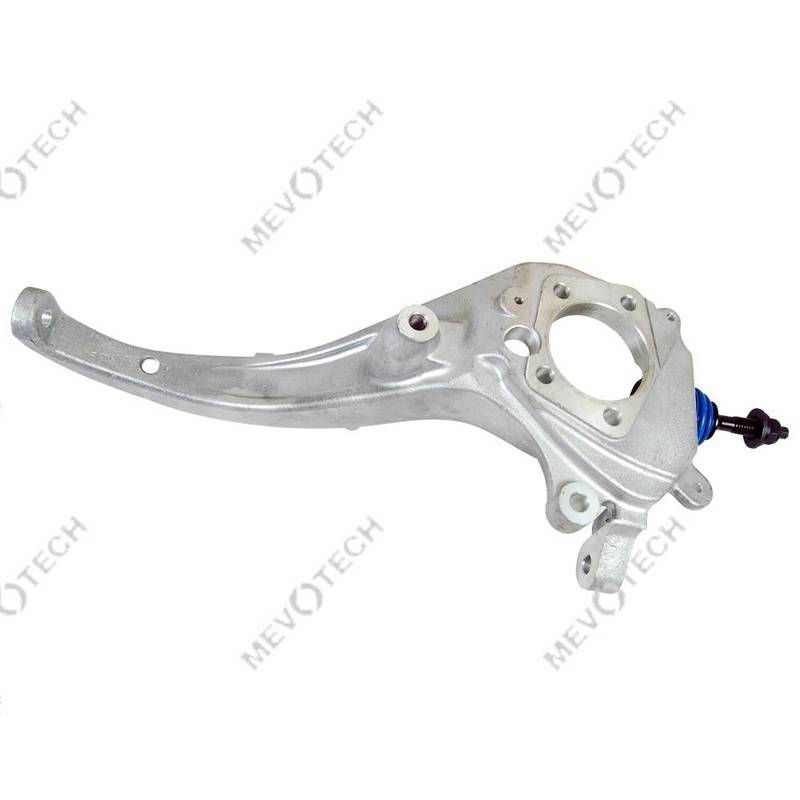

Why would you need a modified upper A arm? A new steering knuckle looks to be the way to lower your car and maintain suspension geometry. And, the same steering knuckle that fits the LS also fits the 2002-2005 Thunderchicken and the 2000 - 2008 Jaguar S-type so you might look to see if anyone makes a lowering kit for either of these cars. If so it should work on the LS as well. If you know anyone with a CNC machine, take them a set of steering knuckles and have them move the part the large round hole is in however much higher you want the drop to be. This will bolt the wheel higher on the control arm which will set the car lower to the ground. The only negative is you will have to have wheels that will clear.
If you don't care how it looks, you can have someone that can weld aluminum take an inch or two out of the top of the long part and install a spacer at the bottom. You'll also need to make sure the steering rack attachment point is at the same spot it is now to avoid bump steer so it will need to be lowered the same amount as the other parts.
No one makes a modified knuckle, not to mention, custom CNC work (you can't just elongate the hole on a cast aluminum piece) is considerably more expensive
Than having custom tubular steel upper arms built.
To do a modified knuckle, you'd have to have someone cut a new knuckle out of solid aluminum. Unless you find someone who has the OEM molds and is willing to modify them, and that company would then have to cast entirely new pieces.
