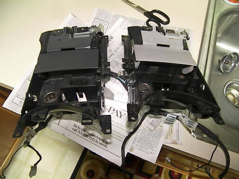

I performed surgery on the cup holder. Bill, I was mindful of the little spring for the ashtray. I am however curious about this cover for the cupholder. It don't look as if it can be removed. It's a whole assembly that rotates down when the button is pushed.

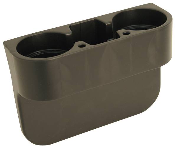

the ash tray doors are held on with a phillips screw through each side, take the screws out and remove the lids but there are springs in there too, its not easy. why dont you just go to walmart and spend 4 bucks on this and shove it between the console and pass seat. this is what i use in my 97, my cup holder is perfect and staying that way, and to stay that way you CANT USE IT. it was the absolute dumbest design ever and its basically there for looks. i like my el' cheapo much better!
I got the ashtray removed. I am concerned with the cupholder. I've removed the leather cover. The long flat piece that is connected to the cupholder, looks a lot more difficult to remove.
Yeah Greg, on the side there are these plastic dampner things that just look like screw caps. You have to pop them out and remove the phillips screws. Just keep looking for screws and every time you find one, remove it! :lol:

OK Bill, I think we're lost in translation. I've totally removed all pertinent screws. I've removed the leather cover from a top the cup holder. The mechanism that the chrome button is attached to,extends out past where the leather cover will be put back. So I will have to paint the charcoal one. There does not seem to be any easy way to remove it with breaking it.
Send them both to me. I'll fix up your grey one for the price of letting me keep the black pieces. I did this for member "mark0101"

Well, I hope it looks good. That's really too bad that you did that. It's so hard to come across good black cupholder pieces.
Oh well, it's good enough for now until I find an entire Graphite center console complete. One of the tabs is broke on the end where it slides in behind the radio, (probably because they couldn't figure out how to get the console out) Then they drove a screw in the corner to secure it. One thing is for sure though, this Mark was already in the shop for the blend door. The dash was pulled to do something back there, and when they buttoned everything back up they didn't put back the the two nuts behind the radio.
