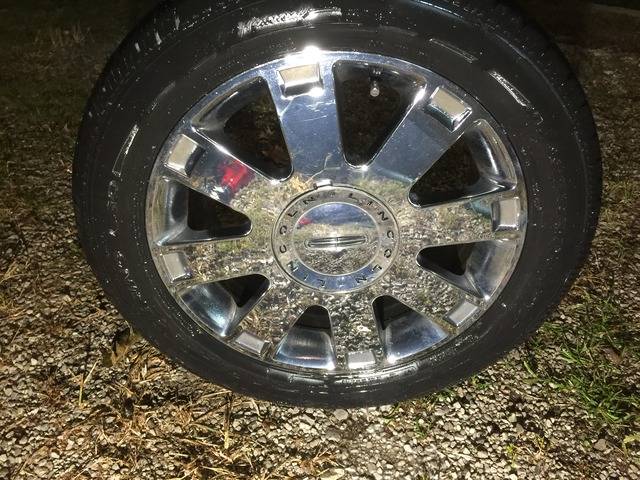

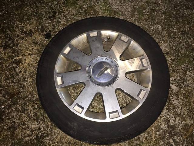

Anyways, bought some Meguiar's chrome wheel cleaner (Can't remember the exact name, its in a magenta-ish bottle) and took my front wheels off while its parked in the garage dismantled.
Wanted to see if there was any way to save my wheels. The faces aren't bad, but there was so much brake dust just baked on. Regular cleaning and scrubbing did NOTHING.
I sprayed this stuff on, did a little light agitation with a bottle cleaner type wand, rinsed them off, and they are so clean now. Doesn't fix the chrome peeling, but its still night and day. Can't wait to fully clean and detail the car once its back on the road and get some nice pictures.
The pictures really didn't show how bad the wheels were before. Maybe it was just the light and being dark outside, but they were nasty.
