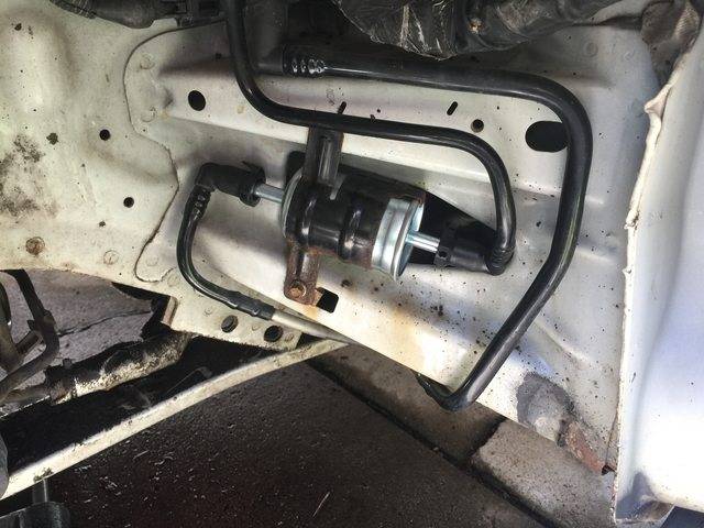

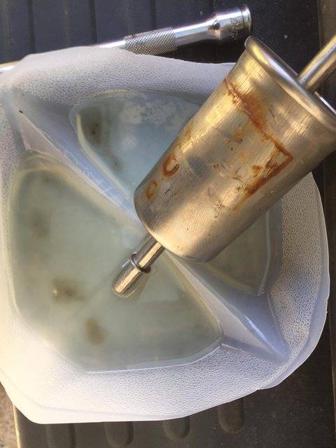

Coolant is done, fuel filter is done, we're golden.
Watching the temps on my phone, its showing the coolant right around 205-210 on average with no heat/ac on. With heat, it stays closer to 200, sometimes even a bit lower. (Idling in the driveway, 80ish degrees outside)
Fuel filter spit out perfectly clean fuel, I was very surprised. Popped the fuel pump relay out, let the car run until it died, which was only maybe 20 seconds, popped the filter out, new one in and was done with that in maybe 20 minutes. Not bad at all. Worst part was getting the old filter out of that metal bracket and the new one in.
