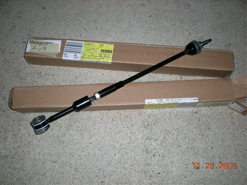

They called back, I was very surprised with the news.
(This was a given, since it sat for so long) Brakes all around
Rear tie rod ends (assuming he meant the toe links)
Shocks all around - he said my rear tires are cupping
Rear sway bar links
He said the front end looked good (even though the boots are cracked on the upper ball joints)
I'll pick her up tomorrow morning and make out a parts list.

Yes, rear tie rod ends = rear toe links
Shocks could be a problem. I've heard that the only aftermarkets available are crap. Let us know what you pick out and how they do. Mine are past due. Note that the cupped tires may have to be replaced too.
The boots on my balls joints have been cracked for a long time (years). So far they still have grease and are still good.
If the other parts don't fix the handling, my bet is on the front lower control arms. It seems to be very hard to tell when they are bad just by examining them still installed in the car. Is it that the car reacts to wind gusts and other cars/trunks going by?

I guess i'm just gonna bite the bullet and order a set of the rear toe links from eBay since it seems like thats the only place that sells them. Question is, how can I tell if they are OEM with the passive steering, or "upgraded" to the non-passive steering? Ill search around, but the search sucks on this board. Never finds what im looking for, but anything in between.
The non-passive link is by no means an "upgrade". Can't think of a manufacturer that isn't trying to do it in a cost effective manner.
That said, here is the correct link... Note the elongated conical shape on the left. The collapsible bushing lives there.
lol @ calling making the part as cheap as possible an upgraded part...

Brian,the ones with the compensator in them are better. They allow the toe-in to stay close while overloaded or cornering,etc. don-ohio :)^)
Obviously you don't understand the concept of 4-wheel steering; active or passive.
Actually, in your case that's an unpressurized section in the toe link...
Thanks for the picture LS4me, and thanks for the links BR. Maybe the search results expire after a period of time or something. They work now.
I've read many a'thread where members replaced them with the non-passive steering and commented on how much better the handling is, so sorry if you see different, but in my book that would be an upgrade.

...I've read many a'thread where members replaced them with the non-passive steering and commented on how much better the handling is, so sorry if you see different, but in my book that would be an upgrade....
They replaced worn out factory parts with new aftermarket parts.
If they had replaced worn out factory parts with new factory parts, they would have seen even more improvement. I've had these cars since new. If you keep everything good, it's like driving on rails around tight turns.
