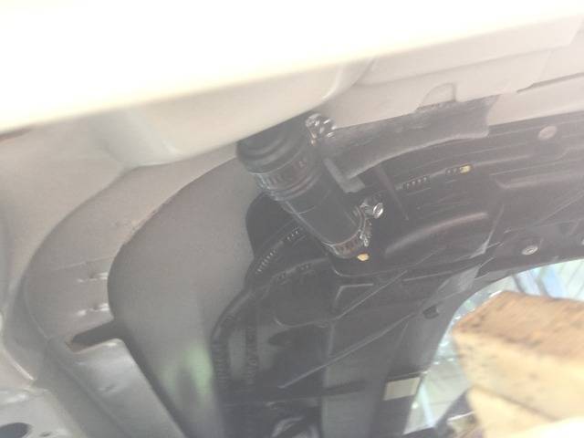

I forgot to mention, I also fixed my sunroof drains today. I had wanted to get them done, but didn't have a heat gun (I had the same problem as Joe, I pulled and pulled, but couldn't stretch it far enough :D) nor did I have any hose that would work. I have a pile of old COP's in the garage (The 8 old ones my buddy gave me, along with 6 from my girlfriends fusion) and I popped the rubber boot off which is essentially a really THICK rubber hose, cut it about half length, used a screw hose clamp on either side, oh I also used some waterproof tape along the drain hose because of that weird white stripping it has, I doubt it would've leaked just putting the coil boot over it, as it was REALLY snug, but I put the tape down first to ensure no water would be able to get through those little things, (If you've seen the hose, you know what im talking about) and then the hose clamp for more protection. The job wasn't bad, its just in an awkward position to be in.

Fixes leaking moon roof draining system with an old coil boot. +1 recyling.
The bigger side closes to the top of the coil fit very snug over the drain hose, and the smaller spark plug end of the coil fit nice and snug over the plastic drain connector. It was a win-win for everyone. Went to the carwash, and made a point to repeatedly spray the roof to see if any water leaked, so far so good. I know I should check my passenger side drain as well, theres no water/wetness that I can see when it rains or at the carwash, but unless its been fixed, its probably ready to pop off as well. Ill probably procrastinate until it does pop off in all honestly. The worst part of that job was the unreasonably short connectors for the overhead console, the left light, and sunroof plug were just barely enough to give me a tiny amount of play, but the passenger side light had NO play at all, I had to go my feel trying to have the console halfway snapped in place while trying to jimmy the connector back in.

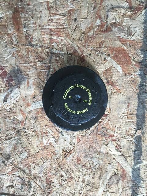

Well, it seems like it was a bad degas cap. For some reason, I still had the old one on there (I'm going to go ahead and assume it was a Dorman cap) it worked with the old degas but not the new one. The heat probably warped it to shape the old degas which was probably a bit screwed up. Don't know why I left that one on there, but I simply pressed the nipple closed with a finger while I held my air gun tightly into the cross engine bleeder hose and there were no leaks anywhere but the degas cap. Screwed the new OEM cap on, and it seemed to hold pressure. I couldn't hear any leaks, and after sitting for 30-+ seconds, I had to let the cap loose so I wouldn't squirt coolant everywhere if I let off the nipple.

Here is the old cap BTW
No sir.
So i'm trying to think back when I asked about not giving it enough time to pressurize. I think at that time I had thrown this cap on there thinking "Well, I know this cap is good, it was holding pressure" (...with the old tank) and then I never actually gave the new cap a shot. All the driving I did Sunday was with the old cap, and then work and back yesterday was the old cap.
I think I had an excessive amount of air in the system which is why I was having trouble bleeding originally, since 80% of the hoses were disconnected and/or drained, and I wasn't revving the engine like you guys said I had to. So now that i've driven it, its been through a few hot/cold cycles as well has having the heater on, it got most of that stubborn air ready to come out, and this final bleed should've taken care of it. I seriously let it drip/pour out of the bleeder for at least a minute or two straight.
