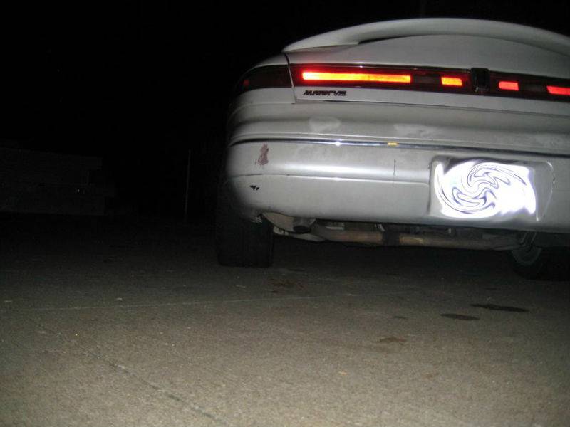

just this bad one. too dark.
you can see the tire is already out past the bumper.
im away from the car, but i could get daylight pics this weekend if you want them.

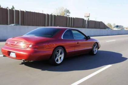

didnt you go 275 all the way around? 275 what 45? when you did the hub swap did that have any affect?
ya id really appreciate that, although im afraid of what ill find out on what i want to run. with the wider wheels im sure they would stick out even farther. what is the offset on your wheels?
275 40 17 all around. about an inch shorter than stock.
hub swap didn't change anything except bolt pattern.
they are 26 mm offset. a higher offset would be ideal. speedsters are 36 mm offset.
just called afs wheels and the backspacing is 27mm how would that look/work?
Sorry bro but that offset simply wont work (Look Right).
Making a 10.5" rear wheel fit would take some well thought specs and the willingness to trim/cut. With that said, you would likely need a 2pc wheel to place the center in the barrel.

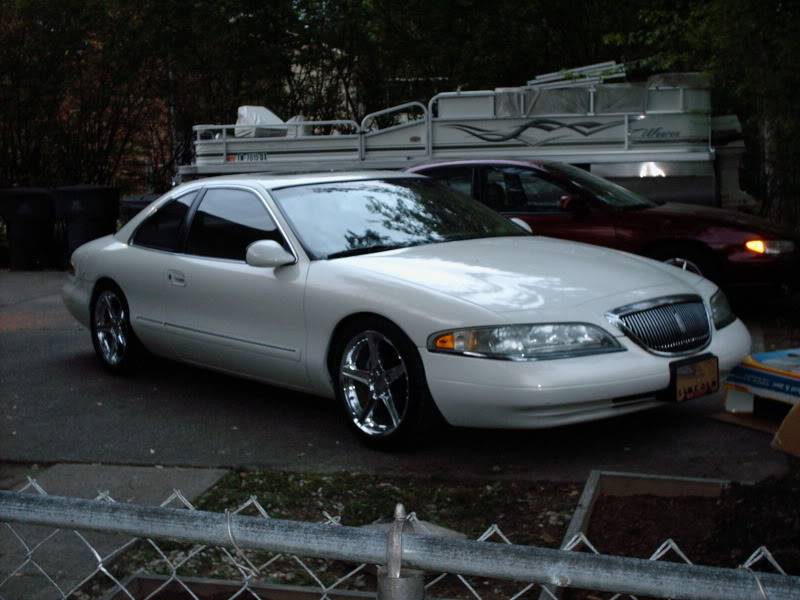

is that a base M8 grill? I have a pearl white LSC. That pic looks great. Wondering if is it because of the chrome rims and chrome ascents on the headlights? The grill looks different, almost two-tone, maybe just the lighting?
