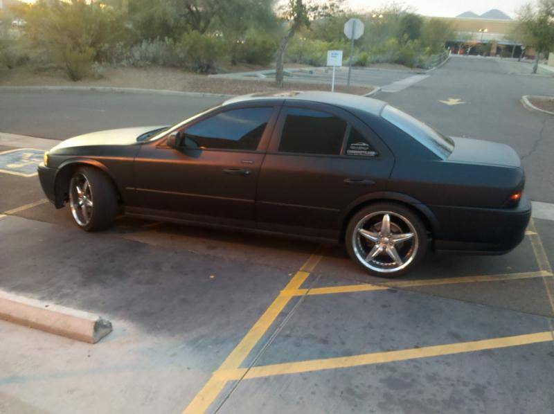

I've noticed that the famous dust that settles on a black car's paint surface is amplified on this vinyl. Because it is not as slick as clearcoat, the dust sticks better. And it kind of outlines the seams. Not a big deal unless you are up close and looking for them, but having a garage will eliminate most of the dust that settles on the surface.
Soopa, no front tint? Lame man!
I have definatly noticed this! Even with my car in the garage it gets so dirty. I'm in arizona so I don't no what I can to about the dust! Literally I will wipe it down and ill go out the next morning and It looks like I didn't even do anything! Haha
Try some pledge. Of course test a piece thats not on the car, but it will make it slick and repel dust. Buddy of mine uses it on his Harley plastics without issues.

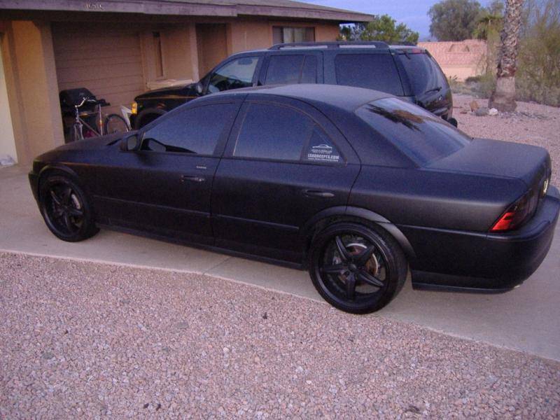

i finished mine last night now all im waiting on is the plasti-dip for the rims
What a change! Looks great. I personally like the chrome rims better thru the pics, but in person id prolly like the all black look more
+1. Stealth look deserves a lowering kit. Even if it is an inch. Go ahead and set that style of look all the way off.
drop will be coming soon. after 3 months of working on this i need a little break. haha and im honestly thinking of doing matte white on my other LS. just think that would be sick to have a matte black and a matte white LS. will probably plasti-dip this time thou.
That is sick man. I like it. Looks like you sprayed at least one with the wheel still on the car, uncovered? I see overspray in the wheel well lol.
Anyways I probably would have tried to plasti dip as well. But I am just glad the vinyl is over (for the most part).
the overspray is tire shine i sprayed on right before i took the pic. and i sprayed all of them while on the car just taped off brakes and used index cards around the tires. yeah im glad wrapping is over too. it was a ton of work.
