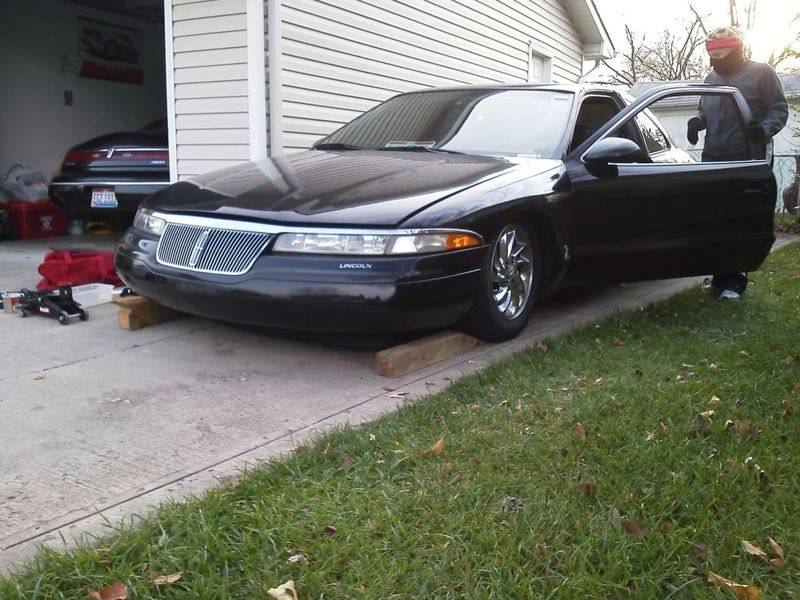

Wellllllllllllllll found out everytime the compressor was running - it wasn't. Which means that it sounded like it was running when in fact it was doing the opposite - letting air escape because it (so far) looks to FRIED!!! Eddie said the gauge is fried too...
I spent almost 9 hours today troubleshooting the problem - most difficult was getting him up, his front end was licking pavement!!! He is sitting at 28" all the way around.. lets see how long it lasts with the air off! if he stays there, looks like a new compressor will be on order Eddie!!!

tux hates you just face it, ..... so deb n i spent half the day replacing the compressor and now he is slammed again!!
can hear air escaping but not sure where. now he is back on the jack.
anybody got some bags? have an odd fold/bend just like that guy in facebook.
it is arnott struts
get a spray bottle and use lemon joy to spray the whole system bubbles and scent will show up. i would say its probably be a air line not seated right. just a guess jd
Will do! Thanks JD! Not sure if I will be able to face him today. I am so frustrated. Thanks again hun - SMOOCHES!
Yes, if you just changed the compressor check the lines at the drier.
This happend to me twice.:)
Jack the car up, remove the wheel and wheel liner, put the wheel back on, lower the car back down, but leave the jack so it won't drop any more. Key on, and feel around the lines at the drier. You'll feel the air escaping. Pull on them, then push the lines in as far as they will go.
Removing that wheel liner is annoying, I leave mine out and put the wheel on, then test it. It's a little more work, but it's easier than having to take the liner out again.:)

I pushed... I pulled, I jacked, I squirted, I flipped, I turned on, turned off, pushed pulled, sprayed, even slashed and drew blood... almost lost a finger by an xacto knife.... he finally got the best of me... Discovered the clamp on the air hose to the rear of the compressor needed replaced, it wasn't tight enough, replaced it with screw clamp instead of the pinch clamp, fixed that then still had a leak somewhere, but the compressor would not play with me anymore and could not trick it.
The xacto cut is still bleeding... tux is still up on jack stands.... pray for us both....
Stihl came over, thinks he found a leak, but wants to play with the bag to get it right b4 we get the wheel back on....
