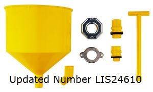

Get this Lisle funnel (kit).
It doesn't have the proper adapter to fit the coolant crossover but you can still jerry-rig it to fit. This eliminates 99% of the burping issues (and the mess) when the burp procedure is correctly performed. Make sure the heater inside car is set to max floor heat when burping the cooling system and that it does indeed make heat.

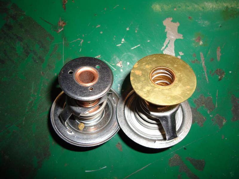

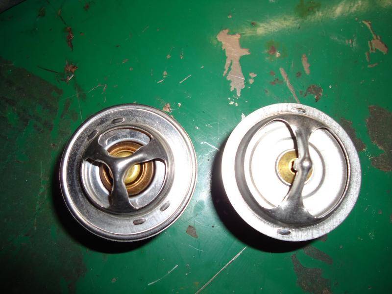

This is why I say to use a MOTORCRAFT thermostat only. In the pic, the stat on the right is the Motorcraft stat and the one on the left is an autozone stat. Note the size difference in the opening coolant flows through. Any stat from any parts store will be the same as the left one. I've seen at least 20 Mark VIII's with overheating issues be solved with a Motorcraft stat. What I can't explain is why some Mark VIII's are able to run the smaller stat without a problem.
