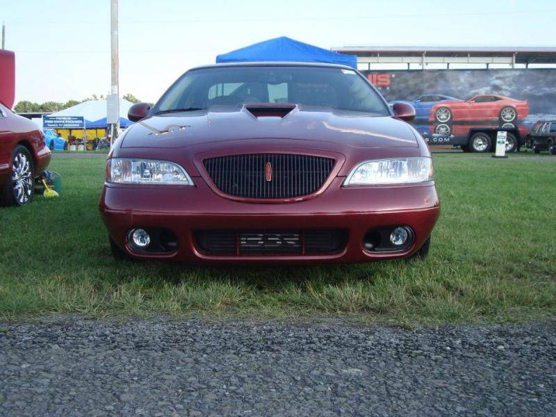

Looks like this Mark VIII owner used the Duraflex Hood Idea + Terminator front Bumper, from Temple Performance. I like it. Still looks like a Mark VIII but a little more Muscular.
Thanks, its a work in progress, Ive been wanting something different and couldn't see myself spending nearly or over a grand for a cowl hood (shipping and paint included) just to have something that everyone already has anyway

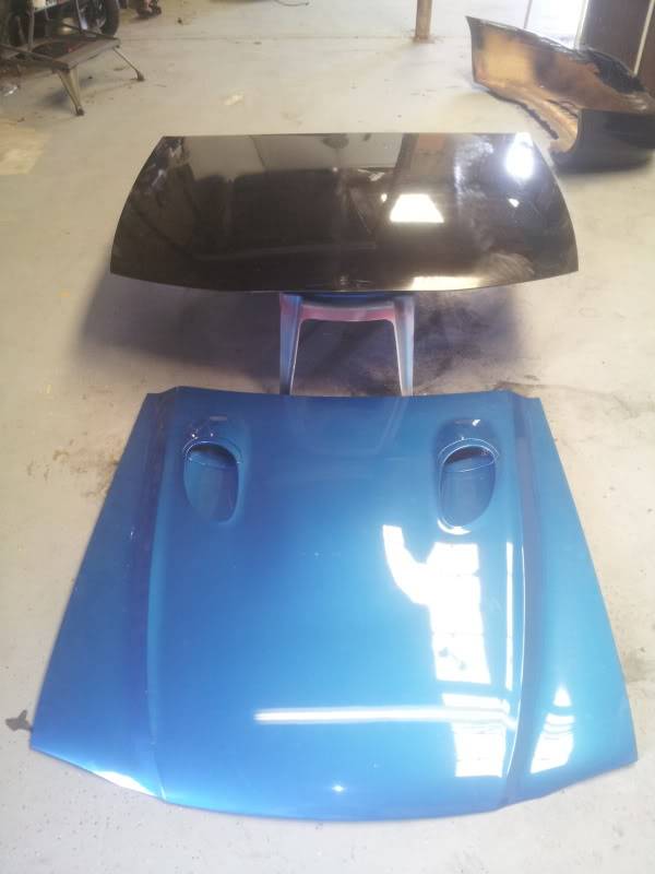

So after a few days of shopping around on CL I ended up driving to Huntsville to see a very sad sight..a 96 Cobra destroyed by hail ;(
So here's a step by step progress report...

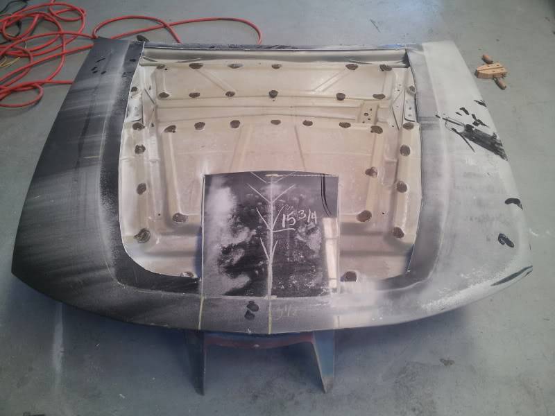

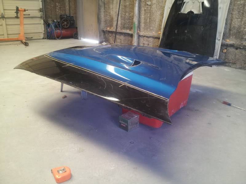

Used my heat gun and a puddy knife to seperate the skin from frame

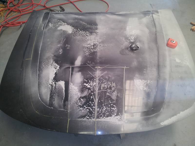

Got a decent idea about where I needed trim away, grabbed my DA grinder and had at it

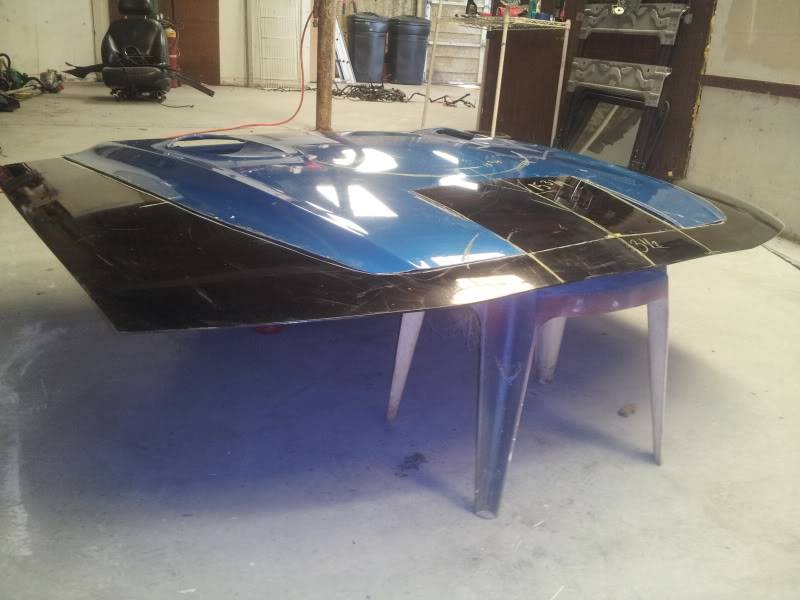

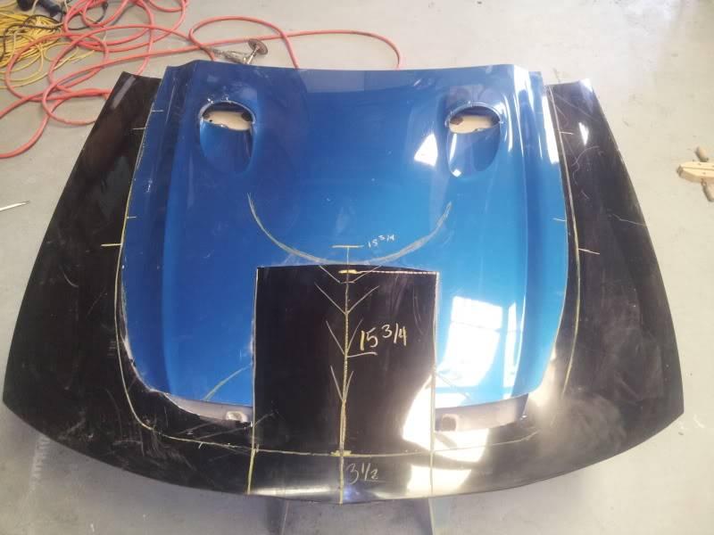

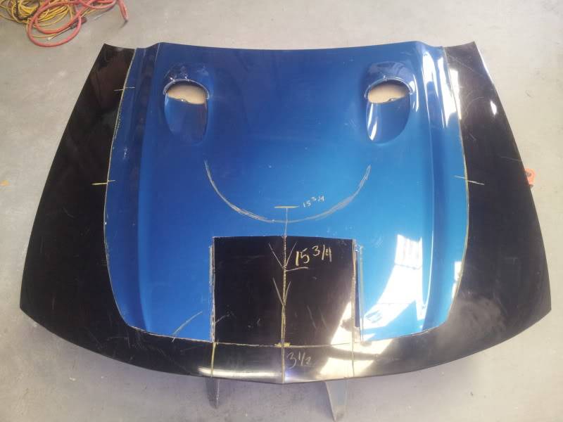

Looking at it from different angles, and figuring how the grill and brow have that slight point, as well as the widows peak of the Mark hood I had to find a way to get that to carry into the Cobra hood

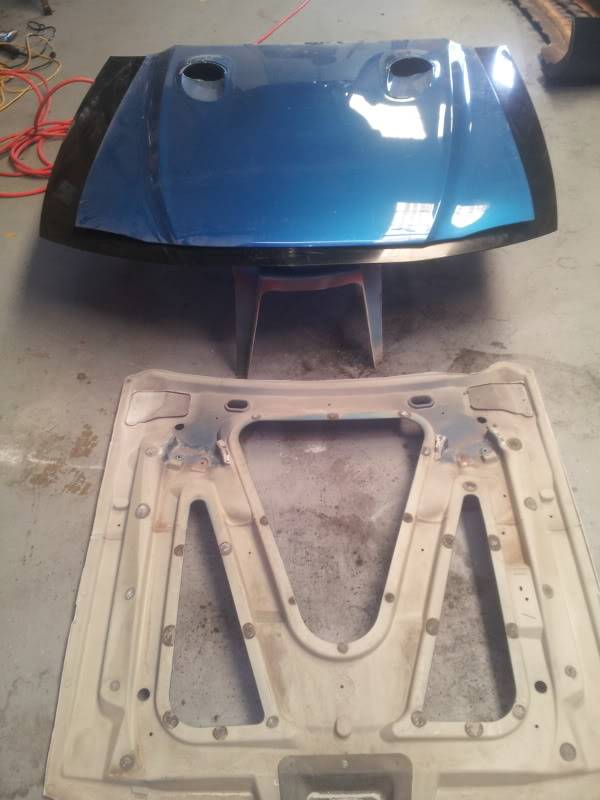

Sapp, looks cool, I always liked those cobra hoods from those years..did you cut a notch in the front egde of the cobra hood for another scoop..and are you making the twin scoops functional?

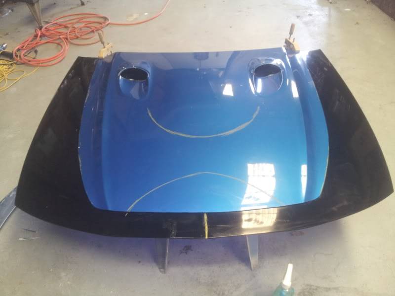

So I traced out the Cobra hood with a crayon, starred at it for a while..then grabbed the DA again

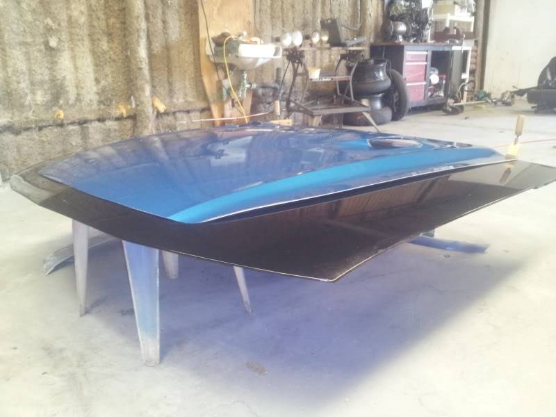

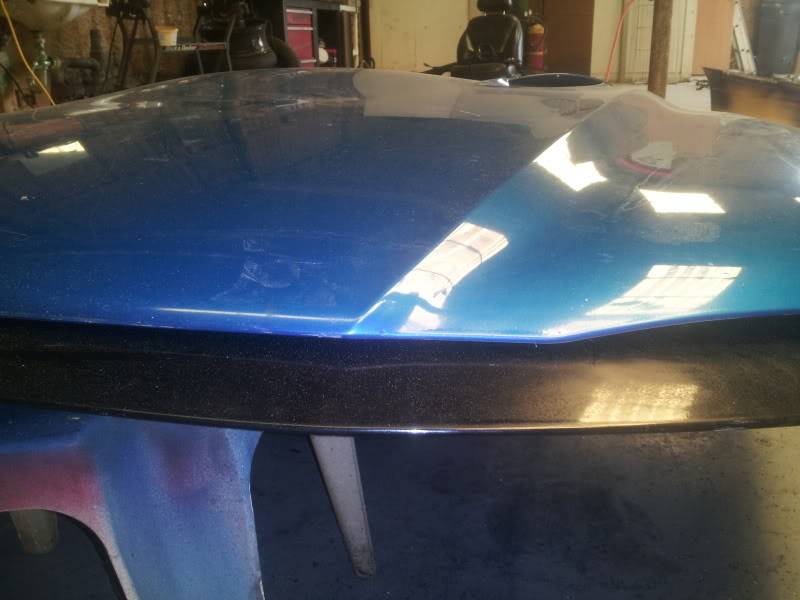

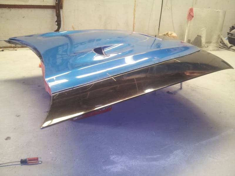

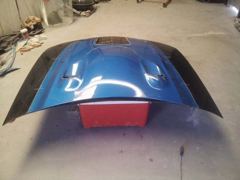

Then slid the skin under my Widow Peak flap ..just to give myself a better idea of how it would flow..
A little more trimming and ..
Ill start glassing it over next week and smoothing it out, once that's done ill start work on the framing

There was kinda an ethical reason I went for the blue hood, it was close, a decent price (including inserts), and mostly- it was damaged..so I took into consideration that someone wanting an entire hood wouldn't want one in that shape. Being that it had been pounded with ice balls, I didn't mind cutting on it. I would've felt bad taking a perfect OEM Cobra hood and cutting it to pieces - and then it not turn out right

It does look good! make sure the hood is flat before you bond your scoop on; or bond it while its on the car. They can get out of shape pretty easy, 1/4 inch over 4 1/2 feet looks awful when you go to put it back on the car. Ask me how I know.
At least with a Gen 2 aluminium hood you can pull it back into shape, no hope with a Gen 1 composite hood once its done.
I've left all the Mark framing intact, wouldn't that be enough to hold its shape? I've never done fiberglass or any body work for that matter.
