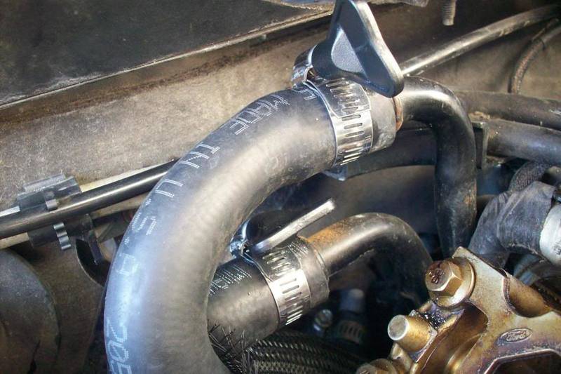

I haven't put the new heater core in, but the hardest part of the whole thing was getting the hose clamps off. The dash removal is the easiest thing to do. Bill, if you're dreading that, that's a two hour job.

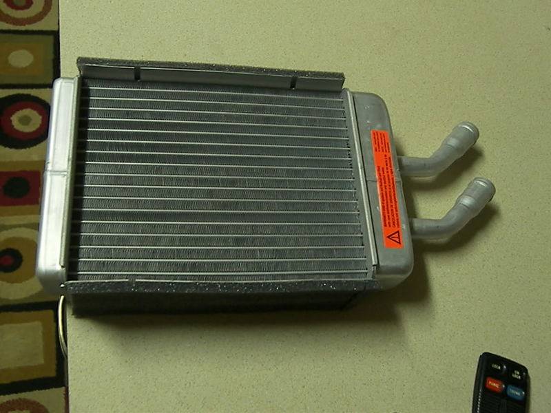

Here's the new heater core. $41 at O'Reillys.
I was thinking that i'd buy a new heater core to put in mine when i swap out interiors, but now i'm not sure it will be that easy.
Well, I must have had the easiest blend door/heater core job in the world somehow. Less than 4 hours start to finish. The hose clamps were upside-down even. I'll give you that spring-type clamps are much easier than screw-type, but still.
