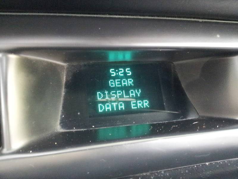

Ok guys, I'm getting the entire roof re-done on my house & the roofers came over yesterday. They specifically told me to move all the vehicles away from the house as tar tends to fly down the sides of the house & my cars are way too close. That being said, this afternoon I got home from work, slapped the front tires back on the car & when I put it on "D" this message appeared!
I did some research on LVC & I've come up empty handed. I drove the car about 2 miles just to test it, tranny shifts smoothly. Don't understand the issue nor the message. Any suggestions?
Negative Ghostrider!!! What you need here is a new electronic shift indicator underneath the actual shifter! Did you get a cel after this event? When this part goes bad there is a malfunction with the gear selector lights between the gear lights on the instrument cluster and the lights on the shifter this is why you get the dreaded "Gear Display Data Error"
According to a quick google of that error, EPC solenoid is bad. But the OP of this thread never actually said it took care of the problem.
That sounds more logical than the EPC.....
I've got the same problem on my '97 LSC. It's intermittent. It only happens once or twice a month. I get the error message and then a CEL. When I get the error, the gear display on instrument panel doesn't light up and it shifts hard into drive. Then when I take off, the D lights up, the doors lock, and all is well. I'll fix it some day. After a couple of start/stop cycles, the GEL goes away and it's fine for another month or so:)
Edit: I just remembered that I had Auto Zone run a scan on it a couple of months ago and the code came back MLPS malfunction. So I'm pretty sure my MLPS ain't workin' right:D But again, I'll get to it eventually. Got a whole mess o' stuff I need to do to this dam car.
I have seen this error first hand on several Marks and these were the problems on each car:

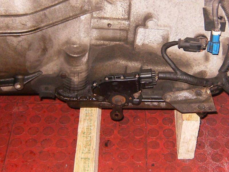

The Digital Transmission Range (DTR) Sensor is bolted to the side of the transmission. Commonly referred to as the MLPS.
Or Manual Lever Position Sensor for short:D Yep. That's what I need. But is that what makes the gear selection display on the instrument panel light up? When I get the dreaded "Gear Display Error", the indicator between the speedo and tach goes dark and won't show the shifter's location. Is that the MLPS or another sensor/switch?
The PCM feeds the IP through the multiplex communications network, using data derived from the DTR.
This error could be caused by loose connections, as well as all of the things that LaserSVT listed, although I don't know how the VSS is involved in this circuit.
