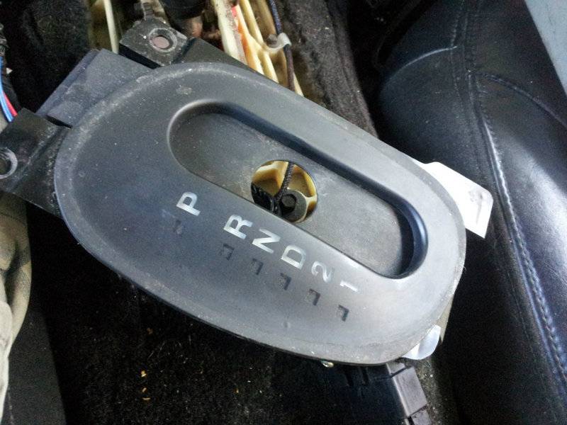

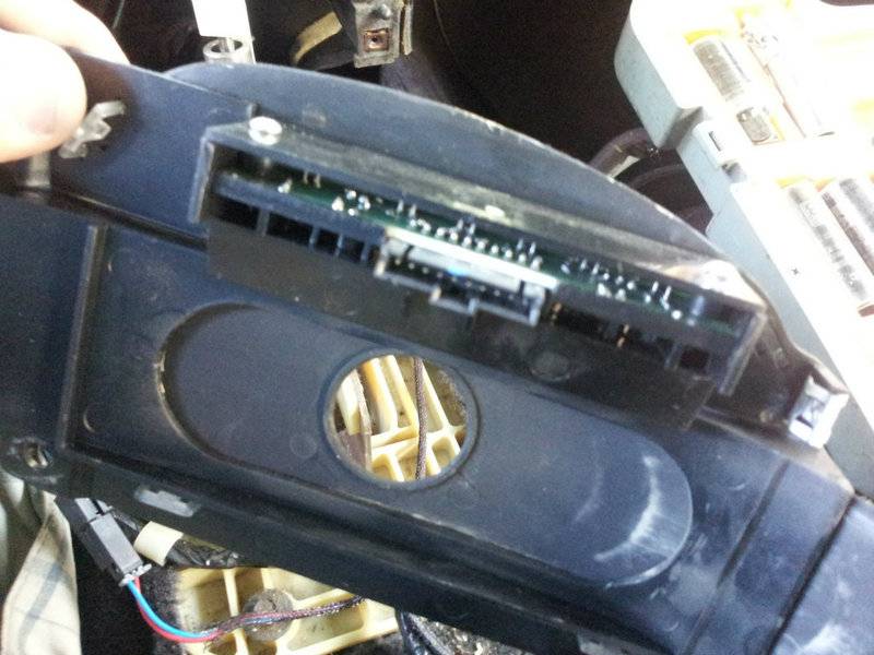

The chip underneath the shifter is now uninstalled. I shift the car into reverse, neutral, 2nd or 1st & I DON'T get the message yet as soon as I shift it into Drive error message immediately comes up. This leads me to believe it's NOT the chip below the shifter either. I no longer know what it could be. Hell my tranny shifts smoothly. If I could snip the wire that sends the signal just like the air ride message, hell I'd cut it. I'm tired of seeing the message. It's driving me up the wall. Check out the pics below.
with this chip disconnected, the message still shows up when in DRIVE ONLY! Which means it's NOT the chip.

Ok guys, I truly need help here. I'm tired of that dreaded "Gear Data Display Error" message. I've swapped the MLPS & just swapped the panel under the shifter yesterday. It's IDENTICAL.
