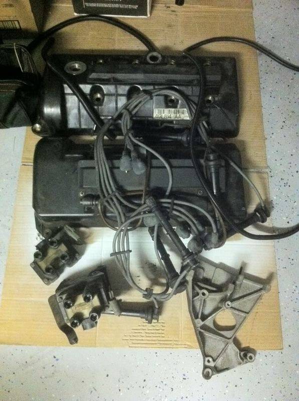

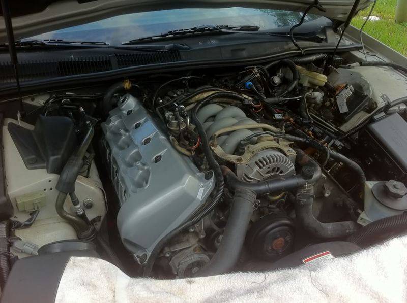

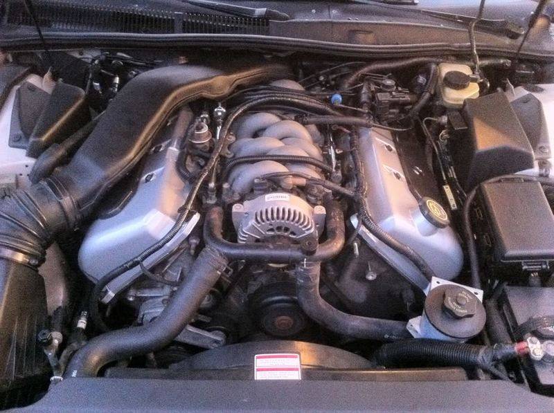

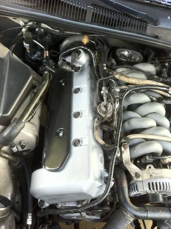

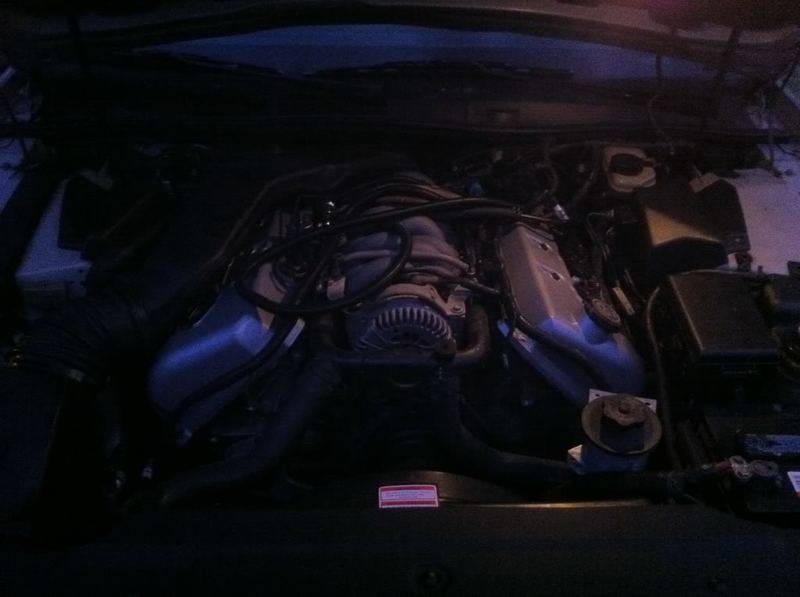

Those are the last pictures I have for now... The last one was before I came inside because a pretty nasty storm rolled in. The top one is after I got the first side together.

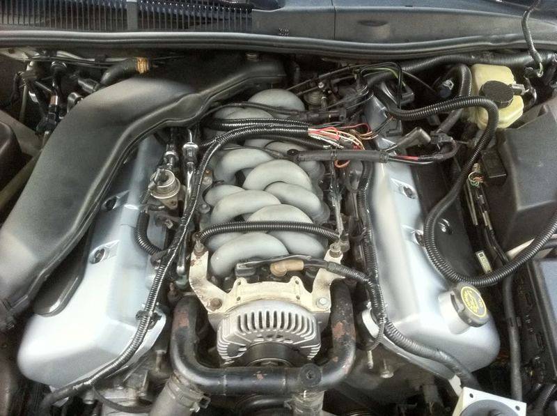

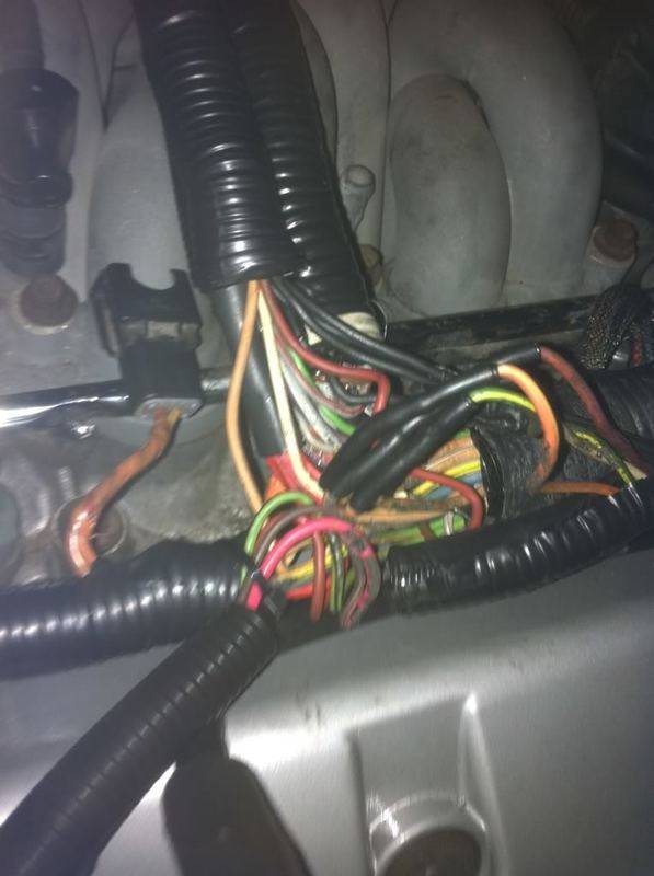

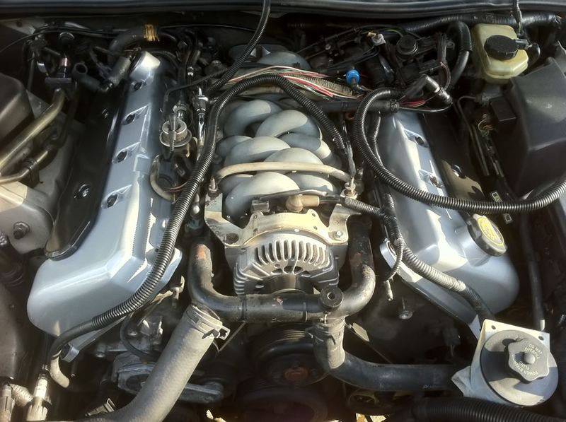

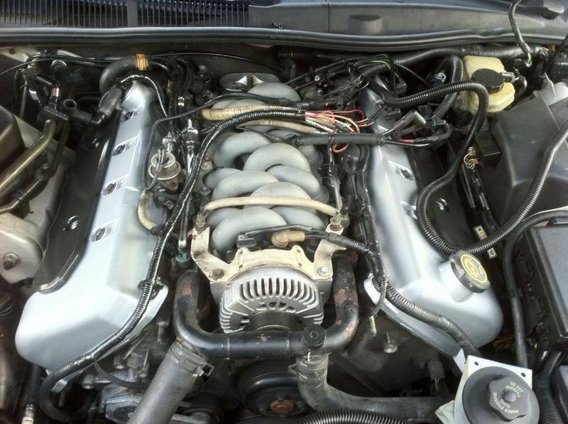

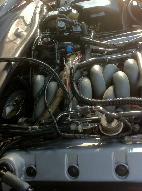

SOOO... I got it all bolted together and decided to fire it up... Car started up just fine, idled up and settled back down. It was a little rough when I gave it gas, but I finally hit the throttle a last time and the car sputtered and quit. Now, it won't start... I replaced the plugs with NGKs while it was apart, and thinking maybe I fouled them out, put my old plugs back in. The car still won't start. The car is on a prett steep angle with the front end up pretty high, and the gauge shows almost empty, yet I have fuel at the rail. So, I'm not really sure what the problem is. The car ran fine last night, and when I first started it tonight, so I am at a loss. Anyone have any ideas?
SOOO... I have been stewing about why this damn things wouldnt start... I had the back end down so low, and the front end up so low on an already steep grade. The thing wasn't getting fuel. I turned the air suspension back on and she fired up like nothing happened. I put my NGKs back in it too. Just gotta finish looming the harness now and she'll be good to go.

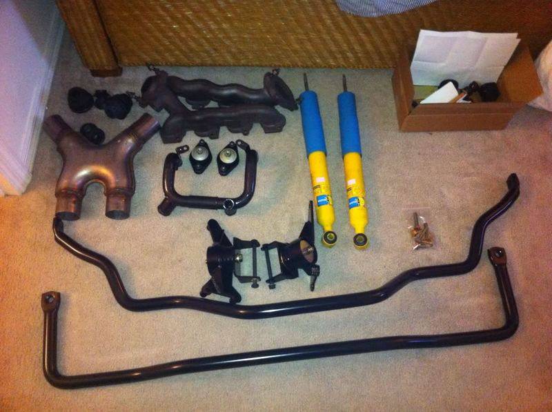

Just got to buy some car parts!

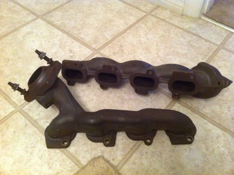

03-04 Cobra Manifolds

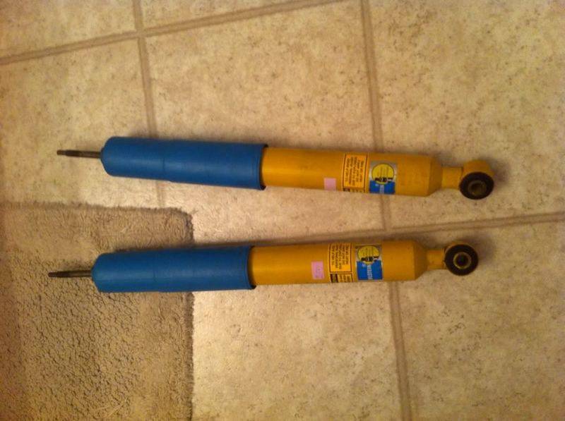

Bilstein Rear Shocks
Rear Shock Mounts

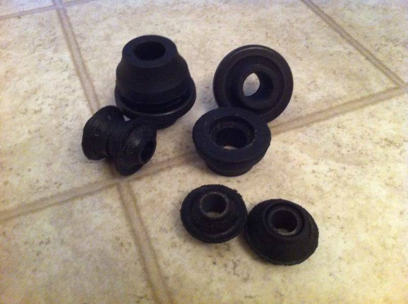

FoMoCo Strut Rod Bushings as per people smarter than I :)

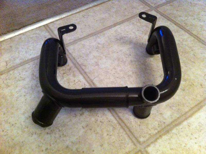

New Crossover tube to match my Coil Covers
The Pile of Parts -- Not individually pictured is the Front and Rear 1 1/4" Sway Bars
And... The part that I am most excited about --

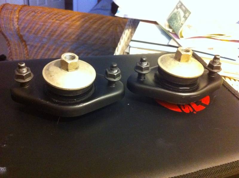

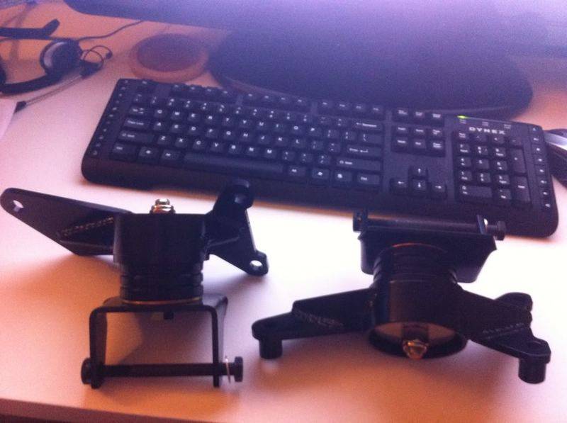

Turbo Chuck's Type 9 Motor Mounts! He finally finished this batch, he may have a few if people message him.
Still need to order the rest of the steering column parts, Energy Suspension sway bar bushings and trans mount, and thats it!

Looks really good. I would like to find a decent black interior also. Curious though why the new engine mounts
Well, my current engine mounts are toast, well the d/s one is. Everything I read told me that a stock replacement wil probably tear up just like these did. A few people recommended Chuck's mounts, figured the price is pretty close to stock parts so why not. The only other Mark owner I know of with them is Driller.

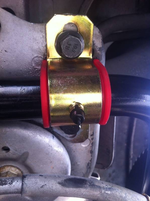

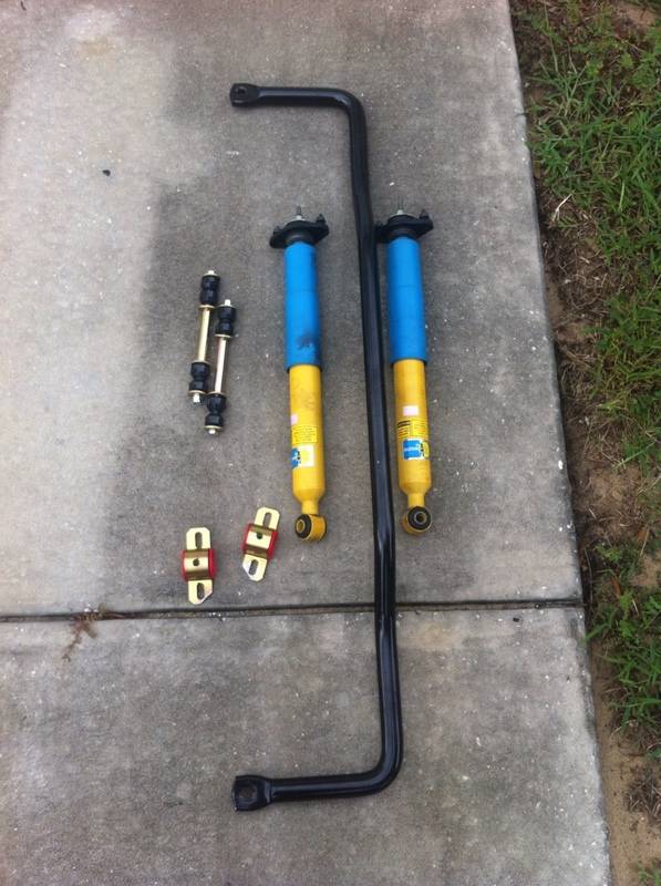

So, I have finally gathered all of the parts I need to do everything in this wave of mods that I wanted to do. I am doing everything, except holding off on the exhaust until everything else is situated. I call what I did today, stage 1.

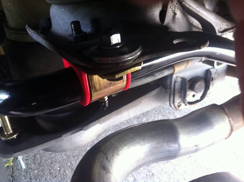

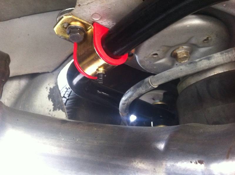

Energy Suspension Greasable SwayBar bushings
Addco 1 1/4" Rear sway bar
Bilstein Cobra Coupe shocks

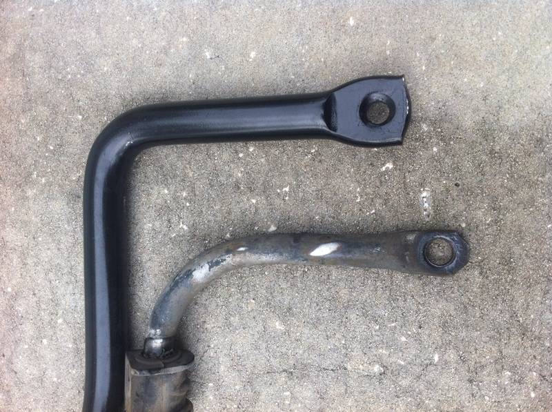

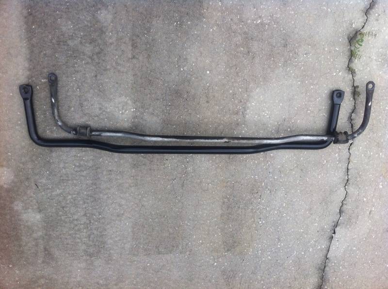

This is the difference between the stock bar and a 1 1/4" bar, size wise.

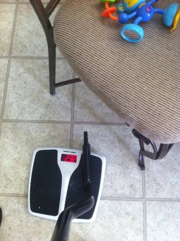

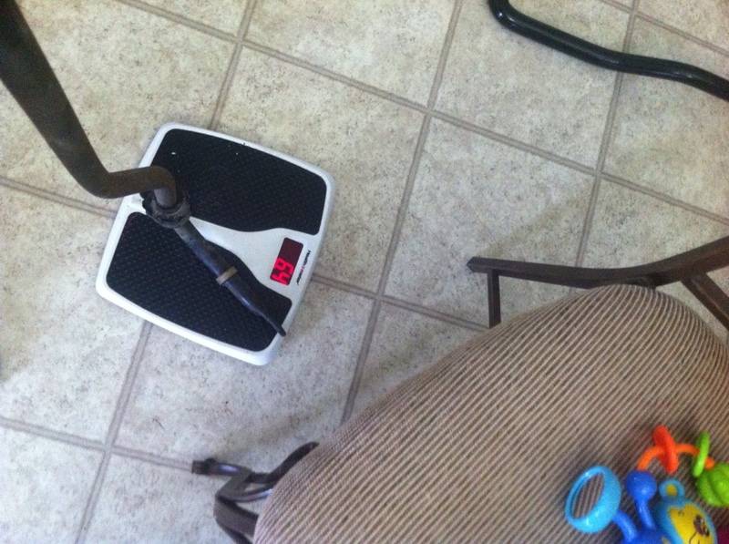

This is something that I thought was very interesting about the bars. They are much heavier than I expected...
Stock Bar. 6.4Lbs
New Bar. 23.2Lbs

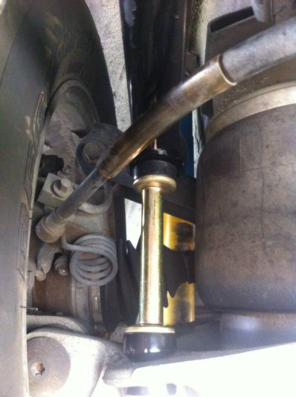

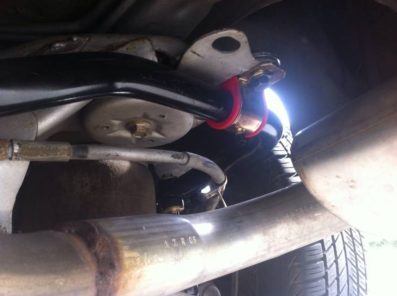

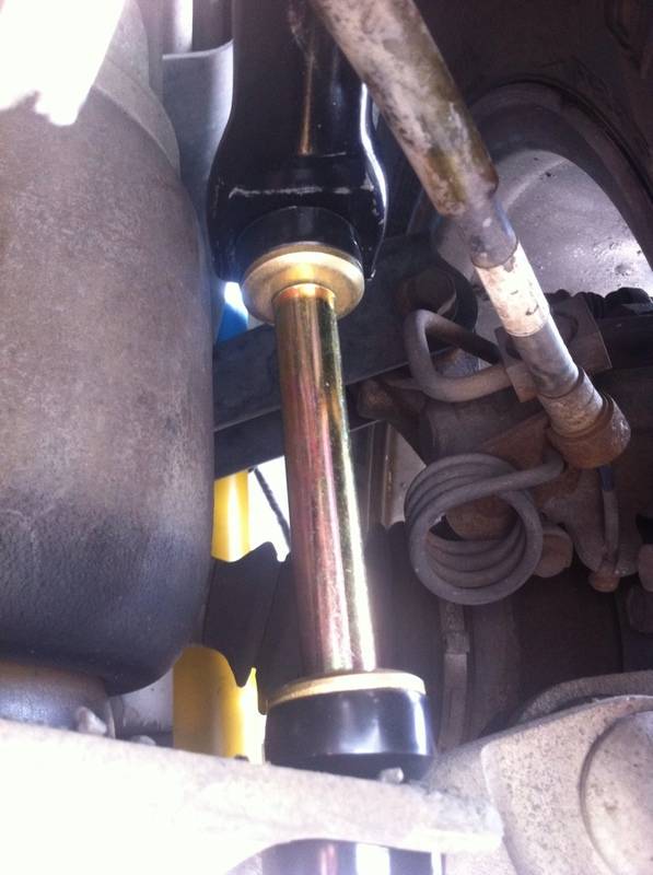

Misc Bar pictures. Installing the rear bar is easy as pie, no wheel removal necessary.
I took the car for a quick spin afterwords and there is a MAJOR difference with only the rear shocks and sway bar. There is a noticable difference in ride in a straight line with the much stiffer shocks (removed sensatracs) and in turns, it feels like it just wants you to give it more throttle. I am extremely excited to finish the other stuff. Remaining is oil pan gasket / adapter gasket / front sway bar/ motor mounts / coolant crossover tube / and ES trans mount.

Excellent. I believe the stock bar is so light because it is hollow. I have a stock Thunderbird Sport on the rear of mine that is solid. I didn't weigh it ?? Not as nice as yours though. I need better shocks in the rear. Heck front to.
