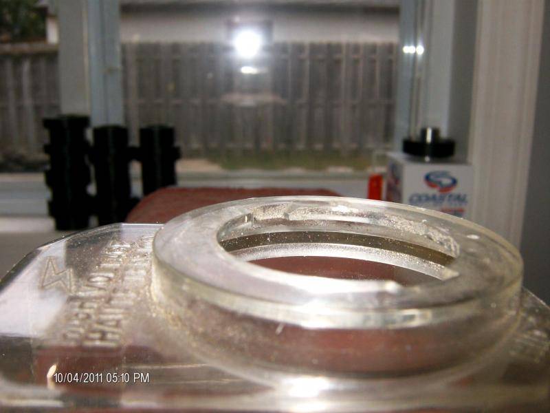

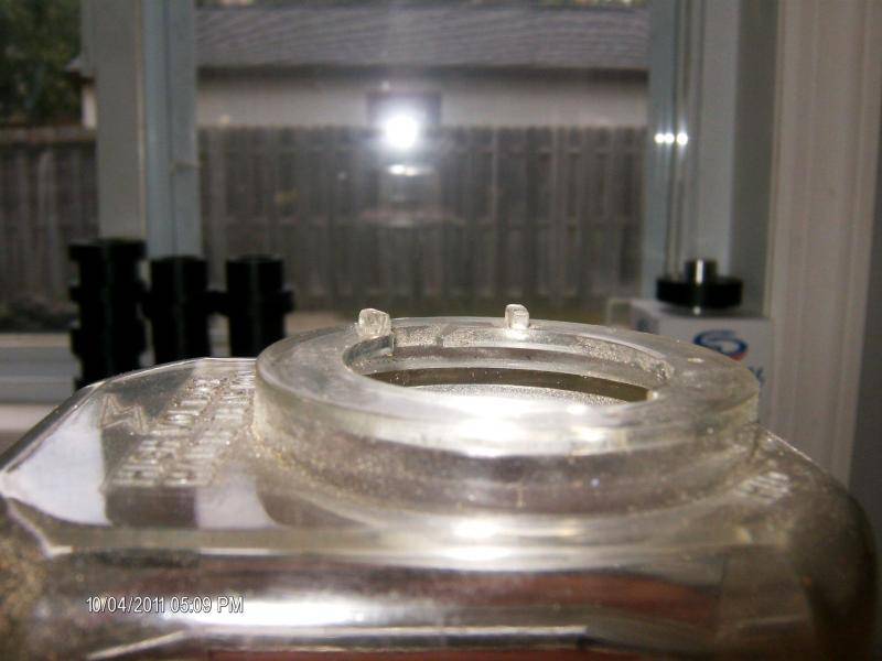

    Did that myself. Cracked em good. Found a small tap and 6 small allen head screws and drilled/tapped the housings. It was very tedious.... and there was jb weld involved :( lol

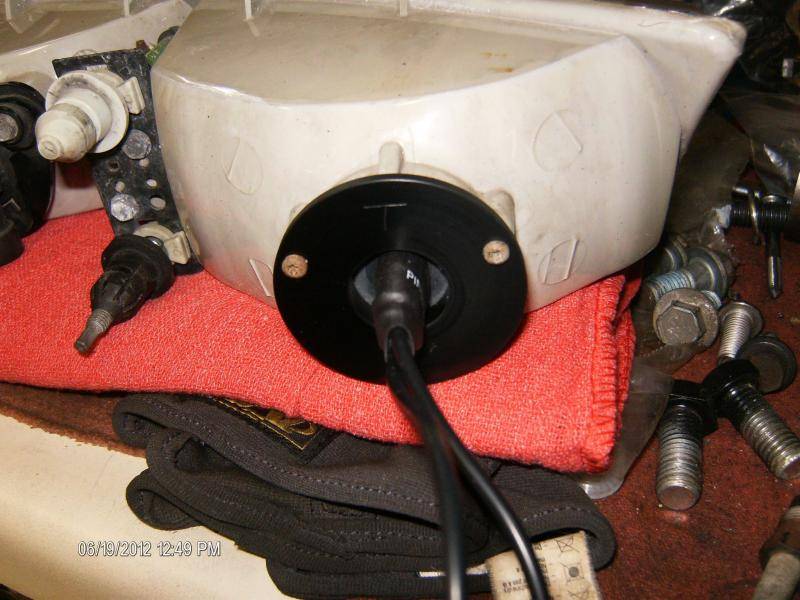

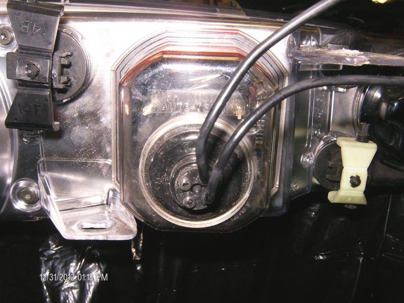

    I'd like to see a picture of your install, something doesn't sound right.
    This is what a Gen 1 install should look like.

    I have a 9005 bulb and the adapter holds it in but i can wiggle the bulb side to side, found a gasket for a trunk lock cylinder in my junk drawer and slipped it in and they fit very snug now. So I dont think i can send you a picture of the wiggle.
    I'm on the hunt for new screws now i put the old ones in for test fit but they are rusted and rounded out.

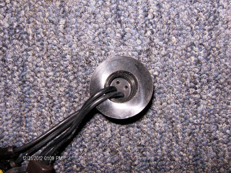

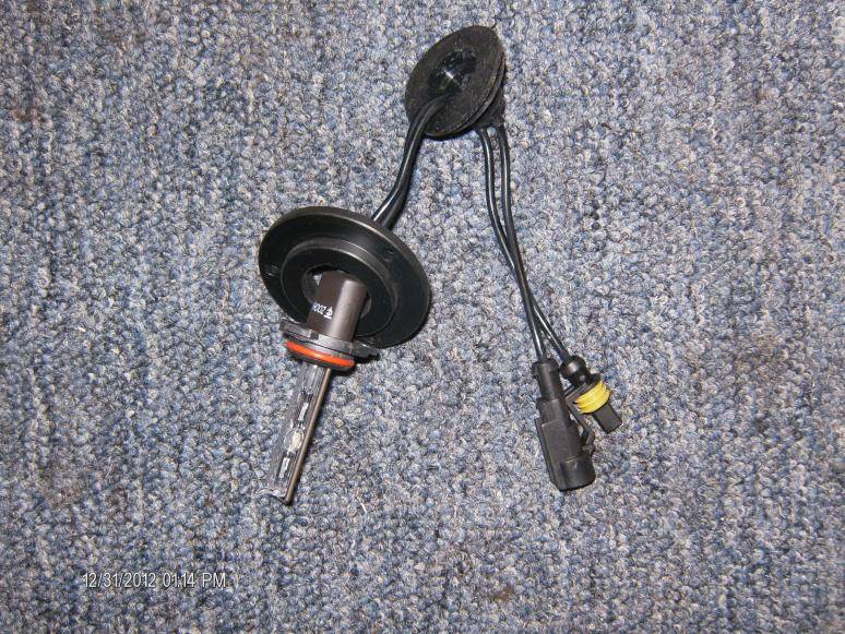

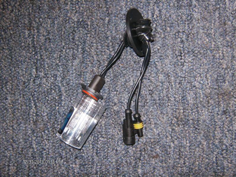

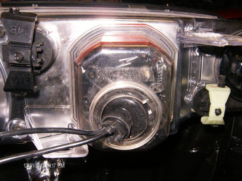

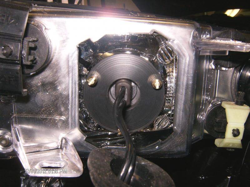

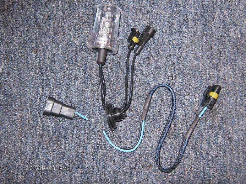

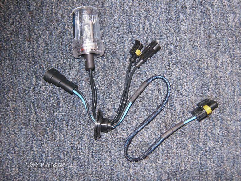

    Here's a little pictorial on installing aftermarket HID bulbs in Gen 2 housings, using my adapters.
    1. Aftermarket HID bulb, as received.
    2. Cut the two wires of the power lead near the bulb socket and pull the wires out of the rubber grommet. You will need the longer portion later to make a wiring harness to power the new ballasts.

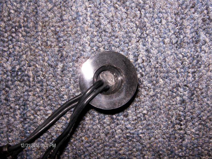

    3. Pulling the wires from the grommet leaves two small holes.
    4. Plug the two holes with silicone sealant.
    5. Push the grommet and wires through the adapter as shown.
    6. Ready to install.
    7. Install the bulb and adapter on the housing.
    8. & 9. Trim the two tabs on the cover flush with a box knife.
    10. Install the cover.
    11. Secure the grommet onto the cover. Gently pull the two bulb wires to take up any slack under the cover. Done!
