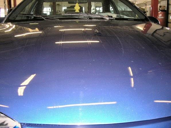

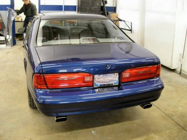

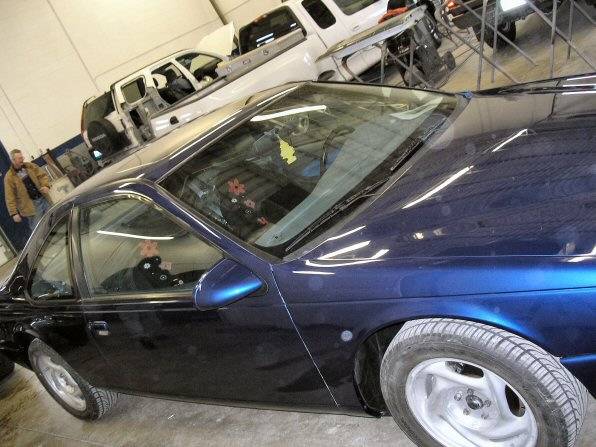

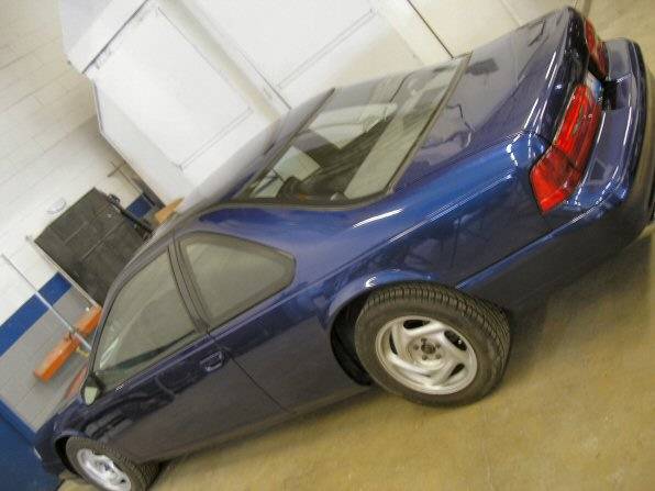

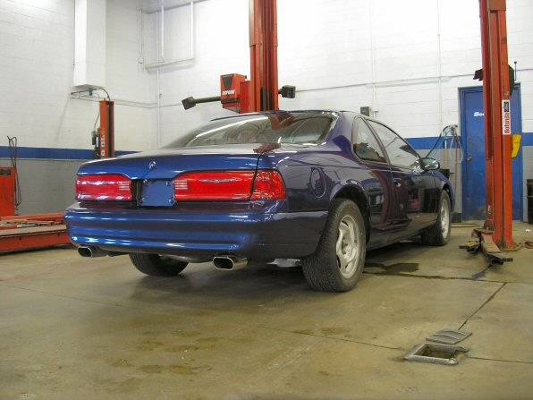

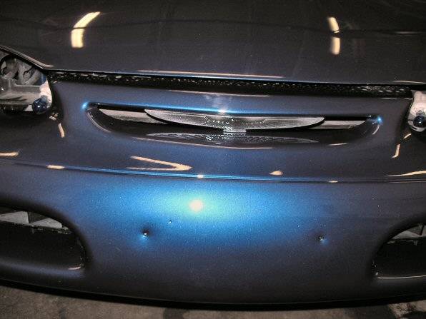

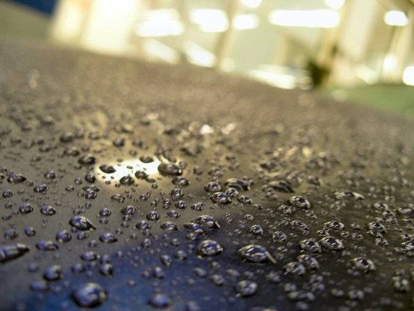

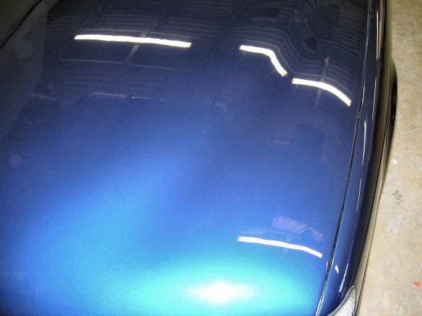

ok well since we got all the latches locks and seals in the body shop put it outside (during the day) for about a week. then they washed it for kind of a "pre last touch up inspection" there were some things that he forgot to paint/need touching up so its going into the booth one last time so its last chance. the painter still has to do the flat black on the b-pillars, the mirror bases and the long trim over the roof from the front windshield to the rear. and he didnt paint inside the gas door and the trunk latch is still green.

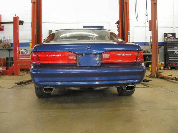

so here are some pics of her all shiny. my camera is stupid in florescent lights and i need the flash or i have super long shutter speed with it off. so first 1 is with the flash on, which reflects back off the tail lights and blacks out the pic. so i shot the next few with the camera on a stool with the flash off. dont mind the water spots. and a shot of the custom painted t bird emblem all the fake chrome was flaking off of it. and look at those ugly assed license plate holes ugh plate laws suck, oh and eric the "rattle can master" sprayed the front plate bracket black. and since the pics i got the rear license plate lights in and he put on the rear plate
*edit in the 2nd and 3rd pic you can see the right is a markviii alum lower control arm, still gotta do the left*

Project looks good,that blue color turned out pretty nice.You guys should have went with 96-97 hood and headlights,they look lot nicer than 94-95.

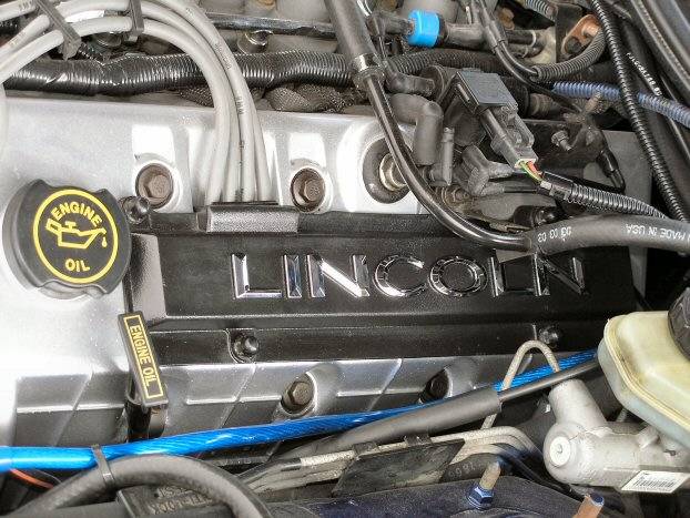

The DOHC engine has knock sensors that the SOHC engine does not:
http://www.fordfuelinjection.com/?p=88
Plus if you plan on running the IMRC's, where is your wiring for that with the SOHC harness?
And I'm pretty much willing to bet the ECU's are different too.
Of course, anything is do-able... if you don't mind deleting the knock sensors and IMRC....
But in the end, the reality is... it's still cheaper to just buy what you want in the first place... when it's already been built.

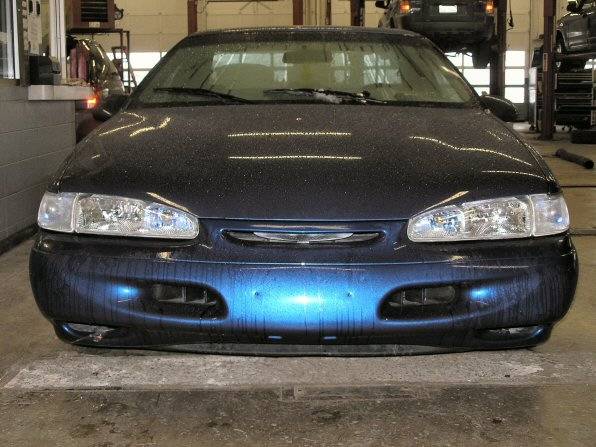

ok well 1 we are using the 96-97 headlights and hood, and have been for the last few years (thats why its black) and dont worry about the slight haze on the headlights, he just installed the brand new ones today
yup knock sensor, you just cut those wires off when installing it in a bird
the imrc you get a msd window switch (used for nitrous) and set that to energize the factory solenoid which opens the imrc's at 3k rpm and hold them open till what ever (think we set them to re-close at like 13k so yeah that aint happening)
this is a sohc harness and a sohc pcm, i just had to reroute the harness and change 3 maybe 4 connectors and get a tune and reflash the pcm

pics of the stock imrc solenoid and the msd window switch (mounted behind the splash shield next to the air filter, lookin for a better pic but dunno if i actually got a close up of the switch)
IRMCs and knock sensors are 2 useless things that you don't need anyways. Unscrew the sensors, take out the butterflies and you're done.I own 2 cars with 4V engines and none of them had 4V from the factory.It all depends what are your plans with the car and if you can work on them but like you stated before it would be better for that guy to buy a cobra if he doesn't have big plans for it.Sorry for the tread hijack.
I'd disagree on the IRMC's being useless... and to a point, the knock sensors too. For those too stupid to take care of their car, knock sensors could save their engine. As for the IRMC's... kind of hard to dispute the benefit for a factory engine which would otherwise suffer from a very week low end. As you said, depends on your plans for the vehicle and intended usage.
So I stand corrected (sort of)... you can use a 4v in a 2v car; but it's not a "direct" swap... modifications required.
well of course modification is required, and the only reason the dohc has a knock sensor is for when mr cheap skate dohc owner runs reg octane (all dohc are premium only), no need in a non boosted, non variable valve timing type of eng. how do you think 4.6 sohc engines run for a half a million miles with no knock sensor?

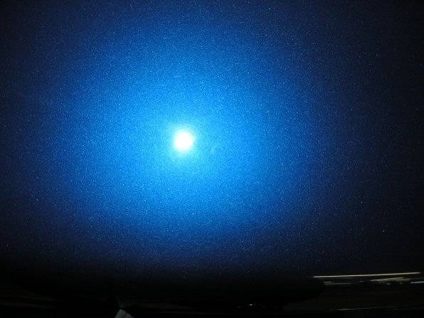

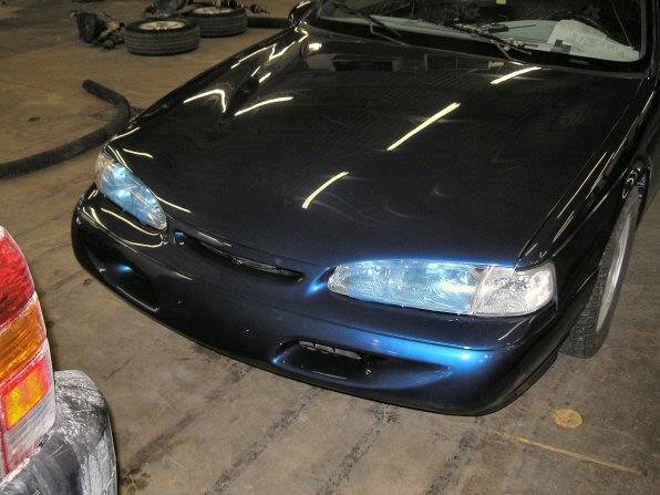

look at them new headlights mmmmmmmmmmmmmm still in the blue plastic wrapper. then with no wrapper. then i try to be artistic

I am new to this site. I am planning on doing a similar swap. I have 1995 Crown Vic P71 that I want to install a 1995 Mark VIII engine into. I have both complete cars. The Mark was totalled by the previous owner, on the second day he had it. I need to know which harness(es), and computer to use. I want to use the IMRCs. Do I use the Mark's MAF and Injectors? I am planning on using the Crown's transmission. Thanks for your advice......
Looking at the picture, it would appear he used the mark MAF... which you'd also assume he used the mark's injectors (I think they are 24lb injectors vs 19 for the SOHC???)... Might be wrong though...
the trans should be no prob. what pcm to use could be tricky, since it controls the trans too, and thats 1 reason why we used the bird pcm, re loomed the harness and swapped a few connectors. the imrc's are ran by a msd nitrous window switch. they are actually designed to shut off the nitrous when your automatic car shifts gears and your on the spray, so you set a on and off rpm and use the ground signal (i think the solenoid is ground switched) to turn on the oem solenoid and tap one of the wires to the coil pack. 99% of the eng electronics are markviii, we swapped out the oil psi sending unit with the bird one (oil psi light vs gauge) and the window switch running the imrc's. the maf, injectors, tps, iac, and everything else are markviii all ran by a bird pcm, with a cookie cutter tune from Lonnie, and a modified bird harness all bird gauges 100% functional. the car is exactly what we (like i have much of a say in the design :D) wanted, to look completely stock and unless you really know, you wont notice anything

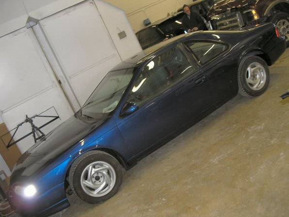

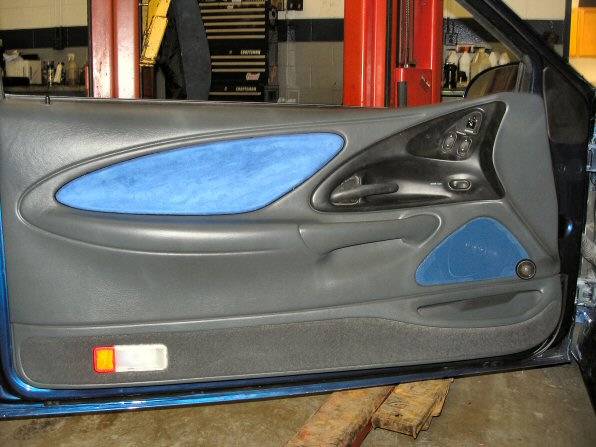

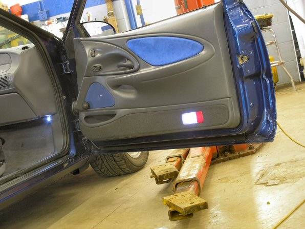

ok well on Saturday, after 2 hours of digging/pushing the car out of the driveway i got to the shop. MWB had all the wheel liners and all the little pieces installed in the back. we got the fog lights mounted, the front wheel wells installed, i threw on the finished door panels and installed a auto down relay thingie (something he found on tccoa) from a taurus, talk about cake, 5 wires and once i got my test light fixed we were all good. only a couple pics cuz who wants to see a wheel liner anyways? and just to note (since its been mentioned on one of his thread on tccoa) the leather inserts in the door panels actually matches the car and is not highlighter blue like it looks in the pics, even without flash its still bright as hell

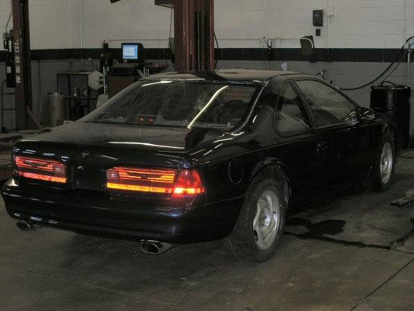

ok, so today the body shop did the final buff on the car, installed all the windshield (front and rear) trim, the roof trim did touch ups on the mirror bases resprayed wiper arms. basically the body work/assembly is finished, just tint then the rear interior can go in, and i gotta finish making the other quarter panel trim panel. then back to the performance mods!!! well that and gotta get the car out in the sun and at least center caps lol
and if your wondering the 3rd pic down shows his awesome seat covers that i got out of a traded in escape, and figured they would get dusty instead of the seats
