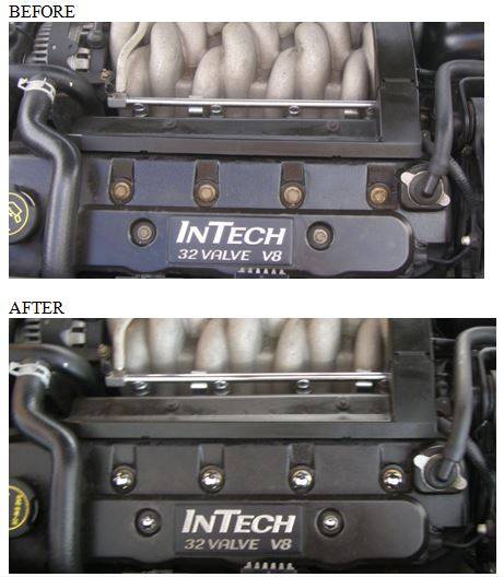

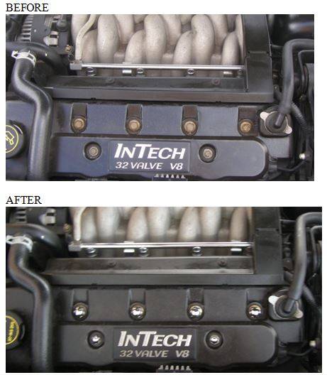

        I don’t have much in the way of rust – but I did jazz up the front valve cover with chrome acorn nut covers. I like chrome.
        I’m now in the process of masking off the carriage top in prep for a spraying of Raggtopp sealer/protectant.

        Just google “acorn nut covers”---
        Summit Racing has them.
        I got mine a couple of years ago from California Customs.
        They are all over ebay too.
        The ones I bought were for ½” and 3/8” hex heads.
        I had to modify every one of them by grinding down the inside wall thickness with a Dremel to make them fit.
        Maybe I just bought the wrong ones or sizes.
        Years ago I bought a bunch for my motorcycle and they all just snapped on and are still in place.
        I guess quality control in the nut cover business is not what it used to be.
        At least they do add some shine to an otherwise drab engine compartment.

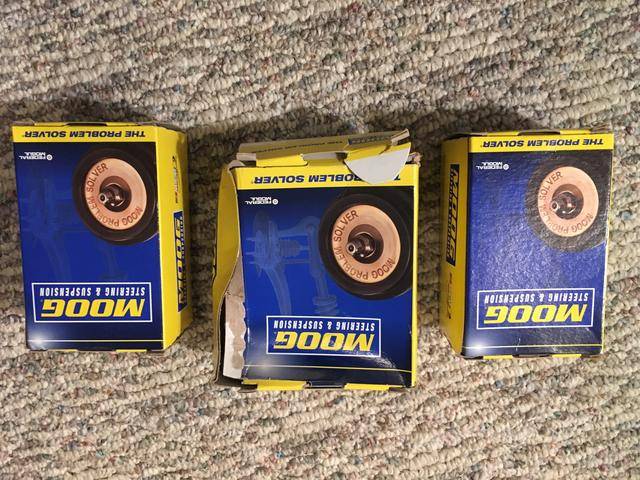

        I had gotten the front suspension parts to fix the issues that I am having. I get a better price from some people that I know, for me it was a little over $100.00, just to give you an idea as to what you would be paying. If any of you need this repair work.
        These include:
        2 upper ball joints Part #K8687
        1 Tie Rod End link Part #ES3307RL
        These are the MOOG brand.
