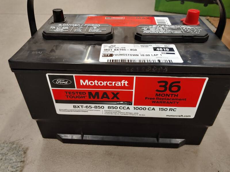

I ended up getting a new Motorcraft battery from Oreilly's.
The part number # is MOT BXT65-850 for who ever is looking at a new battery.
I put it in the car and it fired right up no slight lag or anything.
I really like it.
If the old duralast was a gold series, it was rated 700CCA & 875 CA.
The Motorcraft has more reserve capacity.
Good choice for anyone that has real winters.

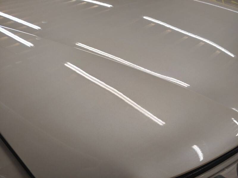

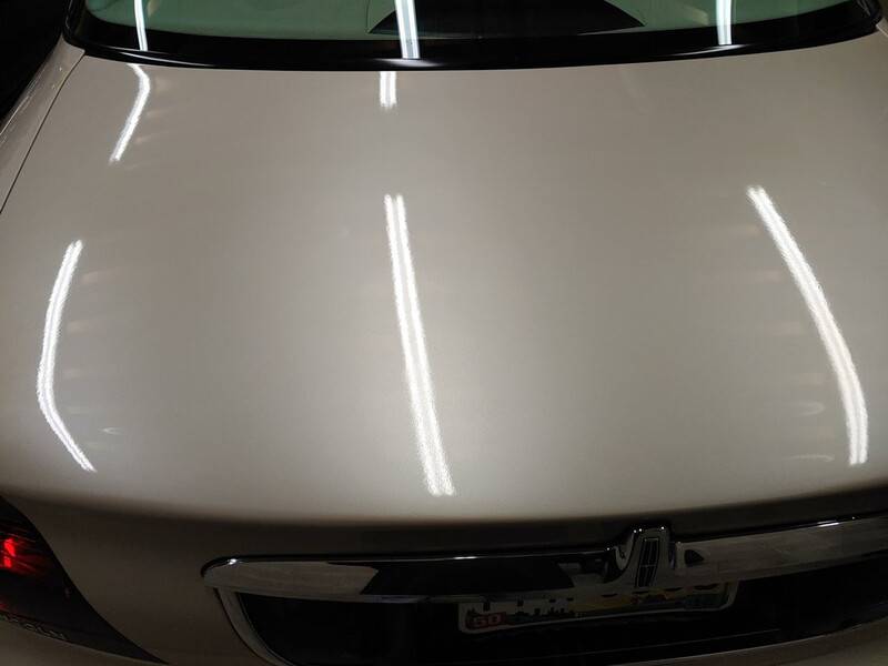

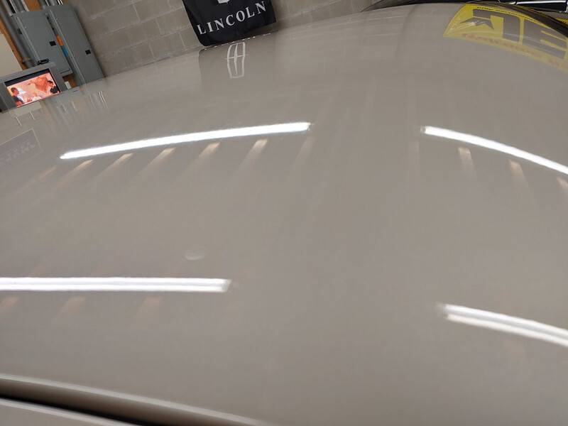

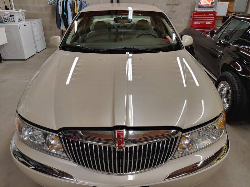

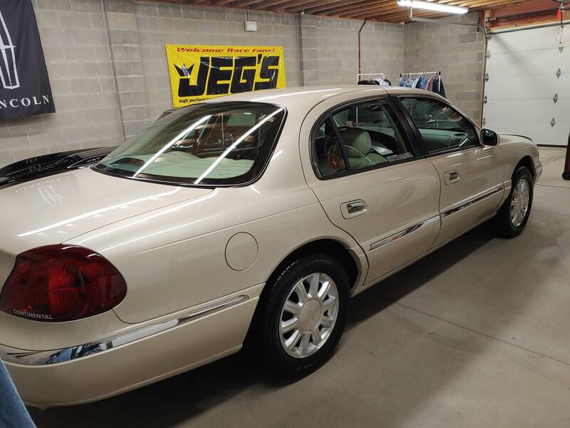

I finally finished up the car, polishing out the paint and adding the ceramic coating. Down below is what I had used and the results.
1. Washed using the 2 bucket method.
2. While car was wet use a clay mitt to decontaminate the paint.
3. Polished out the paint by hand using Black Max Brite Max light polishing compound. Used orbital polisher to take off.

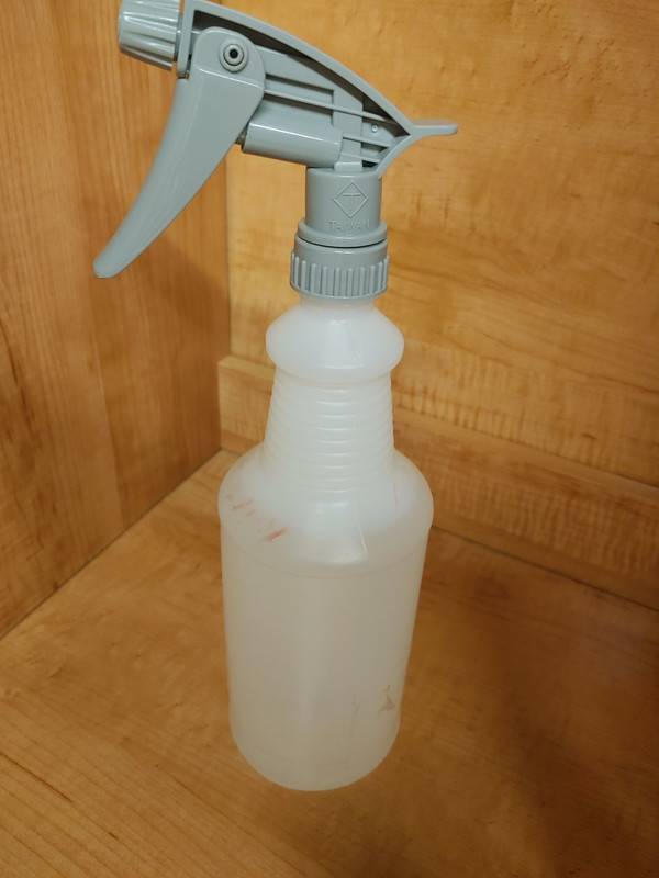

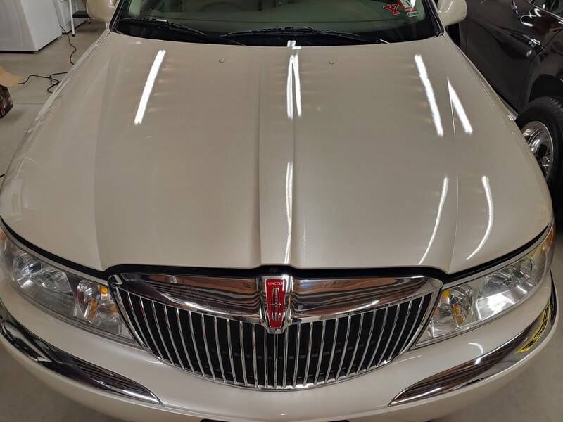

4. IPA wipe down using 50% alcohol with distilled water. Mild mixture is all you need:
- Mix 8 oz. of 50% IPA alcohol with 24 oz. of Distilled Water, this will create a 12.5% IPA spray which is all you need. Do not let the solution sit on the paint. Just spray and wipe away.
5. Once IPA step is completed I used Avalon King's ceramic coating. It was around $60 or so. If you can find a coupon code it will be a little cheaper.
- Go here to puchase: AvalonKing | Quality Automotive Ceramic Coating Products
- Follow directions on the kit, it is very easy to apply and wipe off. If you don't drive your car all the time especially in bad weather, they say this coating will be good for 2-5 yrs.
Here are the results:
****If your thinking of applying a ceramic coating by yourself or getting it professionally done make sure you post your pics!!!****
