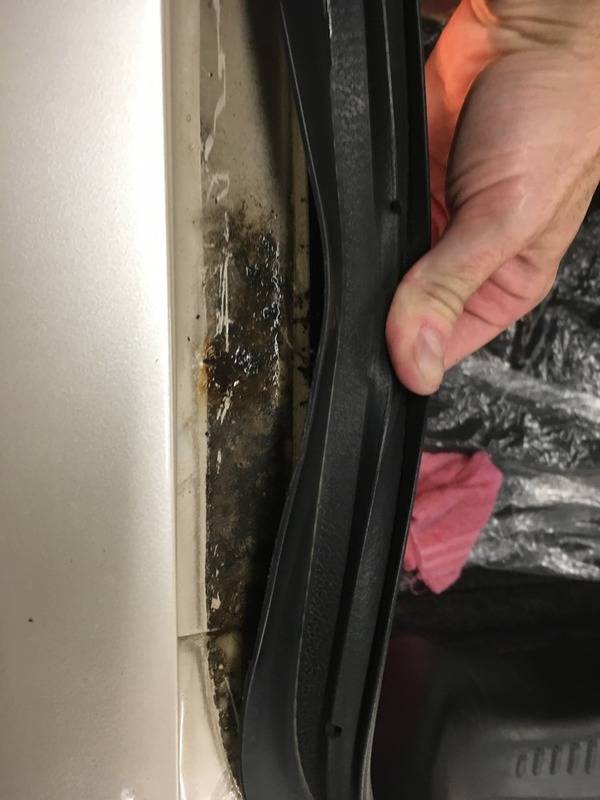

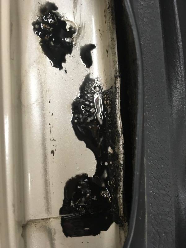

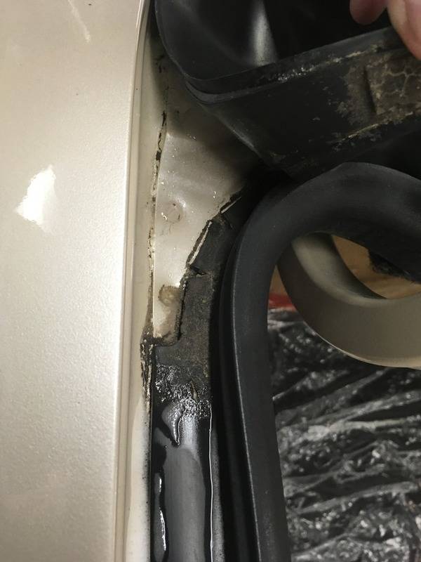

Everyone FYI!! So I was cleaning around my weatherstripping by the deck lid and to my knowledge I saw what looked to be rust bubbles. Upon further investigation I noticed the weather stripping is sealed well and has holes on top to vent. Well another thing is on the top under the rear window there are snap fasteners on top to hold the whole stripping together. Make sure you take off the weatherstripping and clean thoroughly or it will start to rust on you. Its from all the gunk that gets trapped over time that you need to "flush" out. I applied POR-15 to the tiny rust bubble areas. Then applied some WD-40. I believe this area to be another small area prone to rust on 1998-2002 Continentals.
What it looks like before:
Top piece that sticks the weather stripping together in both drivers side and passenger side corners:
Applied the POR-15 to the infected areas. Let it dry. Really hard to smooth out the product cause it does run on you:
Dry time is about an hour or so. Then the next step just snap the weather stripping back onto the area of the trunk.

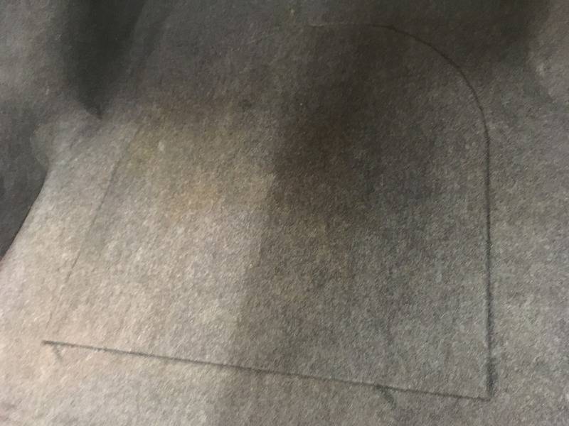

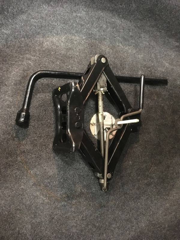

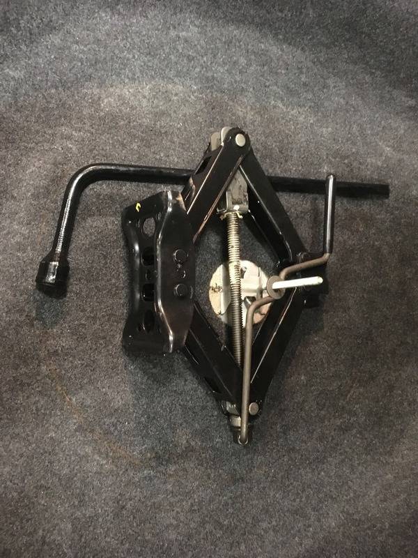

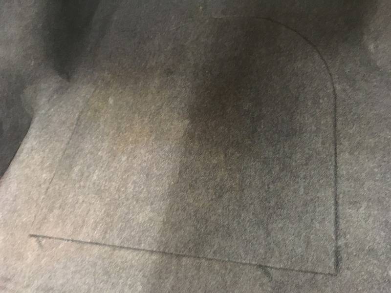

While I was looking over the trunk area I noticed my spare tire cover, spare tire, and jack to be all over the place. So I looked in the owners manual to see about factory assembly it shows how it goes back. ***Also make sure you check the air in your spare tire!! It should have Max 60 PSI. Mine only had about 3 PSI in it. What a nightmare I would have had if I ever needed it. Make note to replace it if its dry rotted or has unusual wear. It is a T125/80 D16.
How the jack and lug wrench look..The J hook that hooks to the metal flap on bottom of compartment goes through the jack. Jack must be raised to fit inside spare, the handle with the hole must align with the J hook it will fit right into middle. Then place the spare tire center so that the J hook goes through then place the Spring onto J hook, place the small metal circle through, tighten everything down with the T-handle tightly. **Unfortunately I didn't take a pic of this. I had to give a how to instead.
Trunk cover now sits flush as it should:

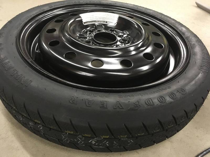

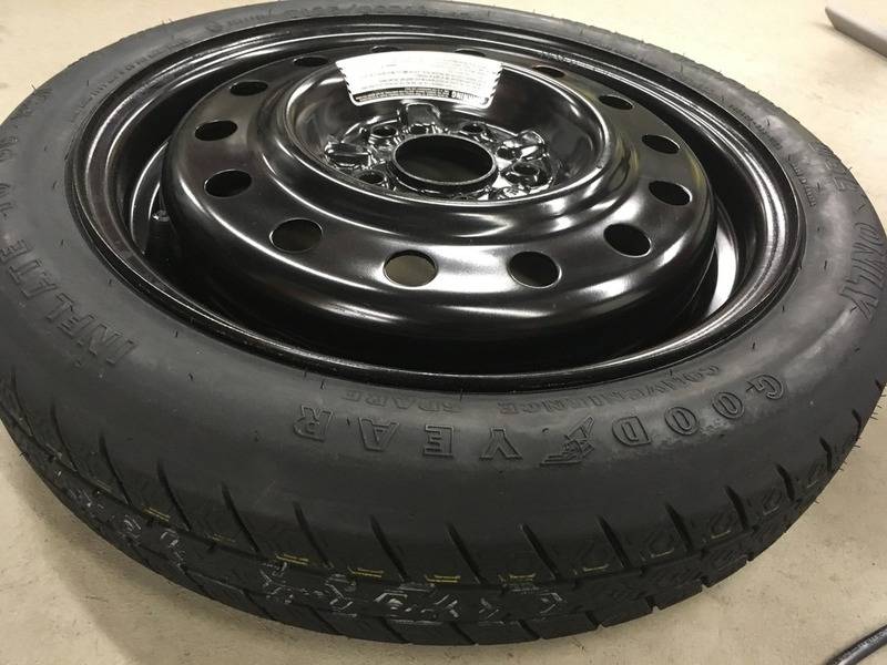

My spare tire, notice some uneven wear and minor dry rot. No rust on rim its like brand new. I will be replacing this eventually:
This is routine maintenance you'll be happy you did it in the end!

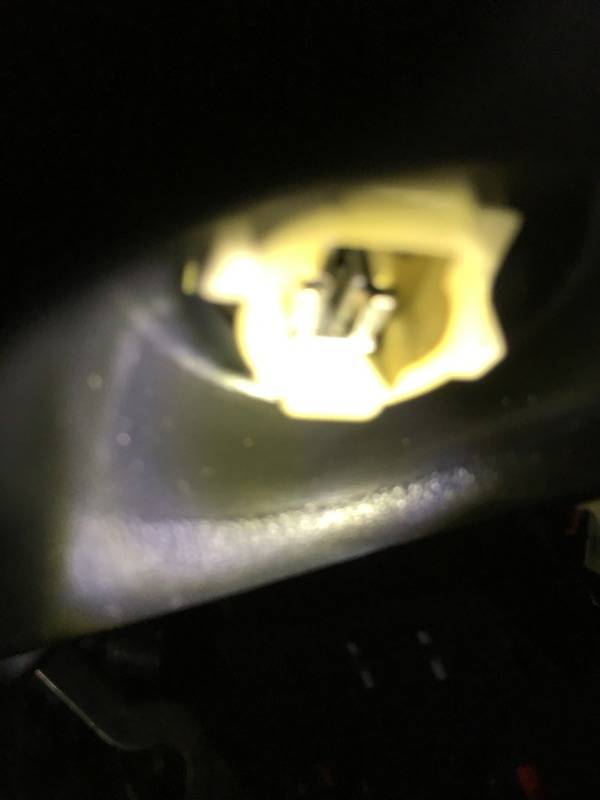

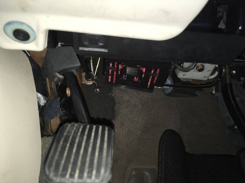

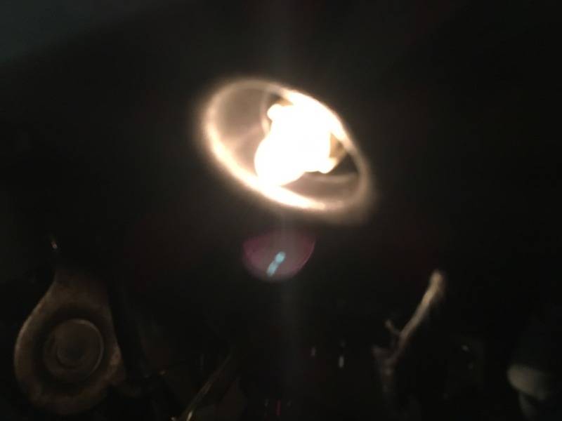

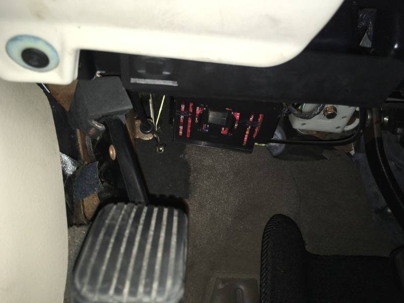

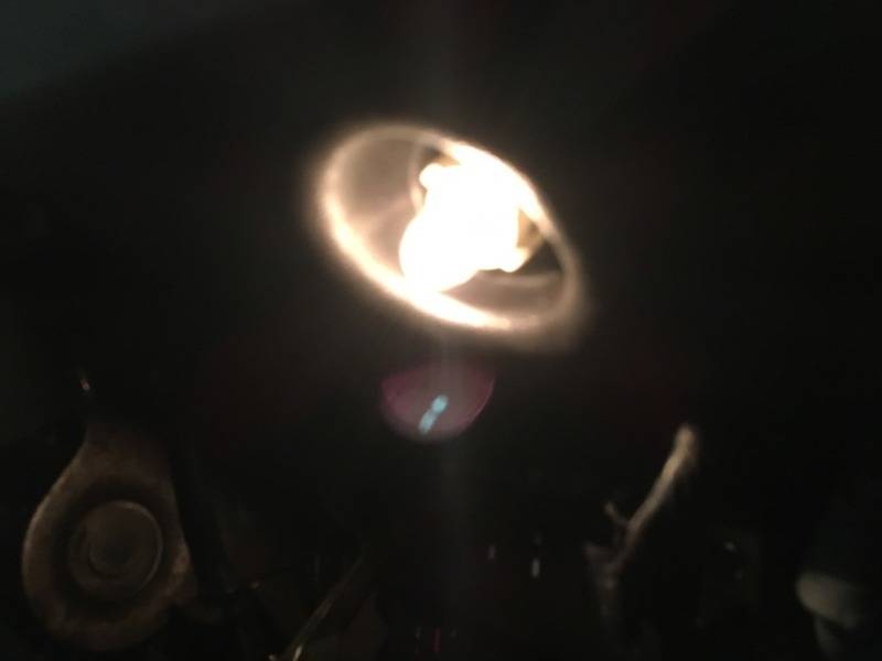

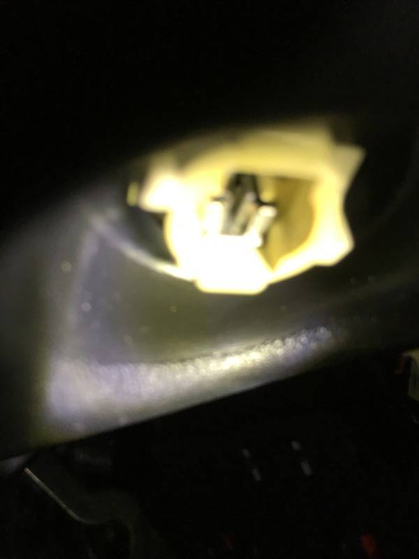

My lower vanity light near the foot well went out. Very easy to replace, I thought I had to dis-assemble the plastic component to get to the light. That is not the case, just pull the bulb out and push the new one in. Part number is Sylvania #161LL It only costs $5.
Right above the e-brake you can see the black plastic piece, look behind that and you can see the bulb and bulb socket where it lights up the foot well:
Here is the light socket with bulb out:
Here is the light socket with new bulb in:
I'll do a write up about this procedure for everyone's view.

where do you even got to replace the spare? mine is about worn out , id be afraid to drive on mine
I haven’t had to buy one, but it appears they can be had from any tire store or on ebay.
As a side note -- The spare in my ’02 is a T145/80r16
A tad bigger than in Svet’s ‘99
