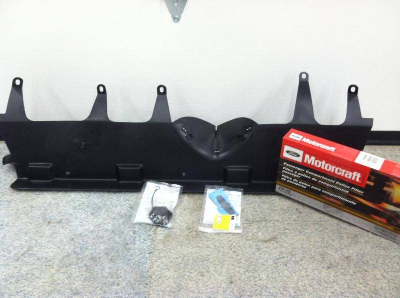

Here is a photo of the new parts I ordered a couple months ago. They have been since installed on the car. I will post pics when I get a chance.
New air deflector, cabin air filter, Lincoln emblem, power steering cap.

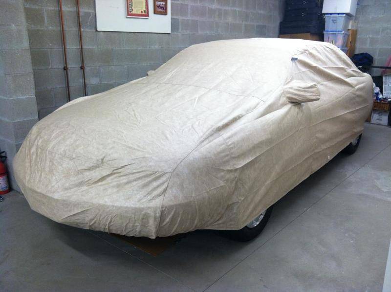

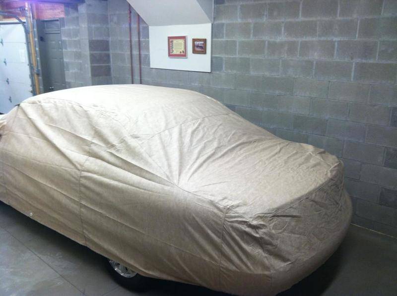

I bought a Cover Craft custom fit car cover when its sits for the winter. Those of you who are interested in this cover it is part #C15901TT Pics both front and rear of vehicle.
